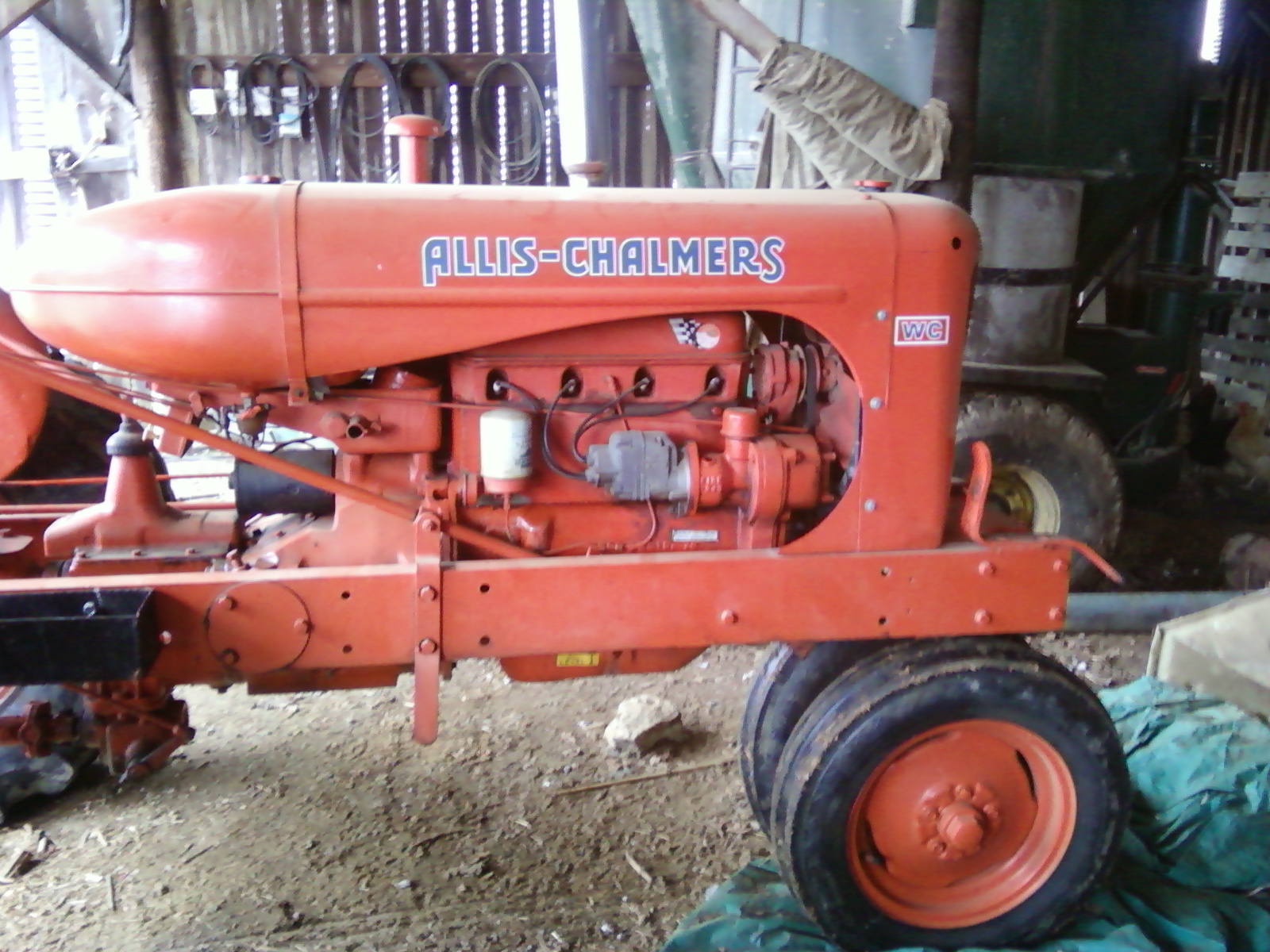

just bought a 1947 AC tractor no.wc167507 dont know much about tractors but thanks to the Ky Derby I won a lil extra cash and bought this one been overhauled now i need to figure out how to add a bush hog or belly mower and a plow no hydraulics though any ideas ? or pictures of what this unit may have looked like when original would be greatly appreciated id like to keep it up for shows but still work it a little

Welcome to the Forum! You are certainly in the right spot for advice on these great tractors.
Nice looking WC. One of AC's great success stories when it was introduced in 1933. You are right - no hydraulics! Are you talking about a dirt plow or a snow blade? Plenty of trail-behind plows were made for these girls. Brush hog - I'm not sure whether these are available in trail-behind models.  Hopefully some of your Kentucky orange enthusiasts will be able to lend some local advice on finding such toys.

First welcome to the forum. That is a pretty nice looking WC you have there. It looks pretty much original too except for the add on toolbox on the right side and the WC decals. Although Allis never put them on a WC a lot of people do when they repaint them. The flat spokes would have had steel rims with lugs instead of rubber tires on rims.  The only thing I see missing are the headlights. They mount on each side in the tube just under and ahead of the gas tank.
 One test showed 29.9 HP on the belt pulley for a styled WC. Here is the test data.
http://www.tractordata.com/farm-tractors/000/0/0/9-allis-chalmers-wc-tests.html
If the previous owner updated to WD45 or D17 crank you could get upwards of 45 to 50 HP easily out of her.  Charlie
Post Options Post Options   Thanks (0) Thanks(0)   Quote CTuckerNWIL Quote  Post ReplyReply Direct Link To This Post Posted: 03 May 2010 at 9:50pm
I guess I missed seeing the seat. That is an aftermarket "Monroe" seat. Probably a lot more comfortable to spend long days on.

thanks for the link interesting facts..I gave $1300.00 for it funny the link said that was about the cost new.. so are the spoke on rubber original? It has alot of pep to it bigger crank could have been possible..is it that simple just replace the crank= more hp? on the side i see some have a small pully can i put a hydraulic pump there? did they originally .like i said its my first she isnt going anywhere i miss my first car my first truck im a keeping this rider..i know its not show quality to the pros but id ride her in any show

The flat spokes never came from the factory with rims and rubber tires. Look at where the spokes meet the rim and you can see the weld. I believe most styled WC's that came with rubber had cast centers with a steel galvanized rim. In 47 tires may still have been hard to come by because of the war, so flat spoked steel wheels were used.
 To keep the compression ratio somewhere near normal the pistons would be changed along with the longer stroked crank. You could easily have minor changes made to your engine that would give it more power without changing the crank.
 WC's never had hydraulics from the factory. Adding hydraulics to a WC has been done in several ways. The belt pulley isn't the best place because it stops when you push the clutch in. You can add a live pump between the magneto and the governor housing, if you can find the pump. Many were used on M Farmalls to make live power. A front mount pump can be done and look pretty clean if you add a brush guard around it. There are PTO pumps out there that have the reservoir built in. The PTO pump would not be live either.
 There are trip plows out there available. No need for  hydraulics. You can by used trailer type bush hog mowers pretty reasonable too and put a manual jack on them to hold the cut height you want. A Woods L306 belly mower would make a good addition if you want a lawn mower and hand lifts are available for them. The Woods mowers are finish mowers and won't handle brush well at all. A bush hog type will handle heavier junk but not finish like a lawn mower.
