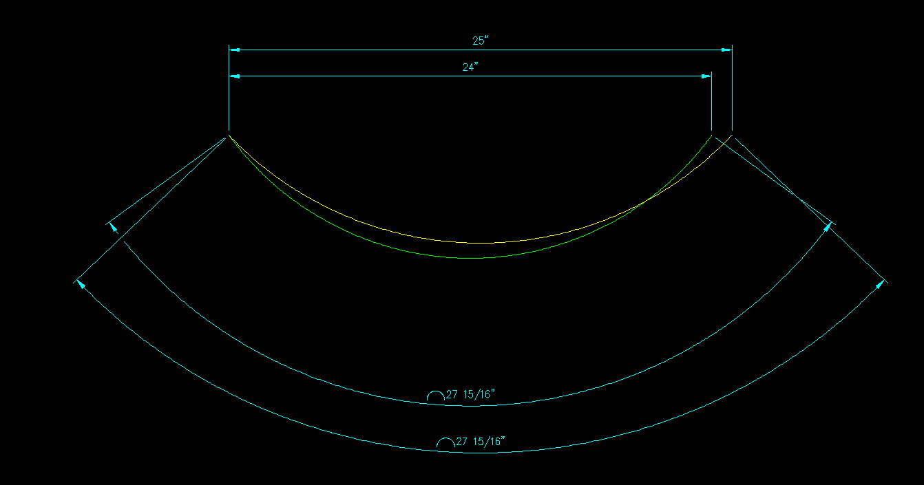

One of the needles probably got bent into a little wider of a radius when it hit something. Not uncommon for this to happen. At least Allis used steel rather than aluminum needles, so you should be able to carefully heat and bend the long one back into shape by tightening the radius and making it match the other. Lots of balers out there have had this happen.
In the picture below you can see, for instance, how both curves have the same overall length (27 15/16"), but because the green one's bent into a slightly tighter radius, it only measure 24" point-to-point, versus the yellow one which is 25".

Never thought of that,I will check that out and see if I can heat and reshape that one. Thanks for the advice

Kind of a risky thing to do, but I'd remove them both and lay one on top of the other to SEE what the difference really is instead of guessing.

Many other manufacturers (like many NH models) used cast needles, others use aluminum. These typically break rather than bend. I'm assuming the 444 is similar to the 442, however, which uses formed/stamped steel needles, which I like better as they're stronger and more ductile (less brittle and likely to crack), and can also be welded easier if they break.
I'd try tripping the knotter manually rolling the baler over watching the needles deliver twine to the cam discs. As Ray54 mentioned, as long as they deliver the twine in-line with the grooves in the discs (and as long as the groves in the discs are aligned), you should be ok.

That’s exactly what I did and how I found out the left needle was different because it would come up around 4” above the twine disc and only once in a great while it would grab the twine. Where as the right side needle was barely above the disc and would grab it every time. No matter how you tried to adjust the left needle you could never get it close enough. That’s when I started measuring and found an inch difference. Now that I’ve read all the comments on the forum I bet the left side is bent and you can’t see it. Manuals are great but the knowledge on this site definitely prevails.
