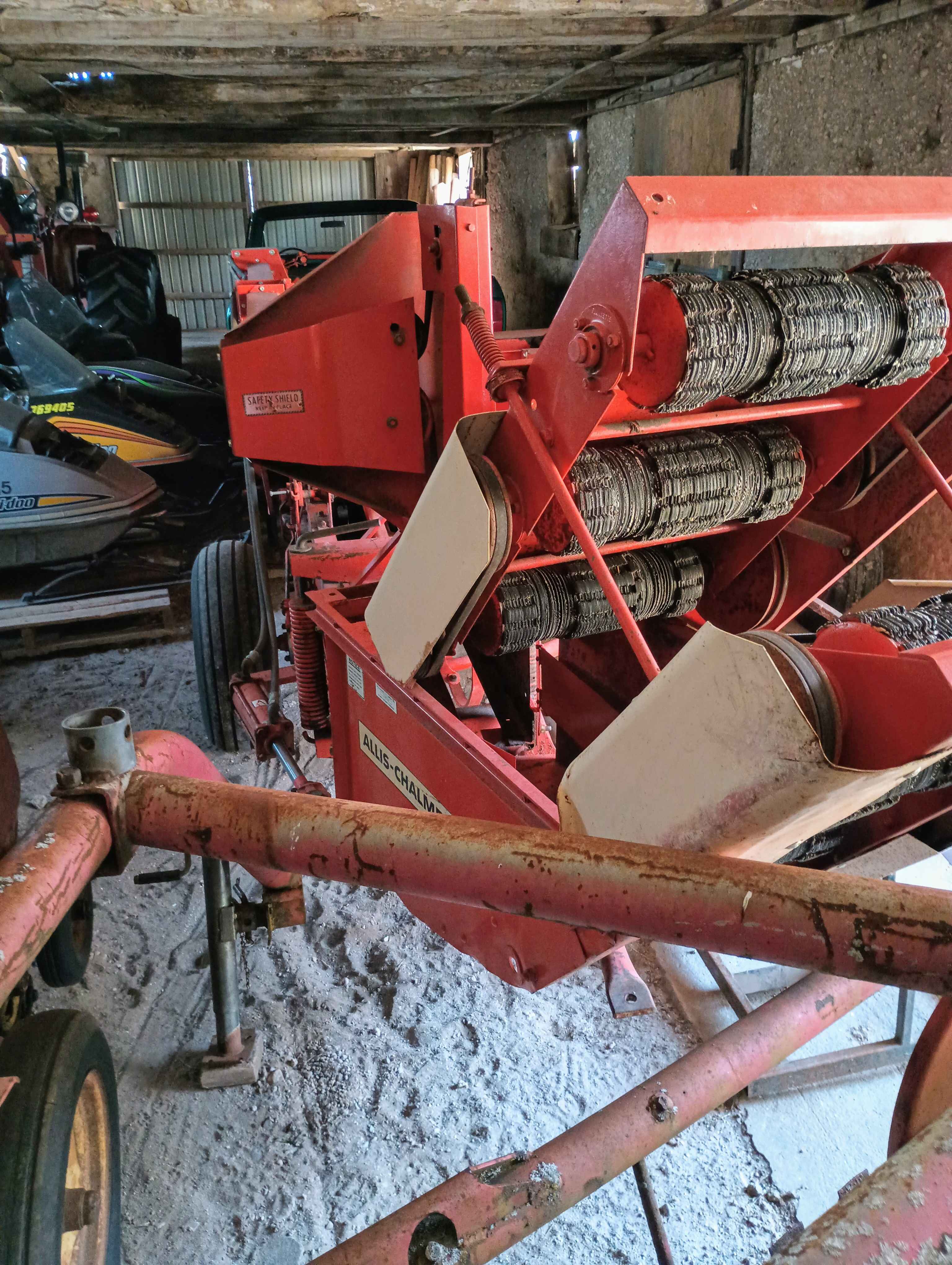

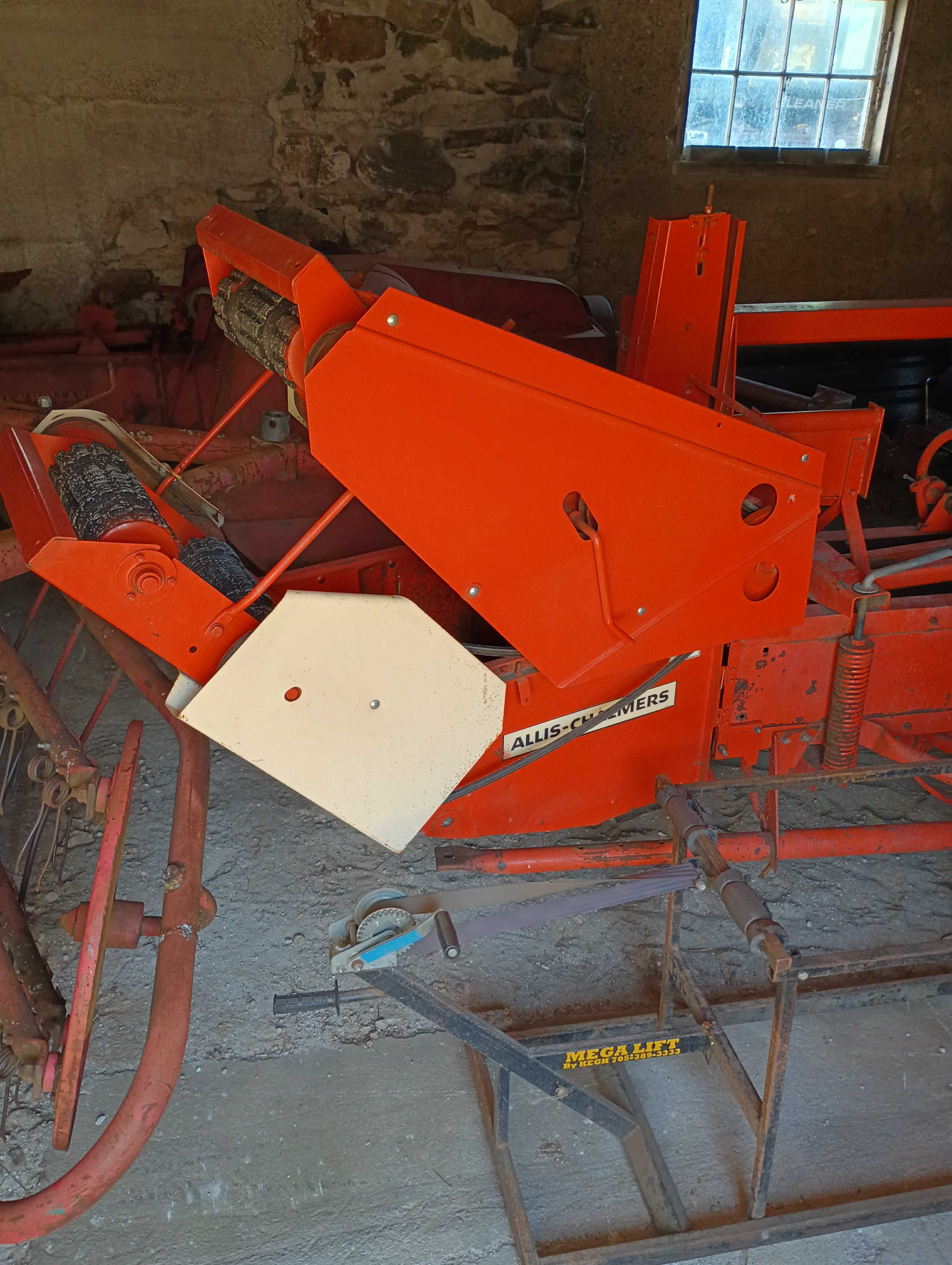

Hi all, recently bought a 443 baler with thrower but have never seen a thrower like this, anyone know what I have? First I thought was it's missing the belts but it looks like it's designed that way. Owner said it was a transplant from another baler.
Matt

Looks like the one on my 303

That is a # 20 thrower used on 303 and some 444

International also used that style rollers

Fantastic, thanks for the replies.
never got a chance to run it yet, I'm going to pull the plunger and R&R the knives and bearings first.

In my opinion, the belt throwers worked a lot better than the roll type. I believe the correct thrower for the 443/444 was a 44 thrower.
