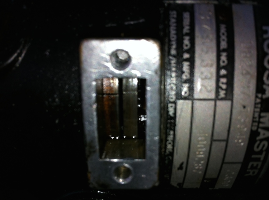

Post Options Post Options   Thanks (0) Thanks(0)   Quote AC7060IL Quote  Post ReplyReply Direct Link To This Post Posted: 21 Jul 2015 at 3:49pm
Injection pump's timing view window with marks lined up
looking thru the Injection pump front plate inspection hole.  Is this correct?  With the Injection Pump's timing marks lined up, the timing punch mark is visible at this position.  Does this need to match up with the idler gear at a specific position also?
I found the crankshaft pulley timing marks and they read 15 degrees.  Book calls for 18 degrees.

Post Options Post Options   Thanks (0) Thanks(0)   Quote injpumpEd Quote  Post ReplyReply Direct Link To This Post Posted: 21 Jul 2015 at 5:15pm
looks like you found the pump marks. lol! The punch mark is not as important in my opinion, since the main concern is that the crank pulley is where it needs to be, and the lines in the pump lined up. The problem can come along if the front pulley has slipped. Being it's at 15, I'd say it's ok. It is common to see them lose a couple degrees over time. That is why I like to suggest people actually timing it when re-installing a pump, instead of simply marking the housing, and putting it back exactly as it was.

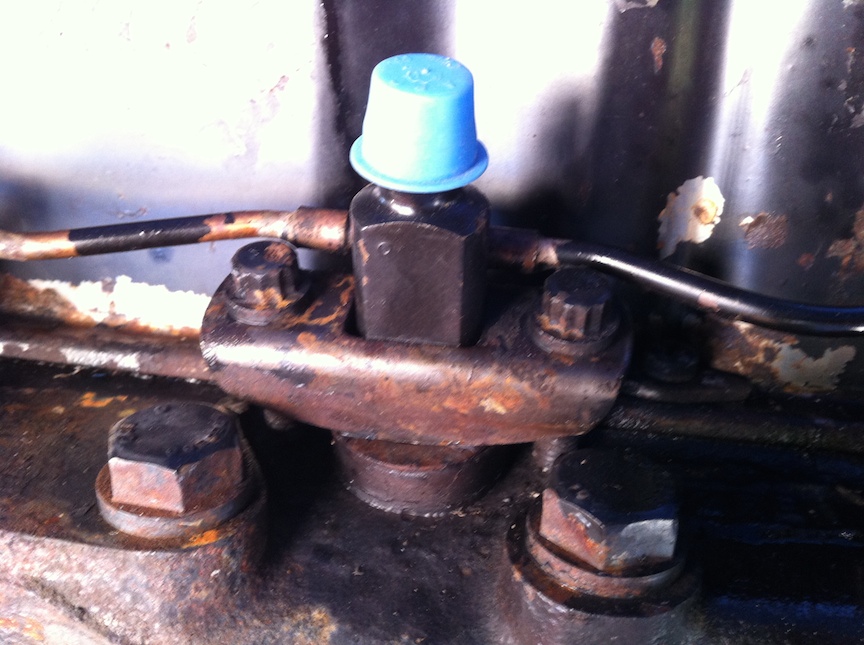

Very much so about the injectors. The same fuel that is gummed up in the pump also has the moving parts of the injector gummed up. Doing only a pump repair in this instance, could cause the pump to seize. The pump will now be pumping fuel, but with the injectors all stuck closed, the fuel has now where to go, putting extra stress on the pump, and possibly seizing it up. Normally the injectors can be torn down and cleaned and re-assembled and adjusted, but I've seen several instances where the nozzles were just too pitted to save.

well, the lines are already off. Take the return line off the sides of the injectors. Take the 2 bolts out of each injector hold down. Now, they are sometimes rusted in there. If they don't come out by pulling by hand, stop and drain coolant. Then fab up a slide hammer to screw on the inlet, it's 9/16 -18 (fine thread) and pull them out with some force. Reason for draining coolant, is if you get forceful and a copper tube comes out with the injector, it won't fill the cylinder. Soak a good penetrating oil around them as well. Make note of which side the return line is on, since it very much matters on the spray pattern. The straight (bosch or american bosch) injectors are hard to get a hold of. Good luck, I hope they come out easy!

Post Options Post Options   Thanks (0) Thanks(0)   Quote AC7060IL Quote  Post ReplyReply Direct Link To This Post Posted: 22 Jul 2015 at 7:53am
Here is a picture of one of the injectors on this black 433I engine 33-10877.
Sounds like I will be fabricating an injector puller.  Anyone on this site have pictures of injector pullers that you have fabricated?

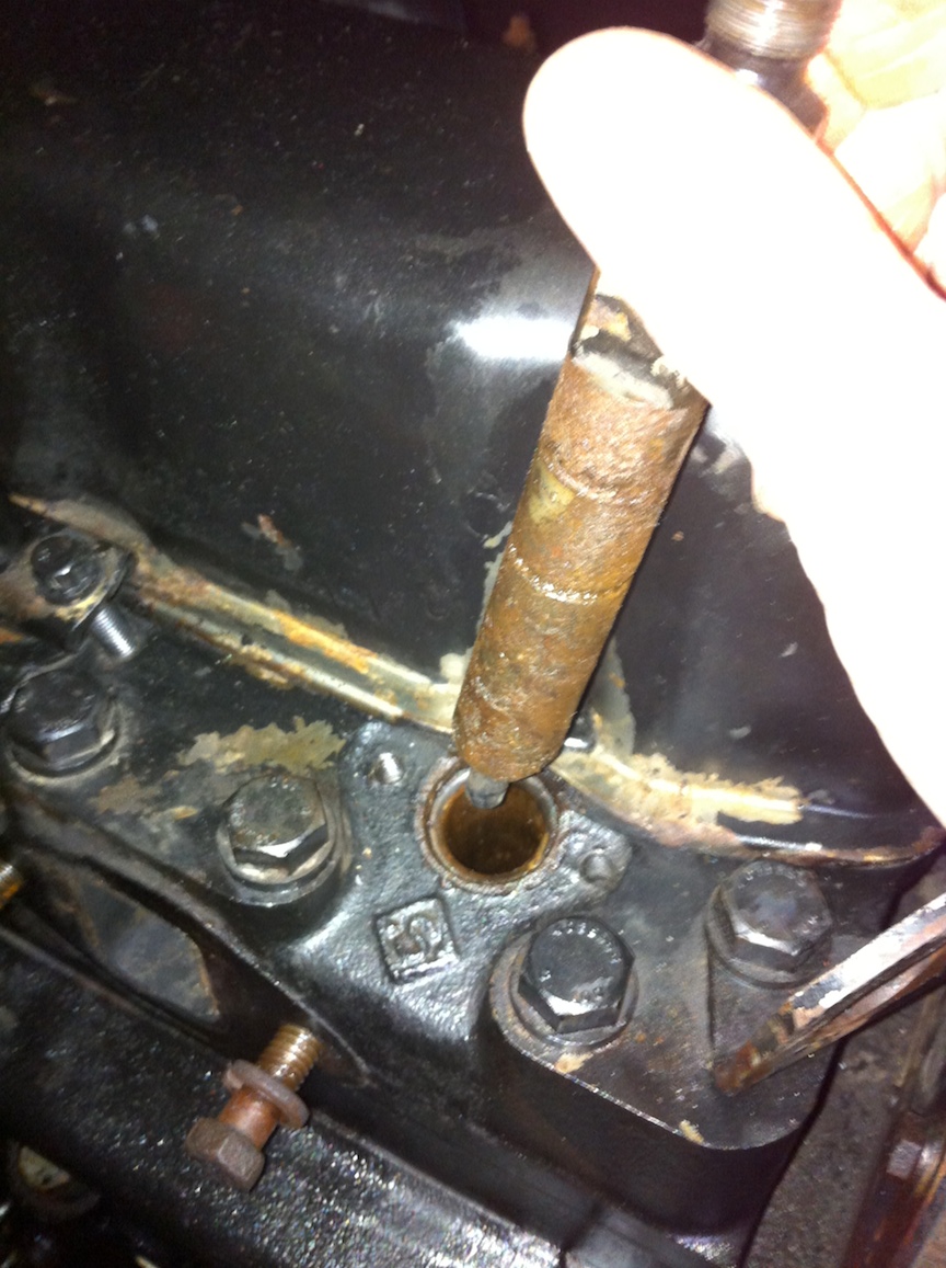

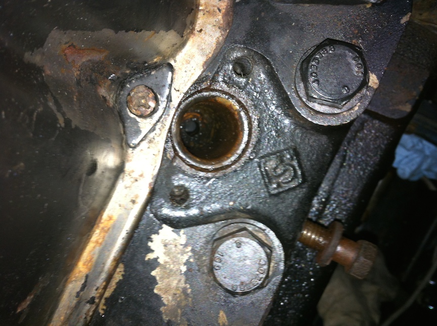

Post Options Post Options   Thanks (0) Thanks(0)   Quote AC7060IL Quote  Post ReplyReply Direct Link To This Post Posted: 23 Jul 2015 at 5:52am
I got #1 injector pulled.  Maybe it's condition looks typical?  I was amazed at the gunk & rust on it. Is this corrosion an indication that the sleeve may have been leaking coolant or do these just have condensation from their own heat?
Here is a picture looking down inside the injector's sleeve.  There is lots of corrosion on it.  What procedure do I use to clean this up?  Can these be pulled straight out for cleaning? Do they have any gaskets attached to them?

Post Options Post Options   Thanks (0) Thanks(0)   Quote Lynn Marshall Quote  Post ReplyReply Direct Link To This Post Posted: 23 Jul 2015 at 6:53am
Somewhat typical. Do not disturb the copper tube or you will be pulling the cylinder head. Clean the tube with a rag and gas, brake clean, solvent, or whatever you have. Blow out the hole, and hope for the best.

Post Options Post Options   Thanks (0) Thanks(0)   Quote MACK Quote  Post ReplyReply Direct Link To This Post Posted: 05 Aug 2018 at 8:39pm
Drop a short 1/4" screw into injector hole with head up. Use a 12 gauge shotgun brush to clean hole. With a screwdriver hold the screw down while blowing the crap out of hole. Use a magnet to remove screws.    MACK
