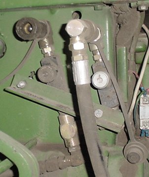

I have a Long 1099. It came with a PTO pump that was rated at 20 gpm, made control the the hoe difficult because it moved too fast at full valve. After that leaky pump was filched one winter I mounted a 5 gpm pump on the front of the engine crankshaft and operation was much nicer. Later I added ports with a flow restriction valve for loader and back hoe to my 4020. On either tractor its important to run a chain to anchor the back hoe on the three point down to the drawbar because its hard to dig without the tractor weight to hold the backhoe down. The three point only holds it up, but will let it rise rapidly.
On the 4020 I plumbed the added hydraulic manifold with a female connector for pressure and a male connector for return so there's no question which goes where and when not in use the two ends on the back hoe are connected to stay clean. This picture only shows the pressure side. I had to change the valves on the back hoe to closed center to work with the 4020.
