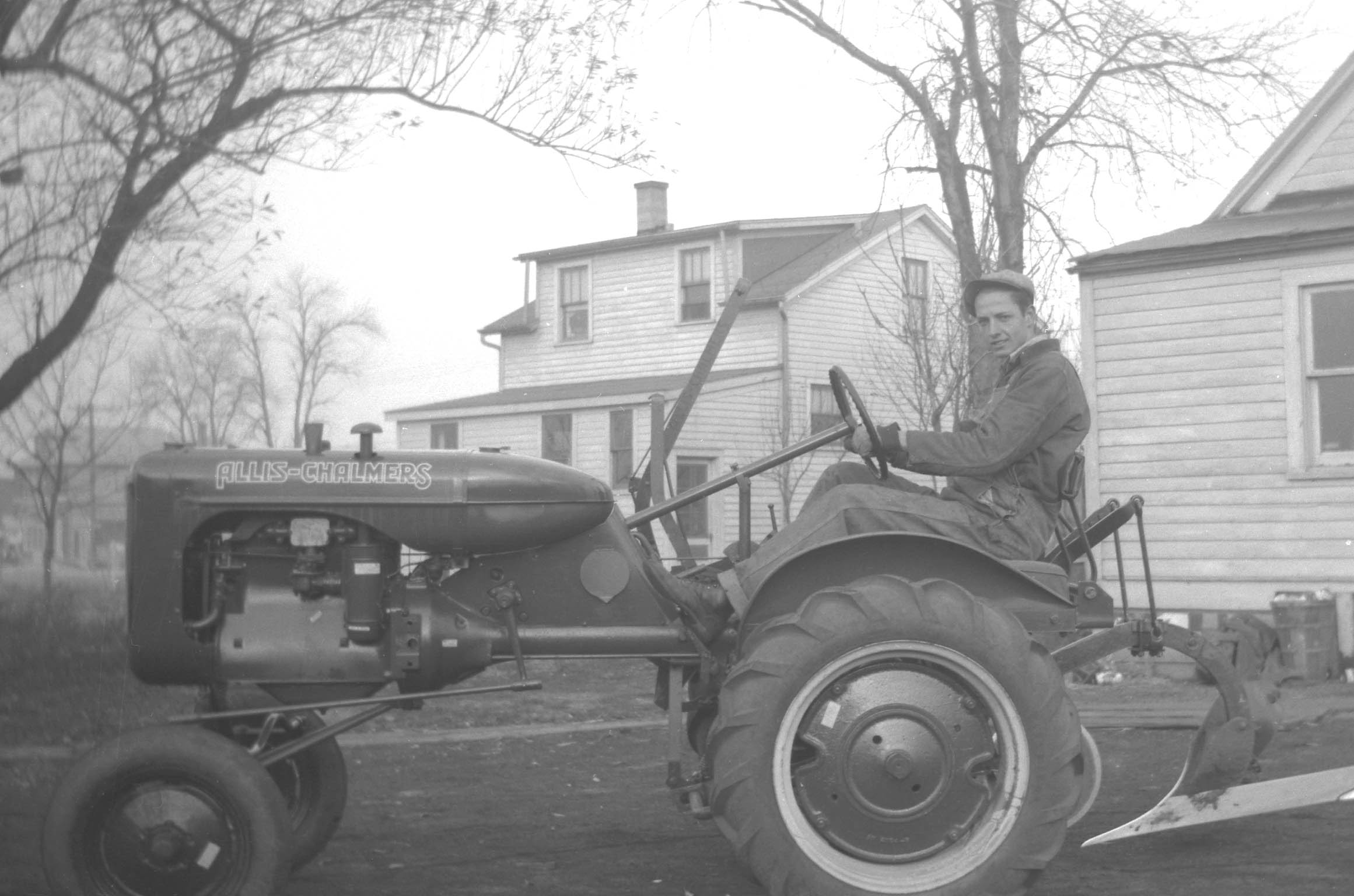

Here is a good B&W photograph of My Family's First AGGEN FARM Allis B. Bought NEW in 1939. See the rear rims are not painted the same PO#1 as the tractor. They look gray because they are GALVANIZED.
Photo was taken by my Grandmother at 3837 West 111th St , Chicago, Illinois.
Also see the seat is covered in Canvas Duck Cloth. Black Vinyl Seat fabric is not a correct original replacement.

As I was rambling I forgot thanks Ken, and galvanized it will be.

Ken, looks like it has some sort of back cushion too. Is that factory?

Almost looks like a rubber inner tube wrapped around the seat back. I know stitting against a JD seat back is not too comfy while bouncing around in a field.
