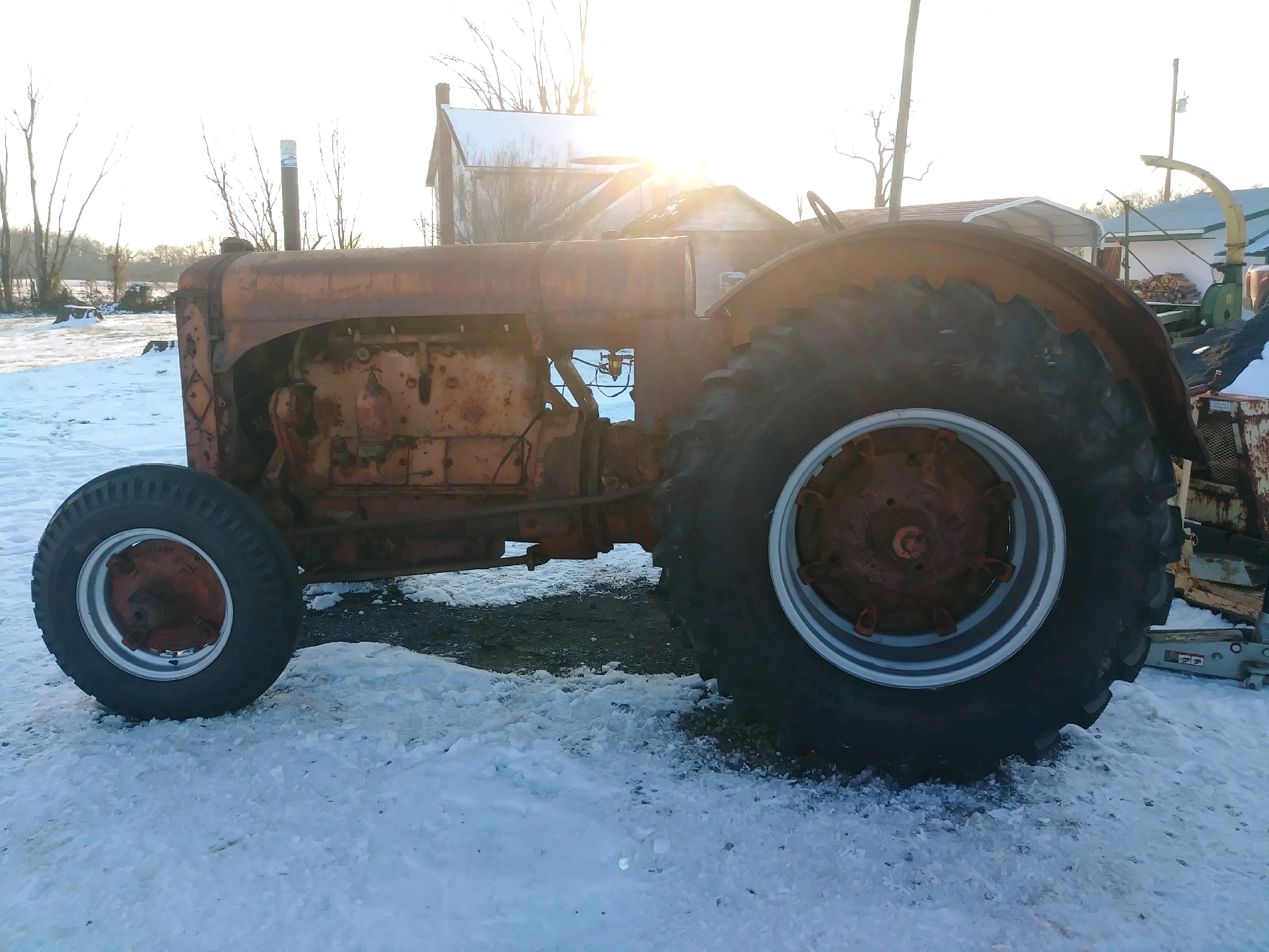

How much work or money do you want to spend? My opinion is As look like crap on OEM sized tires and even worse on the modern replacements for that OEM size, but thats me If you want to keep the OEM rims and not spend much for tires your stuck with 14.9-28s and tires that are all sucked in at the the beads and look like they belong on a 25HP tractor. Or you can widen the rims a little bit and up size to 16.9 and the tires are still too small for a good looking outfit (in my slightly opinionated opinion)  The only way to make an A look right is on the old 15-28 tire which is 18.4-28 today.  The pic is of my A on  old 15-28s with about 4" put in the rims.  A modern 18.4-28 requires a LOT more in the rims to get same look as different tire construction requires different rim width.  18.4- 28s are also very hard to find.  Another option is to go with 18.4-30 and weld a spacer to the drop center so it fits the wheel. They look real nice on a A.

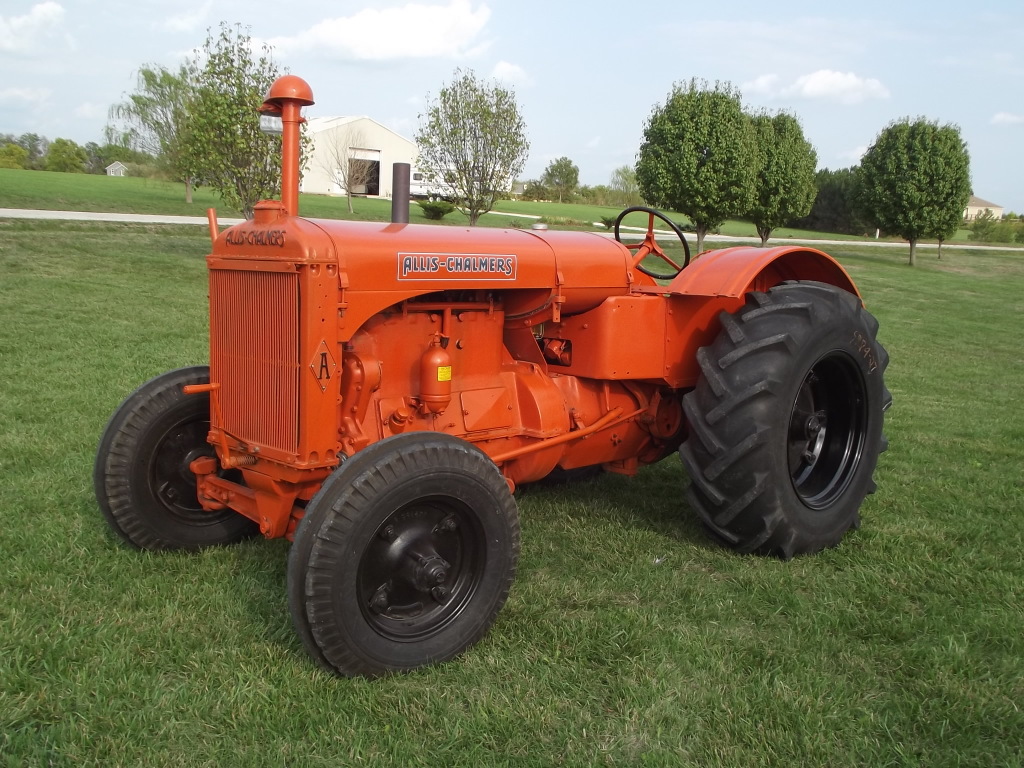

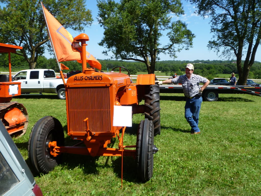

Here's the A with 14.9's, same tractor with 16.9's.  The 14.9's fit in the furrow better but I just couldn't stand the look, it deserved the bigger footprint!

I.M.H.O. The A with the wider tires look like the D21's Great Grandad.

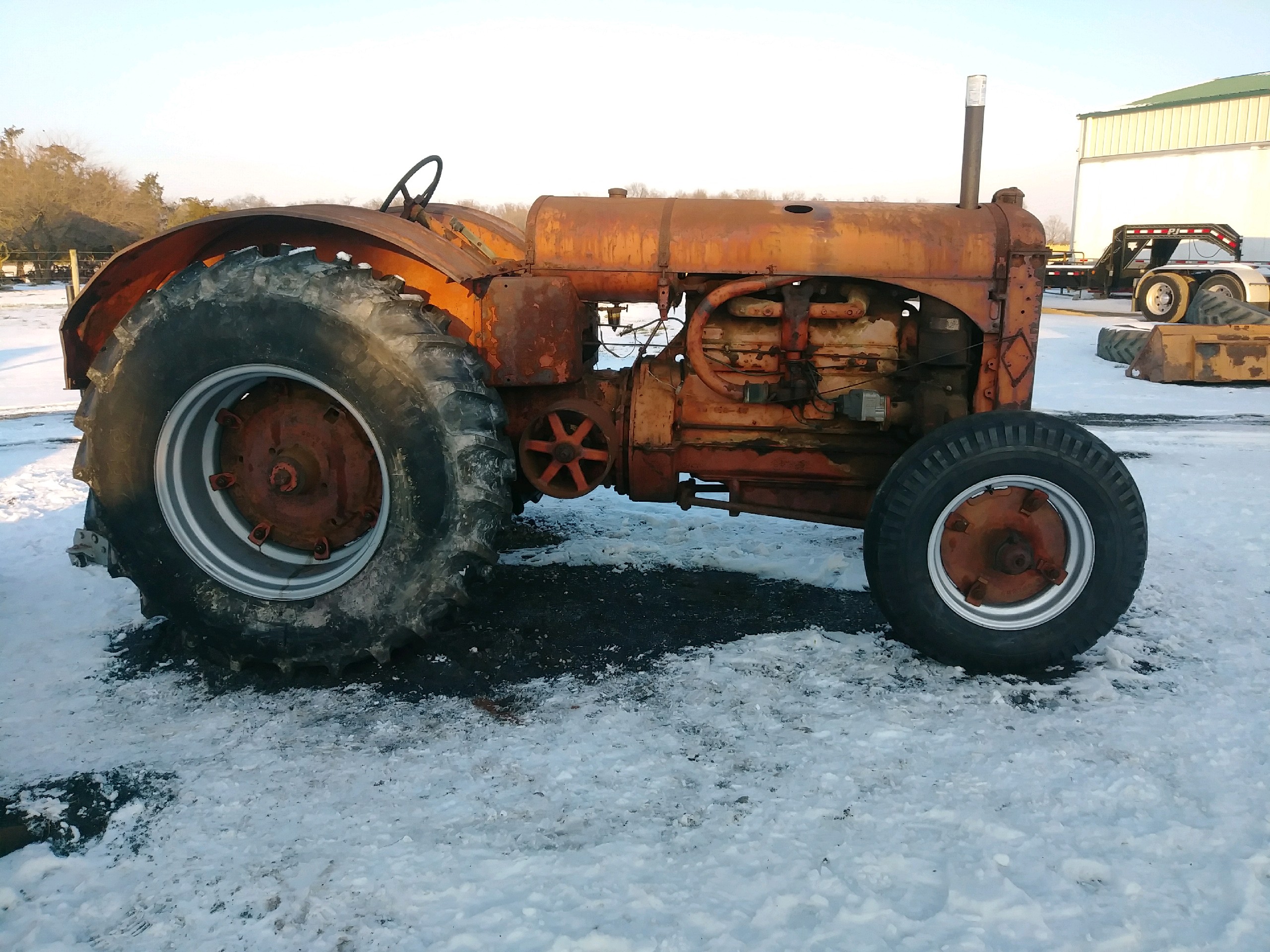

Here is a picture of my A before it gets the new tires mounted.

Not a bad looking A to start out with .

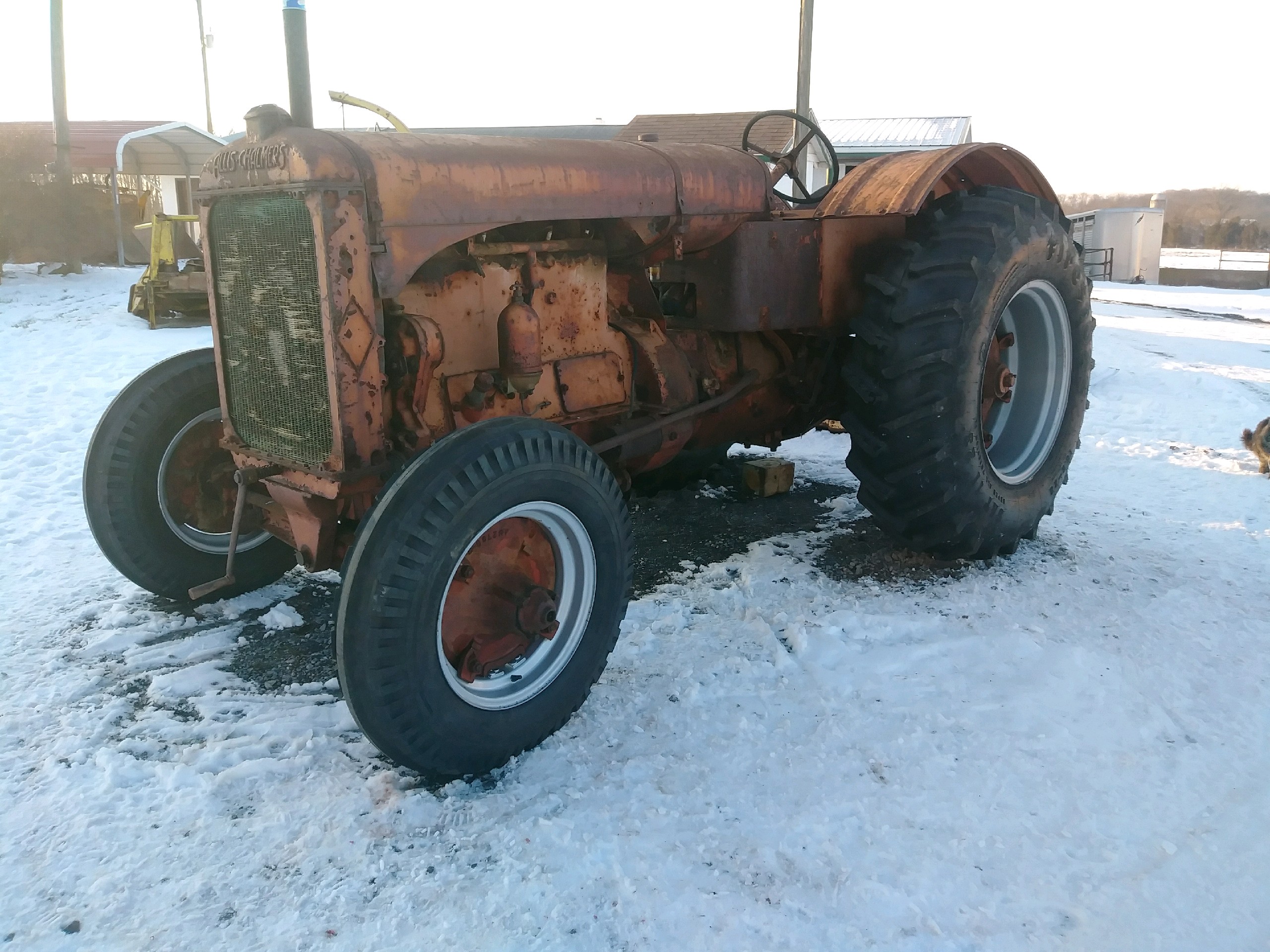

Post Options Post Options   Thanks (0) Thanks(0)   Quote ZachD89 Quote  Post ReplyReply Direct Link To This Post Posted: 15 Jan 2019 at 5:56pm
Here are pictures of my A with the new rims and tires. The 16.9 tires turned out good and looks good.

Looks good.
