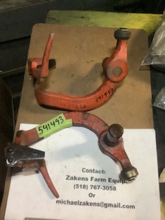

If it comes down to it. We have whole arm with roller on it.
Maybe some would know, but see many different numbers in parts books. 6 notch and 4 notch knotters
