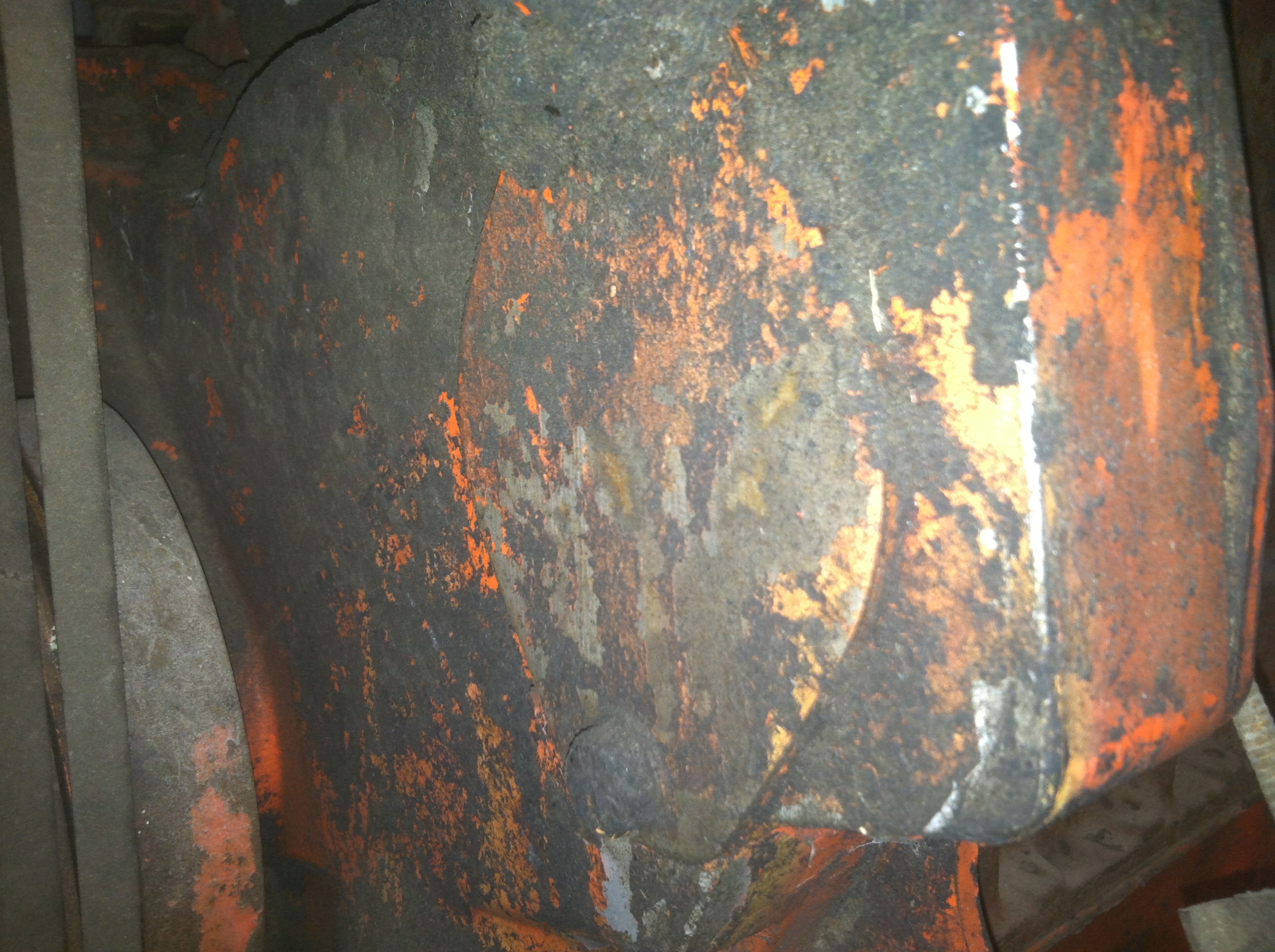

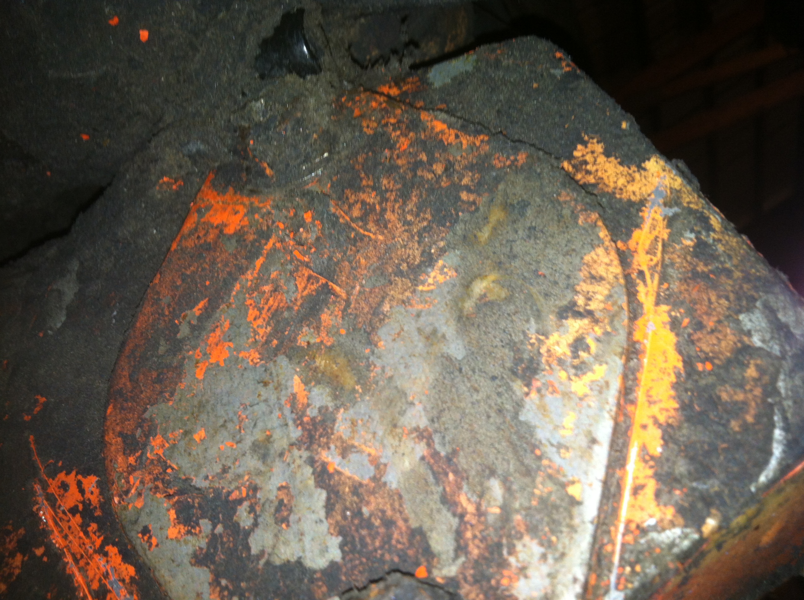

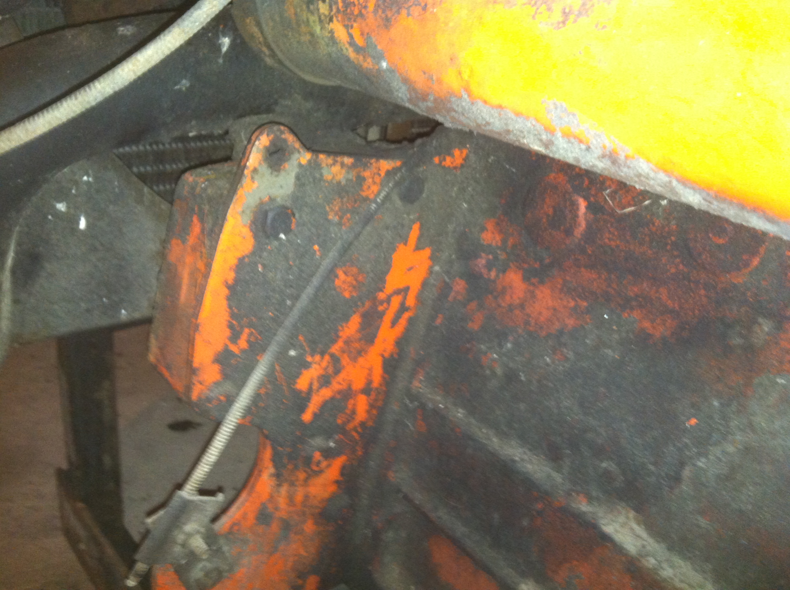

here are the pictures he sent me of the fron cover where my hyd pump is. the plate with 2 bolts on the front side looks identical to my 190. the back side looks bare , but with 4 bolts in about the same location as the mounting bolts of my pump. i am not to worried about the oil pan clearance. i can modify this 1 or fabricate my own, or if it is easy enough and cheap i would get the correct one. thanks for the input guys

ok, i kinda got it now

Minnimec pumps use the same front plate as the later roosamaster like whats on the 7000 series. Get a front plate from a "7000" and put in on the front and she will bolt right in.

yea looks like there should be room for the pump. so i just need the front plate from a 7000 and the pump should bolt right on. thanks for all the info guys. here is a video of the engine running. it does need an exhaust manifold gasket.
