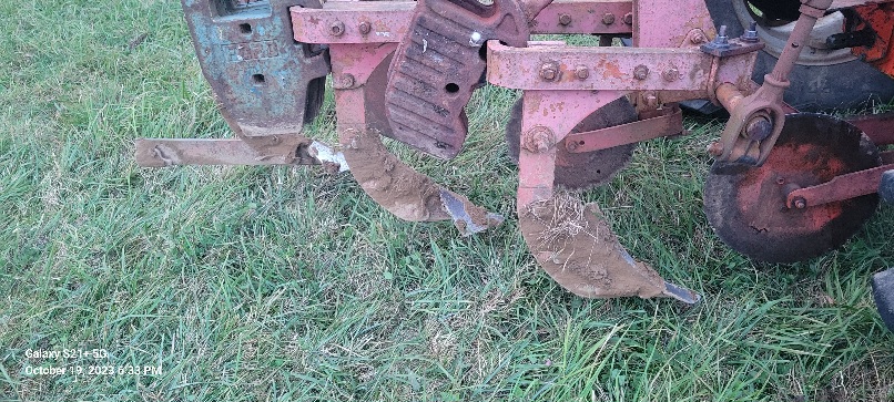

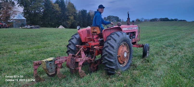

Enjoy and criticize as you wish.
Still have a few more adjustments/modifications to make.
Ph is 6.5 but no noticeable difference in production last year as compared to un-limed adjacent ground.
Not ready to plow this ground but gonna experiment with this 3 row sub soiler.

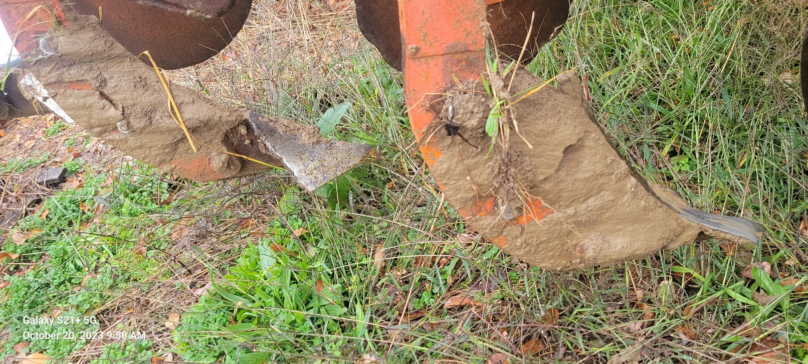

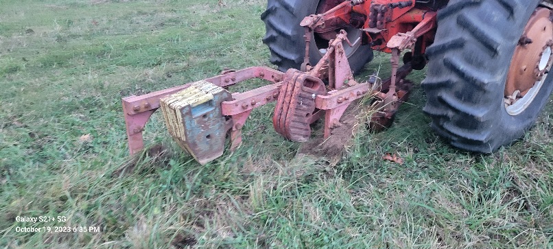

As it sits it still turns up a clump of ground "to" often.
Gonna install larger culters and align them precisely with plow beam.... and take the blunt edge off the plow beam.
ENJOY

Does the plow pull straight ?? I'd think it could want to drift/pull off to the left with no landsides ??

The Tye company (if I remember right) made kits to convert plows into rippers.  don't know how well they worked.

Oliver sold a sub-soiler attachment for some of their plows, I have only seen pictures. Pretty sure they skipped every other bottom.
Interesting idea, keep us posted how it works. How deep can you get it into the ground?

I'm having a similar experience with the curved shank sub-soiler I bought last year. Just want to open up a groove in the ground, but she lays over a clump & a slight mound where it goes through the ground. Don't want to disturb the ground cause it's pasture land. keith so. va.
