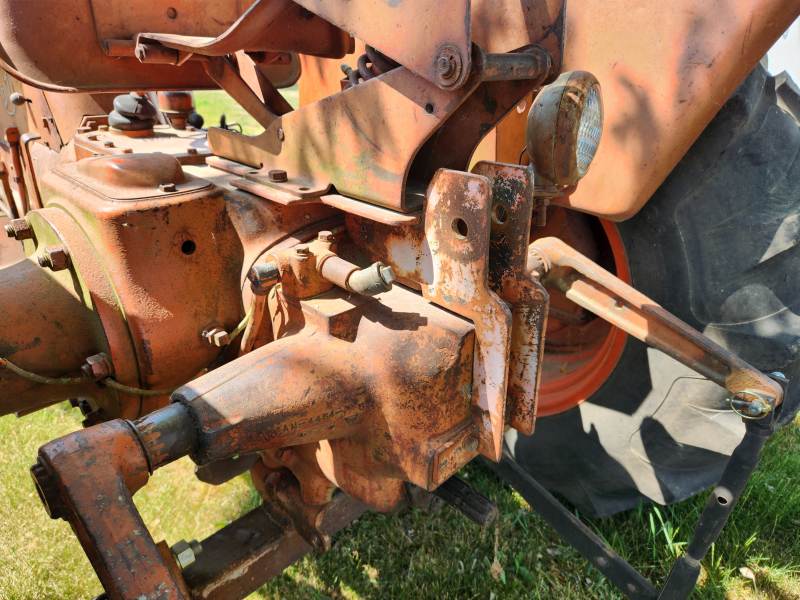

Here's a horror story for you...
This one, like most others, has a plate that sandwiches between the seat and transmission... and two bolts low on back over the PTO.
I've used a rear mounted rotary mower, a 14ft disk, a pair of forks (with very heavy stuff on it), a hoisting boom, a back blade, a box scraper, a trailer-hitch/chain yoke, a log skidding yoke... a post hole digger, a single-point ripper...
I've pulled, pushed, twisted, yanked, jerked dragged, lifted...
I've bent the lift arms, twisted the top link, had the front end of the tractor off the ground...
and the darned thing has never broken... or come loose, or sheared a bolt... and for some reason, the lousy paint job I gave it, is still mostly there.
So if you build it like this one, it will likely work as well.

Okay, well, here's a pic of it from long ago...

There it is!

Post Options Post Options   Thanks (0) Thanks(0)   Quote Kruger Quote  Post ReplyReply Direct Link To This Post Posted: 12 Jun 2023 at 4:57pm
Hey guys attaching the wishbone type conversion kit. It has a chain for sway control, but not sure how it works or gets connected. Any info, thanks.
