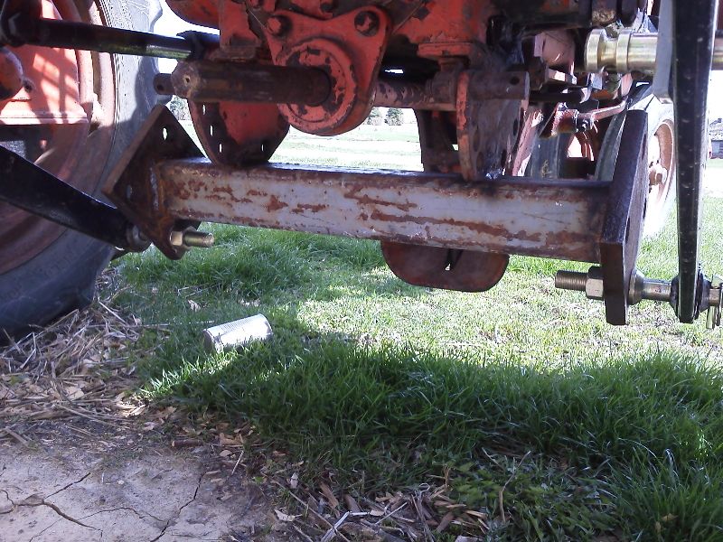

I made mine... used lift arms and links from Farm & Fleet...

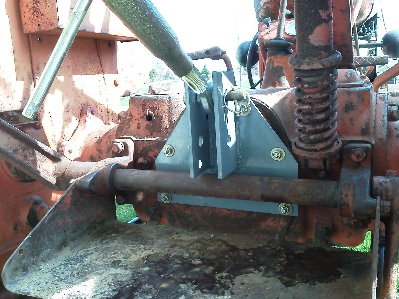

Here's where I put the top link... Usually, guys use a strap to the rockshaft...

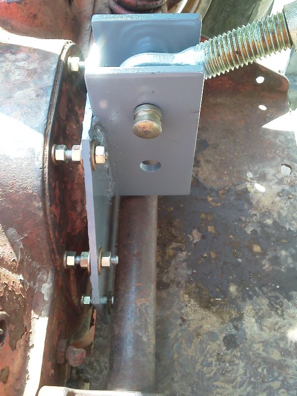

Here's how I fastened it:

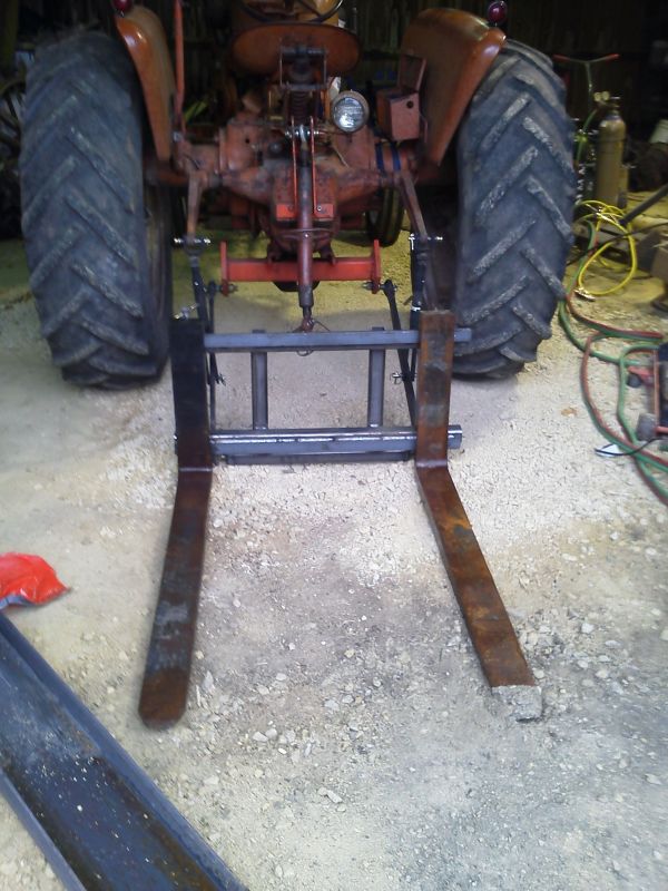

And here's the one I made for my D17:
