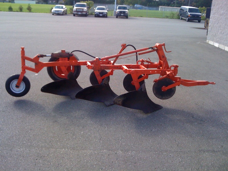

i found a 3 bottom ac snap coupler plow it is restored it has at trail wheel with a cylinder on back i can not find another like it online.. i forgot to take apic.. just looking for some info thanks

Hard to say without a picture. Go to knowledge base section in this forum and there's a topic about plow parts, has a good description of the different models of plows.

My guess is a # 73.  Others will correct, if I miss...Wink

is it worth 400.00

Dave is correct, I believe. That's a great looking plow, though the shares look like they may be worn pretty good. This a problem area for Allis plows. If you're going to plow with it this a concern. If you want it for parade duty not so much.
Around here that plow would fetch pretty good coin. $500 or even more at auction depending on the crowd.
I picked one like it up this fall, paint isn't quite that good! Mine needs a little work, may take it to a plow-day sometime.

If you want to plow with it, and have it work right, your tractor needs to have a transport valve for the remote cylinder lift.

If it's as good as it looks, 500 seems a good price..
but..
I gotta ask...curious am I...
is there a control for the BIG car tire to go up/down ?

Isn't the Big Car Tire a sort of 'depth control' and not meant to move.

No control for the big car tire. That is your depth control partially at least. Can adjust manually and when you find your sweet spot leave it there. 😀

That's a 73 semi-mount frame.
How are the wear parts like the shin molboard and landslides?
You can't tell what bottoms are on it form the picture.
The 387 bottoms are the only bottoms with shares still available except for a few NOS laying around. I never saw 387's on a plow that old. I think My plow has 372 or 373 bottoms. I redrilled the frog to accept 387 shares then bought a lifetime supply.
