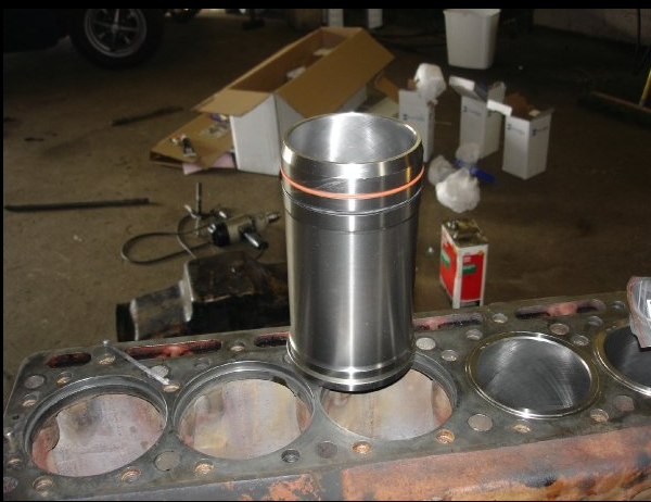

2 o rings, orange on bottom, black on top.  Probably had 2, but the other one deteriorated and broke apart.  I think my sleeves had 2 rings of leak stop when I took my engine apart to rebuild it...

Post Options Post Options   Thanks (0) Thanks(0)   Quote Hurst Quote  Post ReplyReply Direct Link To This Post Posted: 21 Feb 2011 at 7:06pm
Here's a picture of a  new sleeve, note that it is upside down in the picture:
