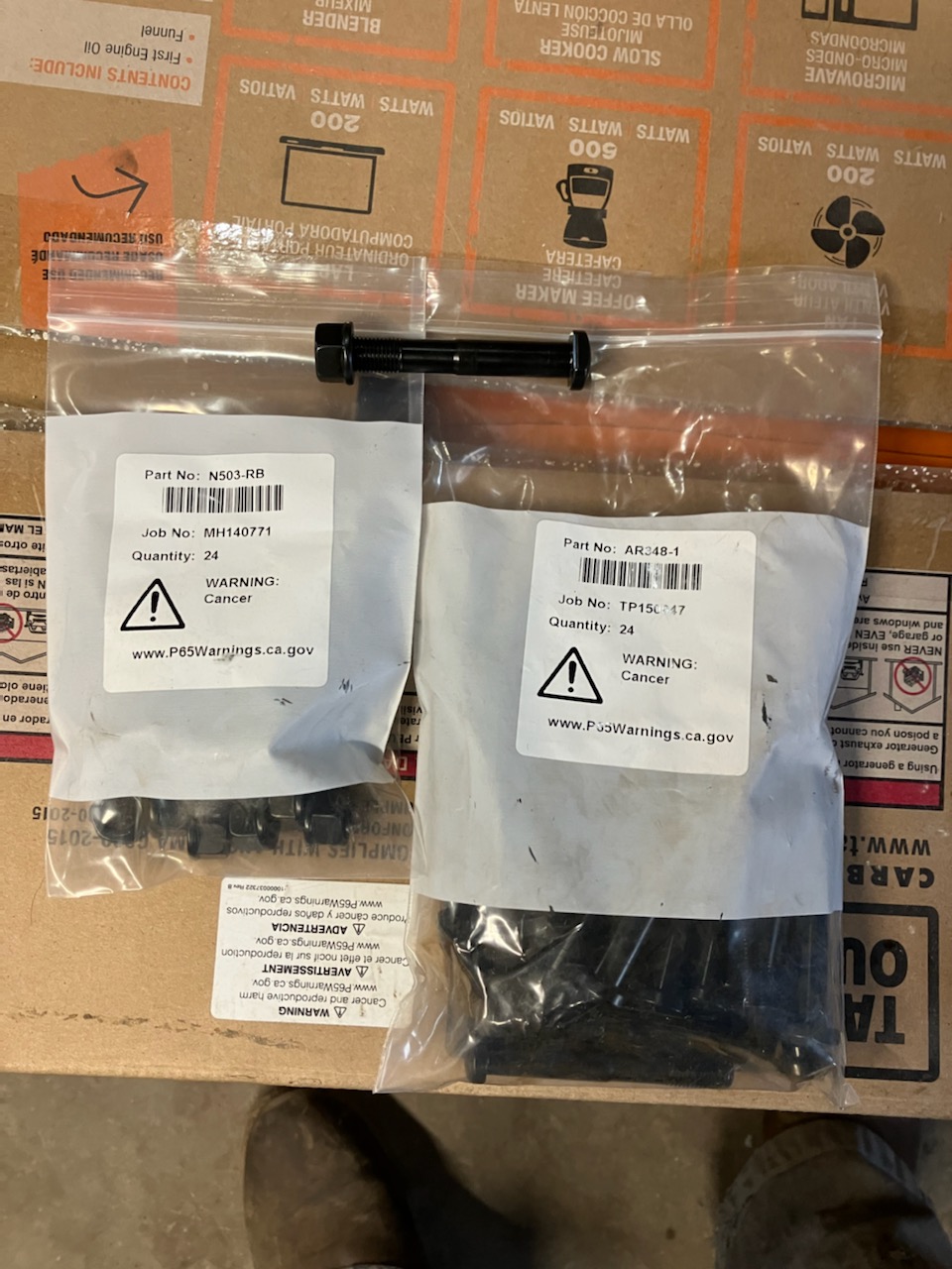

Hudco, any chance you’ve received your new ARP rod bolts and could share the part number?
HudCo View Drop Down
Joined: 29 Jan 2013
Location: Plymouth Utah
Points: 4042
Post Options Post Options   Thanks (0) Thanks(0)   Quote HudCo Quote  Post ReplyReply Direct Link To This Post Posted: 1 hour 58 minutes ago at 9:45am
sorry it took so long i have had them here for a week

Great, thanks!
