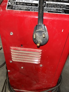

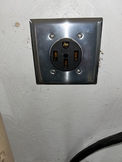

Well…. problems. My outlet for the heater is 4 prongs, the welder cord is 3 prongs.
My plan is to get a 4 prong appliance/oven/range cord and add a 3 prong plugin to make short extension cord/adaptor. Will this work? I see RV cord adaptors but none have the 3 prong style female end that matches the welder.
If this will work, the range cord has 4 wires- red, black, white, green. Which 3 do I use and what location on the female plug for the welder do I hook them to?

If I’m not mistaken,
4 prong 220 is two hots, one neutral, one ground.
3 prong 220 is two hots, one neutral.
Don’t take my advise, I am not an electrician, nor did stay last nite in a Holiday Inn.

Both are 50A, plug, and receptacle. The plug is a 6-50R, the receptacle is a 14-50R. Both are NEMA number systems.The plug shown is 250VAC only. The receptacle can supply both 250VAC, or 125VAC as per NEMA code. In reality the ratings are higher than what is supplied. 240/120VAC is common in USA.

Yes, it will work to make a short extension cord. Use the red and black for the two flat blade hot legs and the white for neutral on the round prong hole of the three pole receptacle. Cut the green back and tape it up so it can't contact any of the others.
