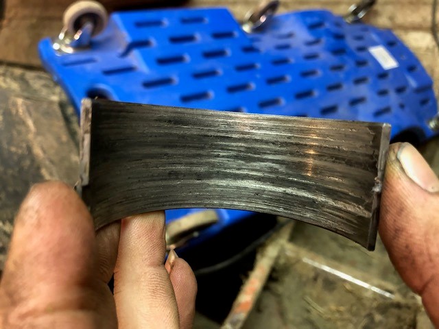

Post Options Post Options   Thanks (0) Thanks(0)   Quote ebowman Quote  Post ReplyReply Direct Link To This Post Posted: 11 Jan 2019 at 6:49am
Sooo, I am confused. I have a 2900 in a 190XTD that had water getting into the oil. Tore it apart and found this scored crank bearing where the water was leaking. The crank is not "smooth" and I was going to have it reground. Are you saying don't waste my time resurfacing it? Just replace it? I'm guessing .010 would take care of it. I know its not a 3500 or 3700 but don't want to break the crank later either.
