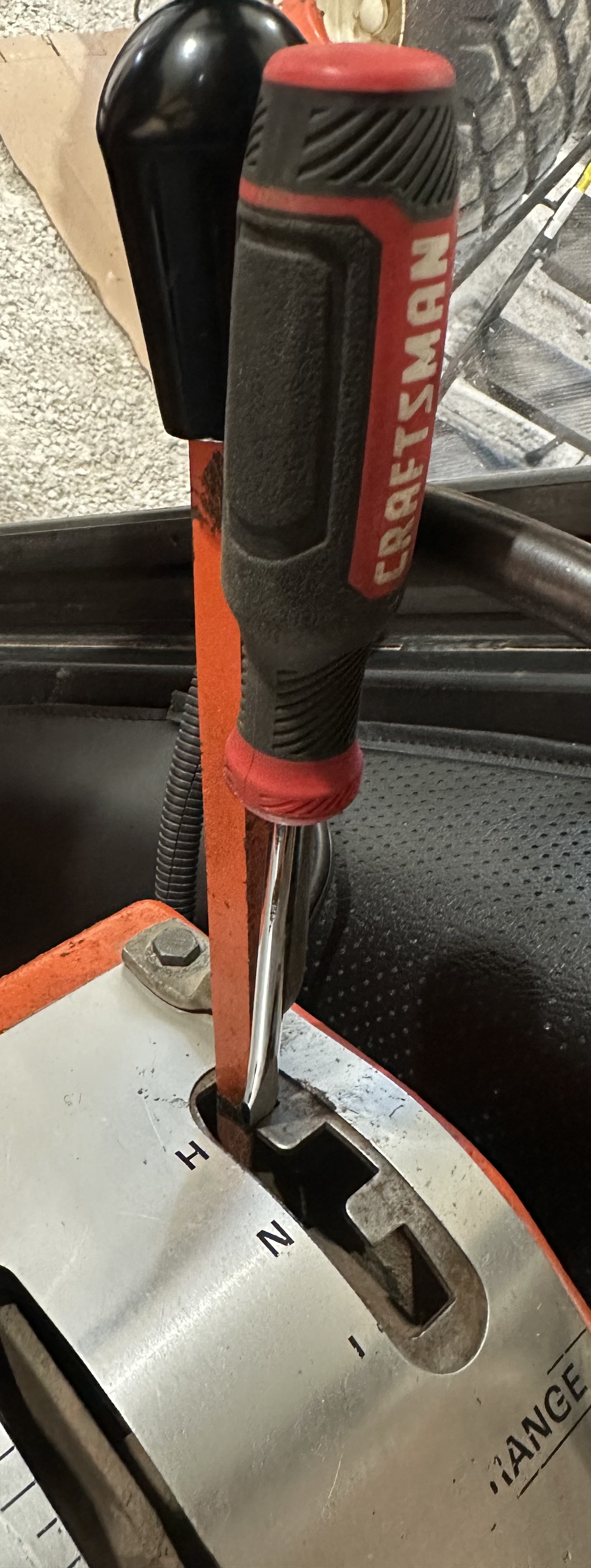

Our 200 slips on high side. We found if you put the tip of a flat head screwdriver between the gate on the selector and the handle it does not slip and holds gear fine even while pulling. We did replace the gate plate on the console for the handle so there is no wear there. Is there an adjustment needed on the high low selector handle? Or am I looking at something more serious?

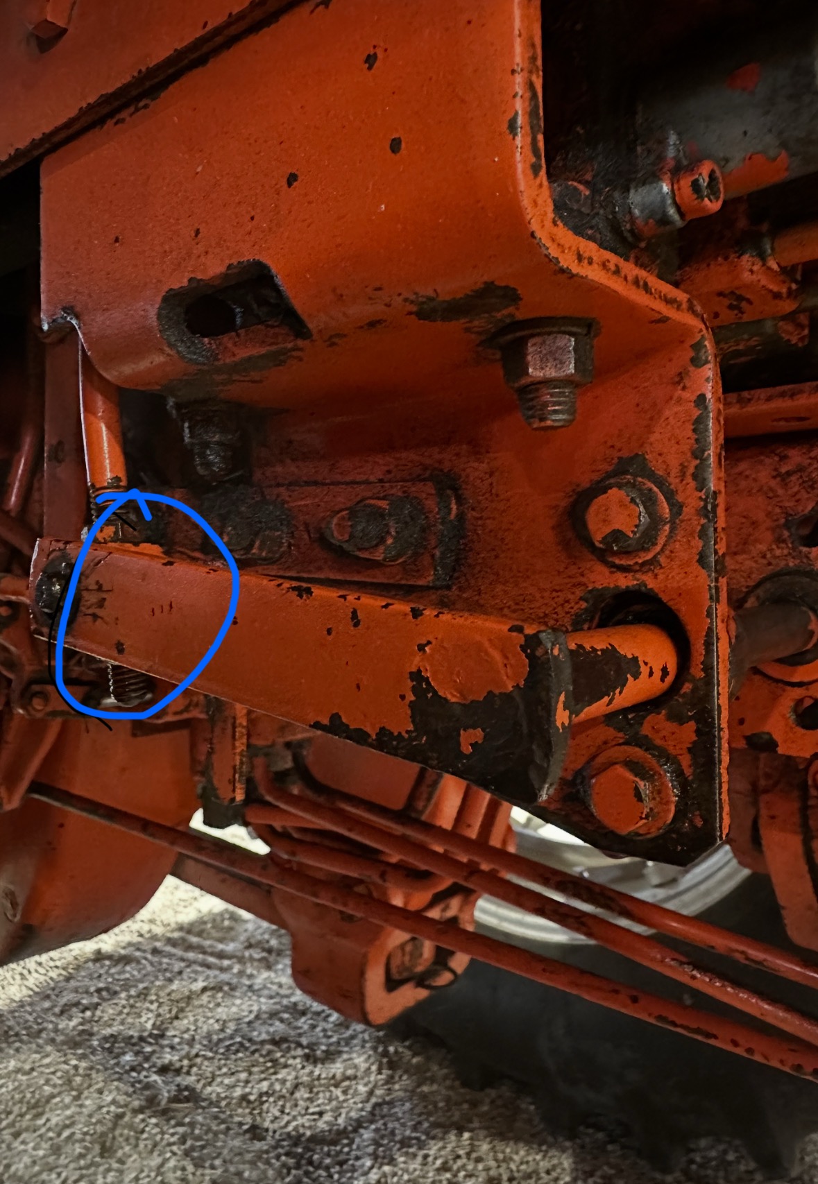

There was a service bulletin 45+ years ago about this problem. You can drill a new hole on the horizontal arm below the cab floor to move it forward ever so slightly. This will require grinding away some material on the hydraulic valves support frame due to interference with the vertical rod that comes down from above. OR, you could just rework your hand lever by adding material to the hand lever to do the same thing as your screwdriver.

Doc - you talking about drilling a new hole just forward of the old hole that connects the rod to the arm?

Yup. When properly located there is no more than 1/8" meat left between the old hole and the new hole. Make sure your bushings on that cross shaft are tight too. I still like the idea of maybe adding a little girth to your hand lever at the gate.

I have brazed the shift gate slots before,but drilling an extra hole in the cross arm takes less time. You will need to put a slight bend in the threaded rod for this to work. I don't think that I have that bulletin any more.

I measured mine this morning and the new hole is 1" forward of the original hole. May not be correct, but it has worked perfect for 45+ years. You would think that increasing the stroke on the high side would lessen the stroke on the low side. I don't know, but it works on mine.

Thanks for checking it out.  I think we will go the route of a new hole.
Does it look like the rod had to be bent forward a bit to get around the hydraulic bracket?

I usually always trimmed the bracket a bit and then see if the rod needs tweaking.

Yes, the rod is bent forward at the bottom maybe 15-20 deg. to reach the new hole location. Not sure if the rod was straight originally, it may have had a slight bend from the factory. I don't think the bracket was trimmed any on mine, just tweaked the rod.
