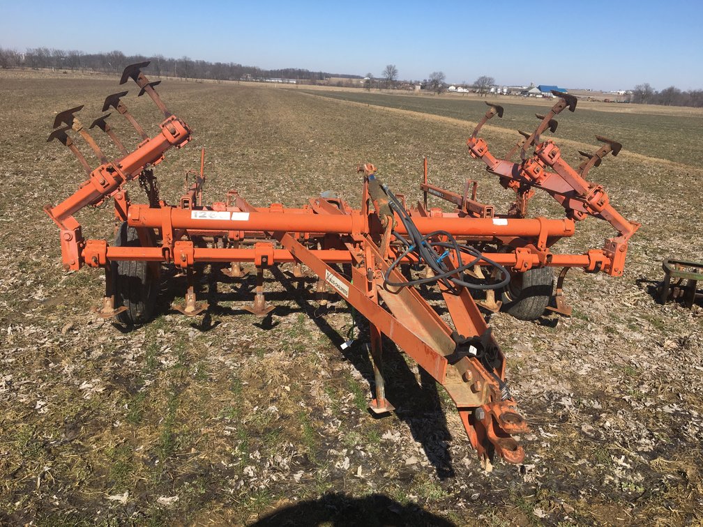

Wondering what sizes of implements I should be looking for to pull with the 200. We have an 8 shank JD chisel plow that at 6-8in it doesnt seem to care very much. We are going to be looking at cultivators and a bigger disk in the future possibly and wondered what sizes to look for. My grandfather has been no till for most my life and at the time they did tillage a 190 gas was the biggest so not much knowledge to go off on for  a bigger diesel. Current tillage setup is the chisel, a light little 8 foot JD disk, and a Frontier 3pt mulch finisher. Let me know what you guys run or ran.
heres examples of what we have. The chisel was a 12 i took the wings off to make an 8.

All I'm going to say is this: a model 200 with bald tires and without any fluid in the tires or extra wheel weights may only weigh 9,000 lbs with a cab on it. It will surely not be able to "pull" what another 200 can that has good rear rubber with fluid and/or wheel weights and tips the scales at 12,000 lbs. The 94 HP doesn't mean a thing if you can't get the traction to use it.

You make a good point, I forgot to add how the tractor is set up. Ive got a full set of suitcase weights up front. I believe the rear tires are loaded as well. I would post a picture but i says its too big so ill have to edit it down I guess.

With a 190XT I've pulled a 9 shank chisel similar to the one you pictured but a Krause. Also an 18-1/2' field cultivator. My cousin used to pull a 20" Krause disk with his 190XT but to me that was too big but there is a wide range of heft for disks. I think a 20" 2300 Allis disk would be fine but 18' may be better. Around here a 4x18 plow was a good match for that size tractor. And like the good doctor says..... weight and tires make a lot of difference.
