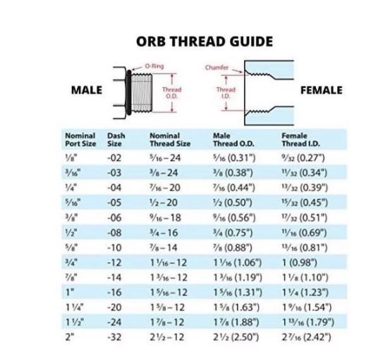

Post Options Post Options   Thanks (0) Thanks(0)   Quote steve(ill) Quote  Post ReplyReply Direct Link To This Post Posted: 22 Jun 2024 at 4:46pm
im not saying it is a -12 fitting ... but if the OD of the plug is 1- 1/16 inch ... then something like this should fit.. ( 12 threads per inch)..
