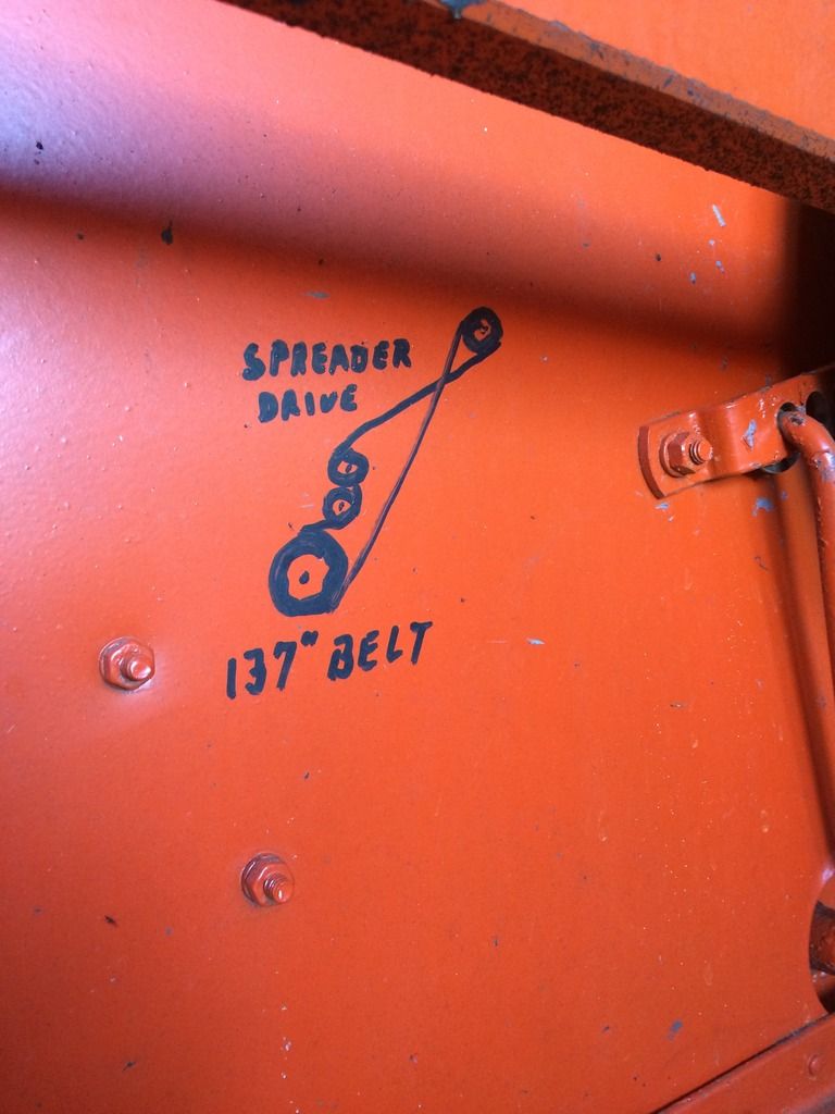

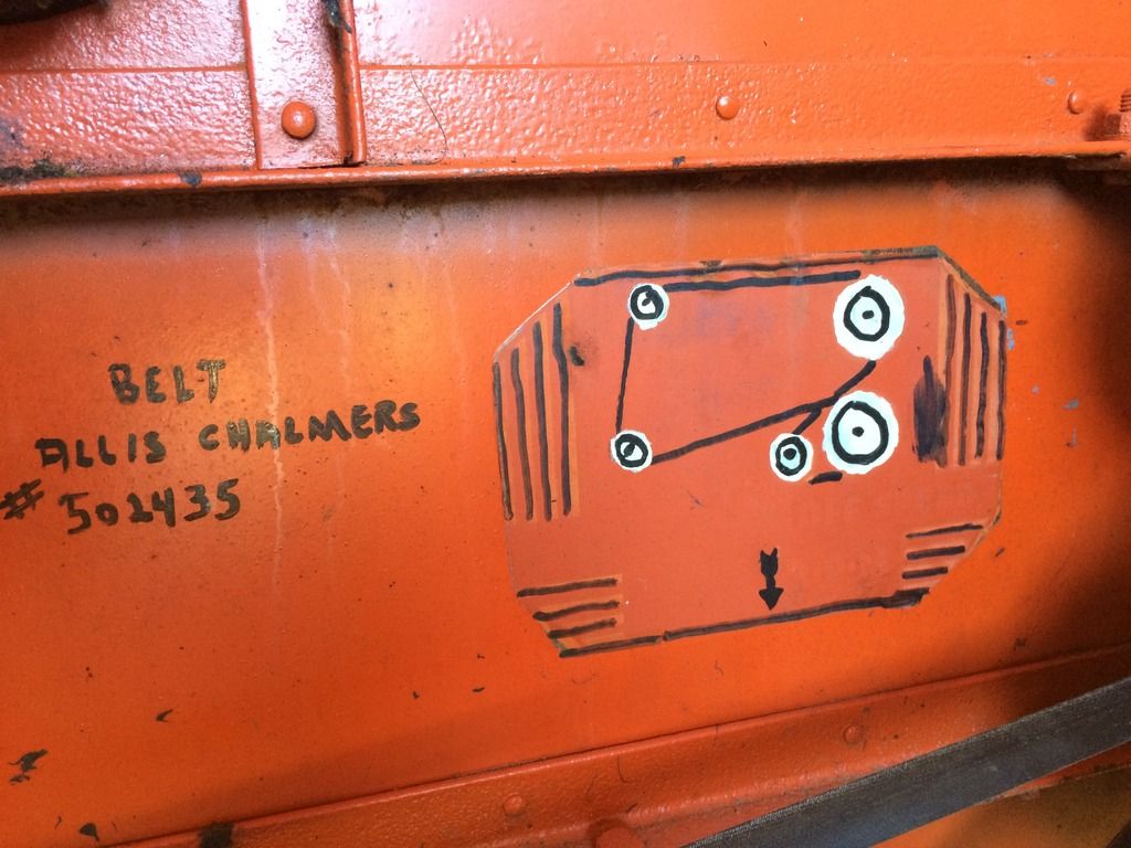

Thanks for the pics. I know how the belt goes on, but why it twists itself between the idler on the top left and the big sheave on the top right was what baffled me. I guess it's normal.

Don't know if these will help.

Mistake twist right and then left.
wfmurray View Drop Down
Location: Bostic NC
Points: 1225
Post Options Post Options   Thanks (0) Thanks(0)   Quote wfmurray Quote  Post ReplyReply Direct Link To This Post Posted: 27 Sep 2016 at 10:53am
Put belt on top big pulley twist to left going to driving pulley go under it and bottom big pulley and twist to the right then straight to fan and idler.Guess it has been close to fifty years since I put one on.

there should be a decal on the back showing the way the belt goes.
