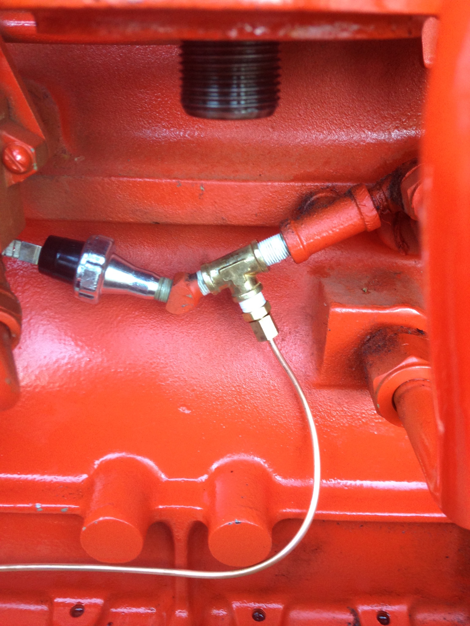

   I found this picture:
   Ross.

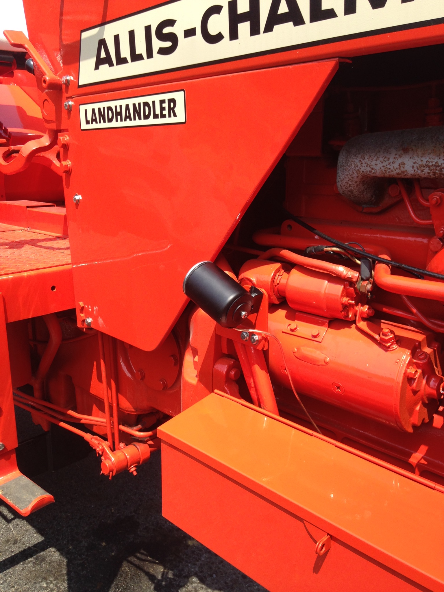

Post Options Post Options   Thanks (1) Thanks(1)   Quote AC720Man Quote  Post ReplyReply Direct Link To This Post Posted: 17 Feb 2019 at 9:06pm
Ross, that’s my XT I posted last year after I installed the gauge. I also had a sending unit go bad while baling hay. The red light lit up and I feared the worst. Hauled her home on my goose neck. Ordered a new sending unit and thankfully that was my problem. Also ordered the gauge and components at the same time. It has been a great addition, gauge is easy to see and gives me the peace of mind that I was looking for. Still have the idiot light also.

Post Options Post Options   Thanks (1) Thanks(1)   Quote lentsch Quote  Post ReplyReply Direct Link To This Post Posted: 17 Feb 2019 at 9:23pm
Would like to add-be sure to use a copper line to gauge(as pictured.)Some of the auto parts store gauges come with a plastic line which can easily melt or break.

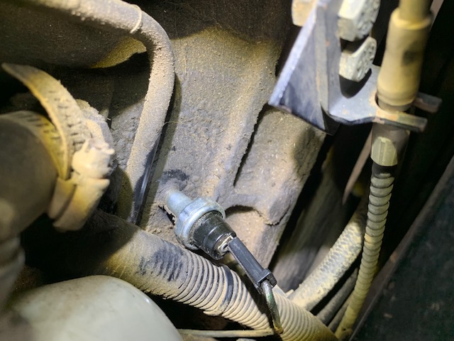

sjefferys View Drop Down
Joined: 16 Apr 2018
Location: Texas
Points: 5
Post Options Post Options   Thanks (0) Thanks(0)   Quote sjefferys Quote  Post ReplyReply Direct Link To This Post Posted: 19 Feb 2019 at 6:27pm
Thank you to everyone for your help and suggestions.  Found the switch and noticed it has a little oil leaking from it.  Not sure if that indicates anything serious or not.  It appears that it simply screws into the block.  Not sure how to tell if it is bad or not.  I unplugged and the light of course went off.  Plugged back in and light back on but everything seems to be running fine.  Trying to find where to purchase a new one to double check the switch.
