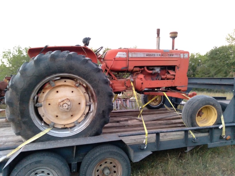

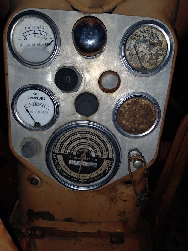

I just picked up a D19 diesel. I have a D19 gasser that has bad rear rims, tires, and engine and figured what the heck, can't go wrong with this diesel and maybe I can make one good tractor out of the two. Engine is stuck, starter is missing, one lift cylinder is busted, air cleaner cup is gone, and someone was either really short and didn't like the factory hydraulic controls and seat, or this was some sort of special purpose build. Lots of mysteries with this tractor.
I had been contemplating trying to fix it up. Then realized there is no turbocharger and therefore I'm not even sure what engine is in it, other than it appears to be a D262. All the D-19s I find online have a spin on filter on the LH side of the engine and this one has a cartridge style, so is it an older engine from a D17 or some other application that was naturally aspirated?
I'm thinking I mess with the engine a little in the off chance it's barely stuck. If so, maybe the diesel becomes my engine if it doesn't need an expensive rebuild. If not, I'm probably better off putting my money into rebuilding the G262 in the other D19? I'd like to hear your guys' thoughts... What would you do? I know these diesels had issues with the blocks and heads.
Points: 22794
Post Options Post Options   Thanks (0) Thanks(0)   Quote DrAllis Quote  Post ReplyReply Direct Link To This Post Posted: 02 Sep 2023 at 11:35pm

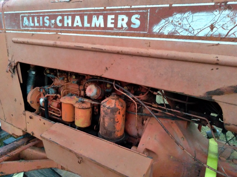

That's a D-17 diesel engine, I think, so a whole 51 HP at the PTO, instead of 66 HP a D-19 turbo diesel would have. They even used the power steering pump on the generator from the D-17.

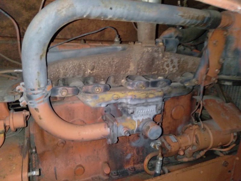

Wow, the generator oil guard is still on the adjustment bracket. That’s hard to come by, most of them got chucked.
That’s quite a project there. The D262 is expensive to rebuild.
Interesting. I'll be sure to hang onto it. Space sure is tight up there by the generator, fan, and air cleaner. That other thread about the D17 diesel fan to air cleaner clearance is right, it's sure close.
I may rebuild the G262 in the other tractor instead, but either way it's not very cheap compared to a WD-45.

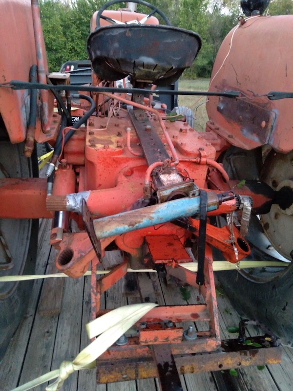

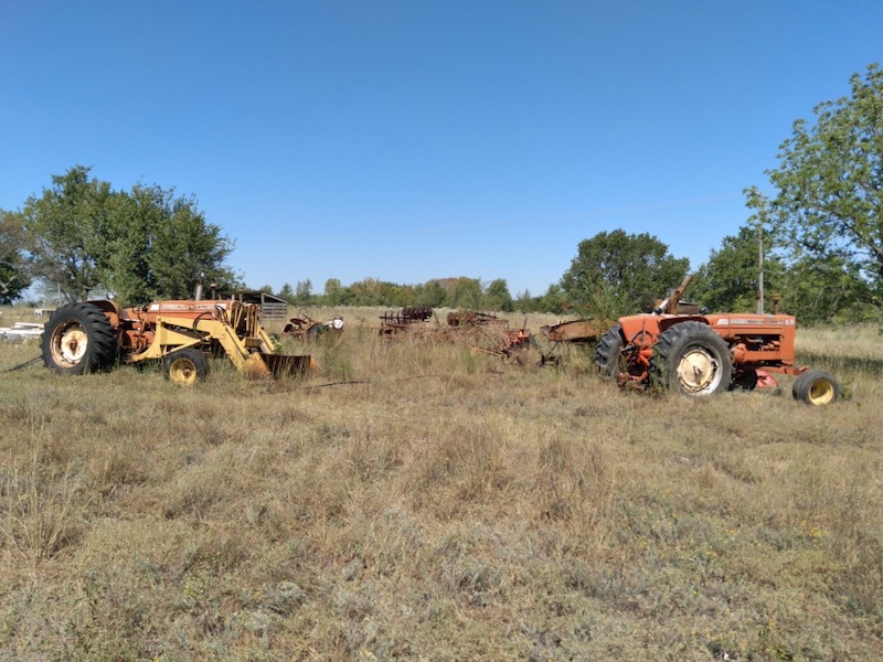

Both of the D19s waiting for me to figure out a plan of action:

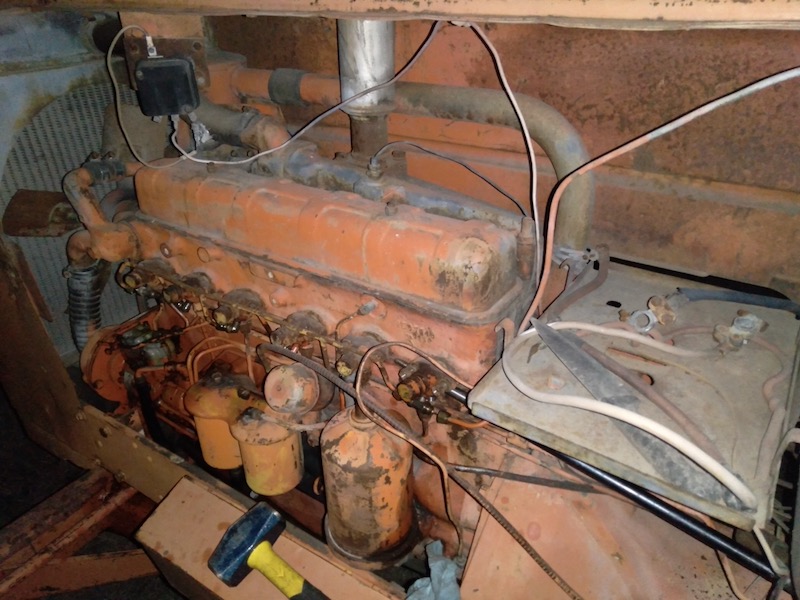

I was able to spend a little time on this tractor this week. You can see just a hint of movement in the flywheel when you try to bar it over at the ring gear. I moved on to pulling the injectors so I can see if any of them have any rust, and dump some penetrating concoction down the cylinders. I figured out the right combination of pry bars tonight and popped the #6 injector out. Visually, it doesn't look too bad, and definitely doesn't seem like it's had any moisture exposure.

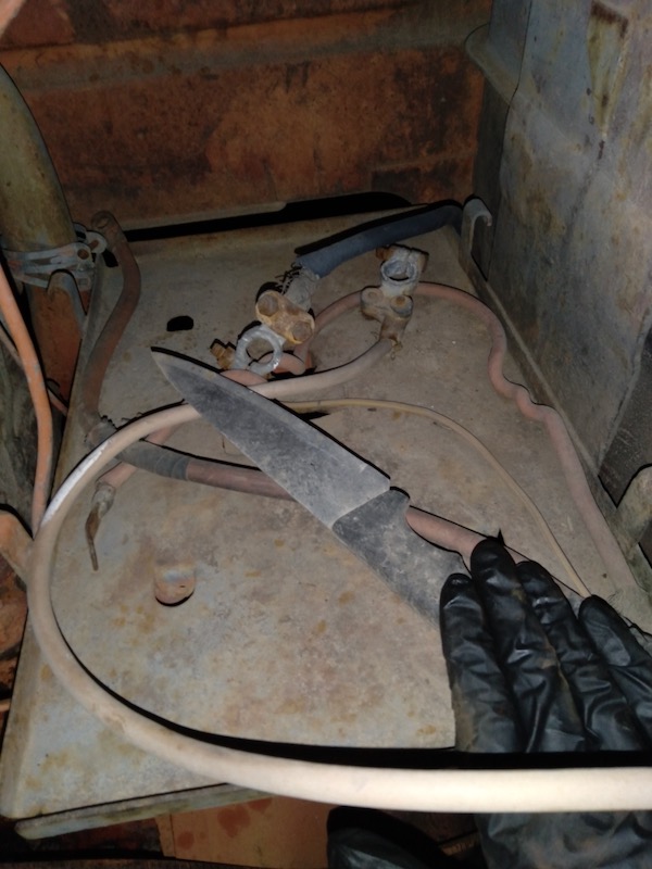

Also... There was a decent sized knife sitting on the battery tray that I didn't see until I opened the hood panel. I'm open to everyone's theories on why that was left there.

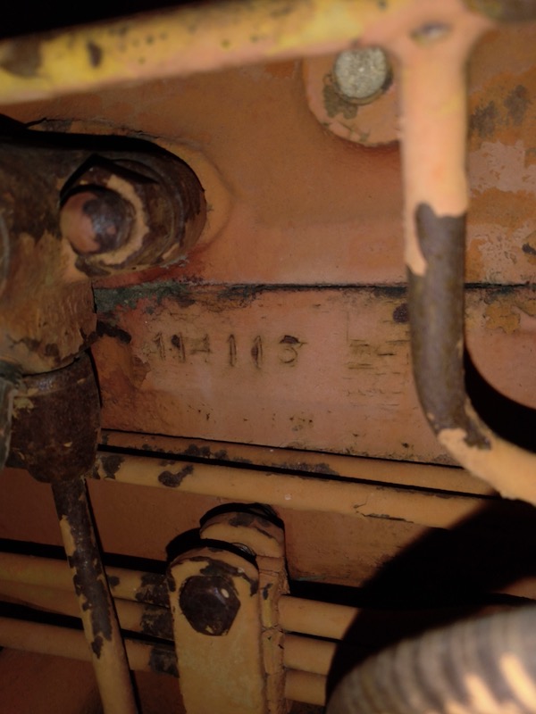

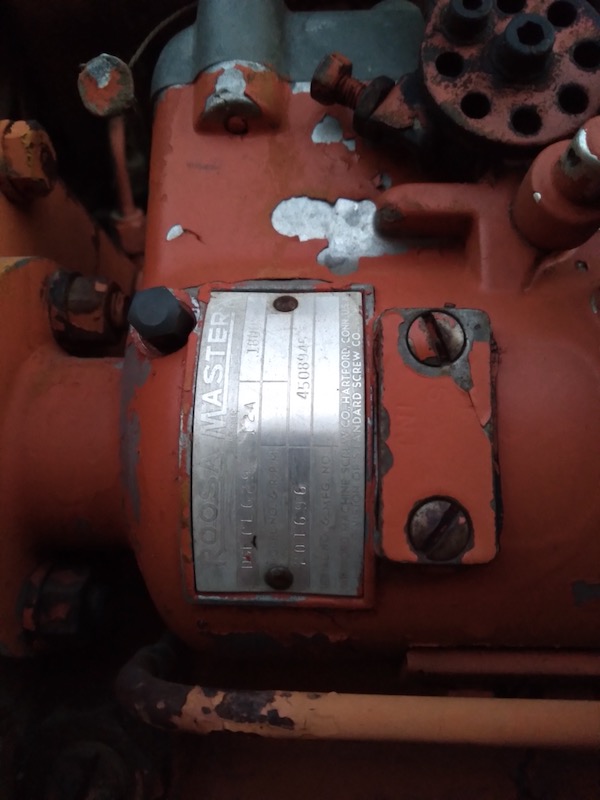

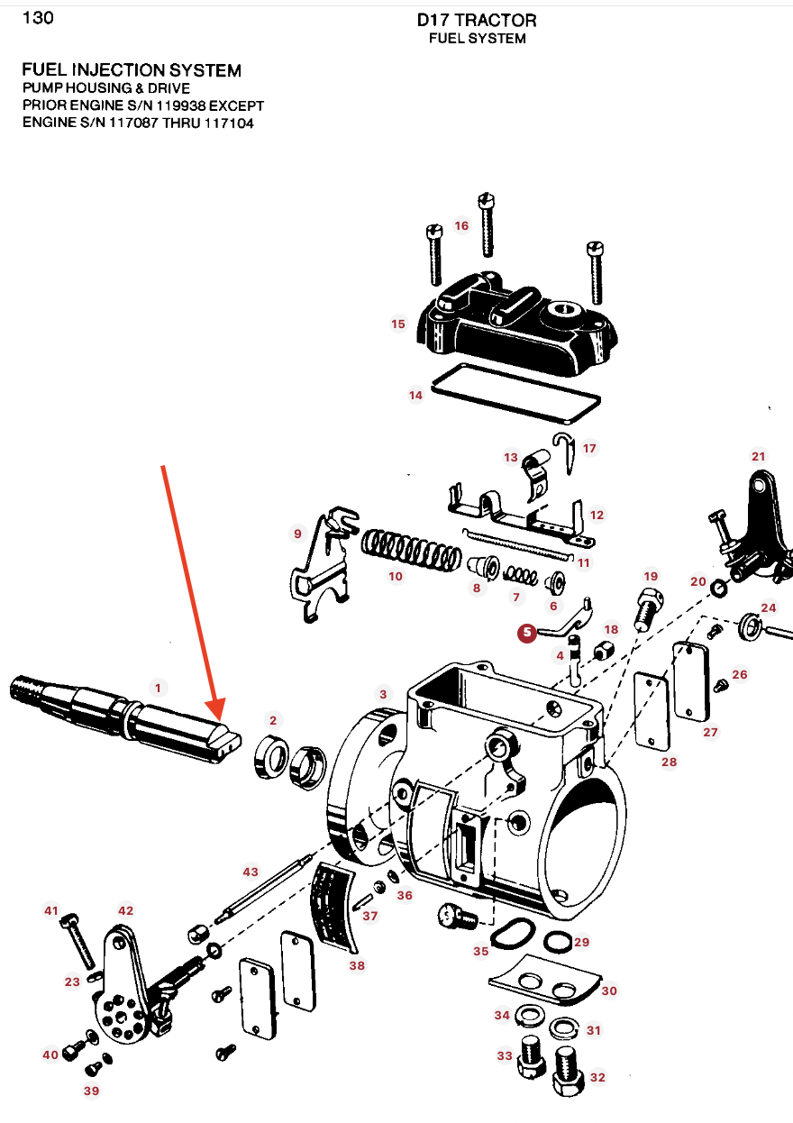

By the pump number, it's an early D17 like Dr said above, the DGFCL629-12A is D17, early D eries Roosa pump, very different inside then the later DB found on almost everything lol! Don't force the pump to turn if it's stuck from sitting. You'll end up with it seizing the hydraulic head, and they're long obsolete. Good used are getting harder to find.
Thanks Ed! I needed the reminder... I've read that a dozen times on the forum, but not being a guy with a lot of diesel engine experience, it wasn't the first thought in my head. After I get the injectors all pulled and see if there's any rust, I'll pull the pump off and try to spin the engine over again.
There was plenty of diesel in the lines when I removed the nuts from the injectors so hopefully the pump isn't in too bad of shape.

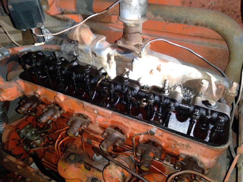

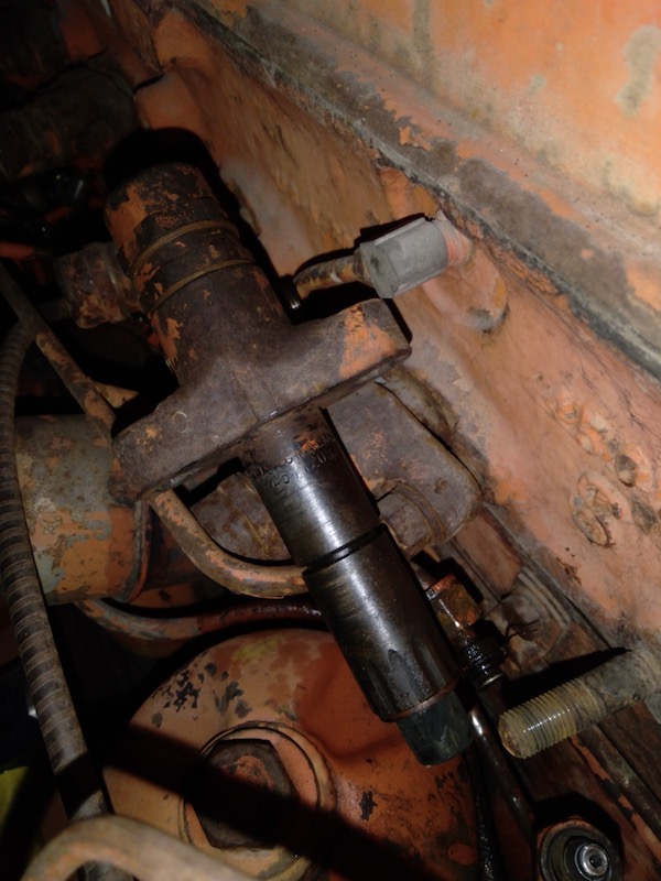

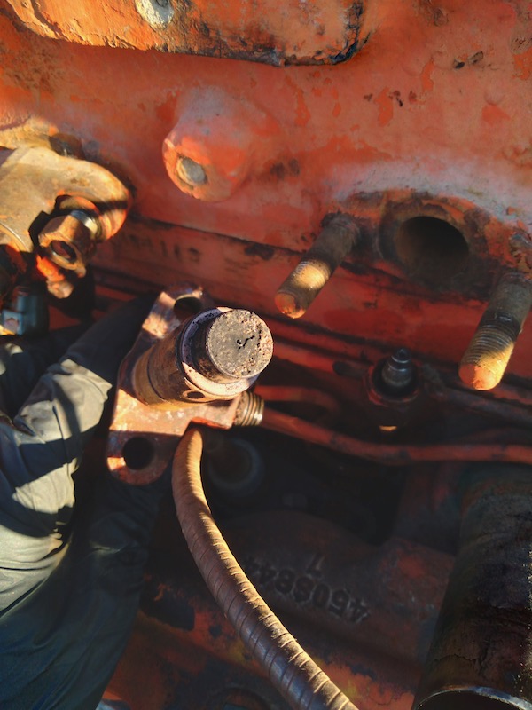

All of the injectors came out. A few of the cylinders and injector tips had what I would call light condensation rust spots. I dumped some diesel into the cylinders and we'll see if I get lucky.
I pulled the two nuts for the injection pump and pulled it back slightly from the timing cover. It seemed to be spinning nicely when I rotated the pump around with the shaft/gear still engaged, and no hint of any rust on the shaft. So, I don't believe the pump is stuck - good news.
Things look pretty good under the valve cover, too.
If this thing isn't stuck very badly, I'll try to get it running. Still trying to see if that will happen before shifting focus on rebuilding the gas engine in the other D19.

Doc and Ed are correct, that setup is straight from a series 1 D17. Exactly like my series 1 I just finished. Ed is giving you great advice, if you plan to save the diesel pull the pump and have it serviced before you go any farther if damage hasn’t already been done. I tried to advise a good friend of mine a month ago when we started his WD45D project to remove the pump and have it serviced because ED has been advising everyone for years to do so. He didn’t listen, it’s had fuel in it so it should be fine he said. It had been sitting for a few years with almost a full tank of fuel. After replacing the bad o-rings in number 6 cylinder sleeve, replacing the head gasket, new sealing washers on the injectors, reluctantly we attempted to start it. When no fuel appeared in the fuel filters after cranking for a minute of so I called ED. He instructed me to check the lift pump and sure enough the idle gear was stuck, shearing the key on the shaft and popping the snap ring into the pump. Now he has serious issues as parts are NLA. Ruined probably a good salvageable pump, feel bad for him, it’s a nice original tractor, but I did my best to get him to send it off multiple times. Not sure if he will be able to find parts or another pump to a rare tractor.

Ah, I see now that my attempt to rotate the pump itself around the shaft was meaningless. The shaft disengages from inside the pump when you pull the pump back:
But... quick and dirty, I can pull the pump back like this when I try to get the engine to turn, and avoid turning the pump. If I do somehow get the engine unstuck then I'll have to properly pull the pump off and see if it is stuck or turning like it should.

If the pump is slid back far enough then yes you are correct it would not turn the pump. The injector lines would all have to be disconnected to do so. If you did that before attempting to turn the engine then you are ok. Ed rebuilt my pump and runs much smoother and starts easier than it did before.
