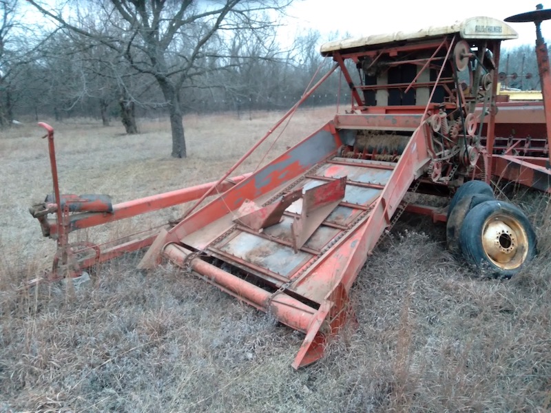

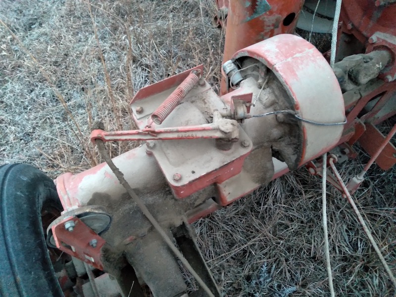

I found a slightly better candidate for fixing up than the $50 Roto-baler I bought last year. This one is a 1960 white top with overdrive.
The roof is slightly bowed in from someone probably storing something on top of it, and the safety shields over the intake are missing. Otherwise it seems to be in good shape and has spent most of its life inside. I am going to have to break down and get belts for it - they didn't look bad from the ad, but the lowers are delaminating.
I must be nuts to put $800 worth of belts onto a baler so I can bale and hopefully sell $100 of straw this year?

You'd only be crazy if you try to transition it into something else, other than what it IS...Wink

They actually made fewer white tops with overdrive than number 10's. I have some barely used spliced bales if you need some

That is an interesting point - supposedly 750 white tops with overdrive, vs. 1500 #10s? Of course, an unconverted #10 would still be much rarer. I'll send over a PM about belts.

and the over drive does?

Overdrive?  Also, my question, been around them but they were "not overdrive".

Isn't that the Reversing Gear?

It kicks in to increase the speed during the twine wrapping cycle, then kicks back out when ejecting the bale. It just sped up the wrapping by a few seconds. I'm pretty sure I've seen a video of one in the field on YouTube but I'm not sure I could find it again. They talk about it briefly during the Roto-baler history walk at the Orange Spectacular:

I have a parts baler with the Overdrive all complete with the OD and related gearbox etc.If someone needed would give  them a very good price.Or take the whole baler

Theres actually a good chance this baler rolled off the assembly line as a #10.  There was a number of balers sitting in inventory at the LaPorte plant that were never sold.  When they realized it was a flop they converted them to fast wrap balers, gave them different serial numbers and repainted them to the current colors.  Notice it has the #10 axle.  There were some leftover #10 baler parts that were assembled as fast wrap balers.  Once all of the parts were used up there was no longer a fast wrap option.
Many roto balers have a dent in the hood, it is believed to be from a knot in the twine catching as it got caught in the guides in the roof.  I have heard it happen and makes a loud noise.
There are a few Hansen bale loaders out there.  I have one, it came off a standard baler.  Allis-Chalmers did offer it as an option but only for the #10 baler.  I'd have to check but I believe there was a guard that could be installed to prevent the bale from falling into the belts.
Congrats on a great find!

I think those are the pick up"feet" for a number 10 as well
