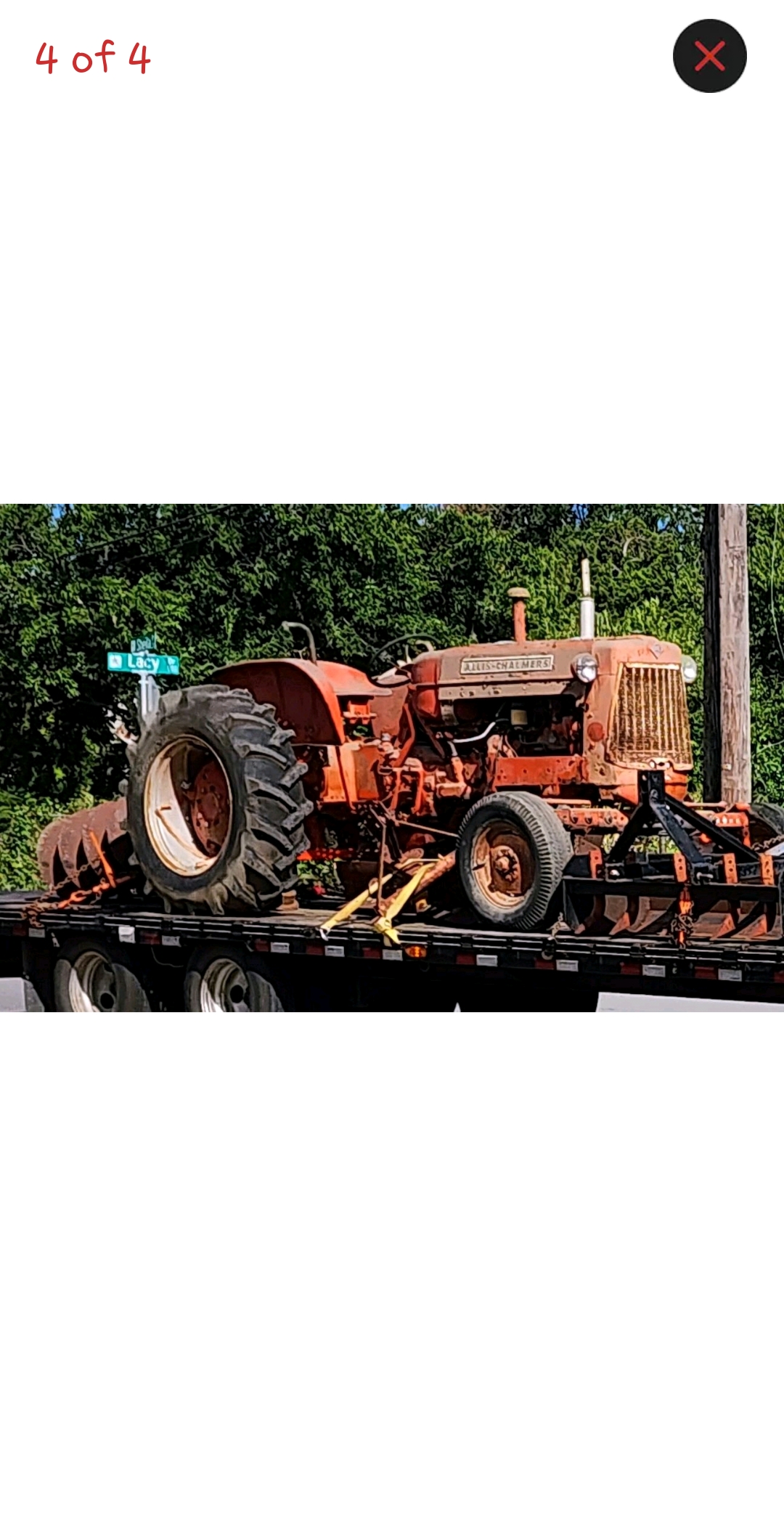

Thanks! My name plate is riveted on the hood. Isn't there supposed to be an oval D17 decal somewhere on each side? My grill is currently what's left of white or cream. I don't have the tractor with me right now and I'm going to try to attach a photo but it seems like the entire front wheels are orange And the rear wheels have orange centers but either white or cream or actually silver rims. I can't tell from the photo. How about the exhaust pipe and the lights?

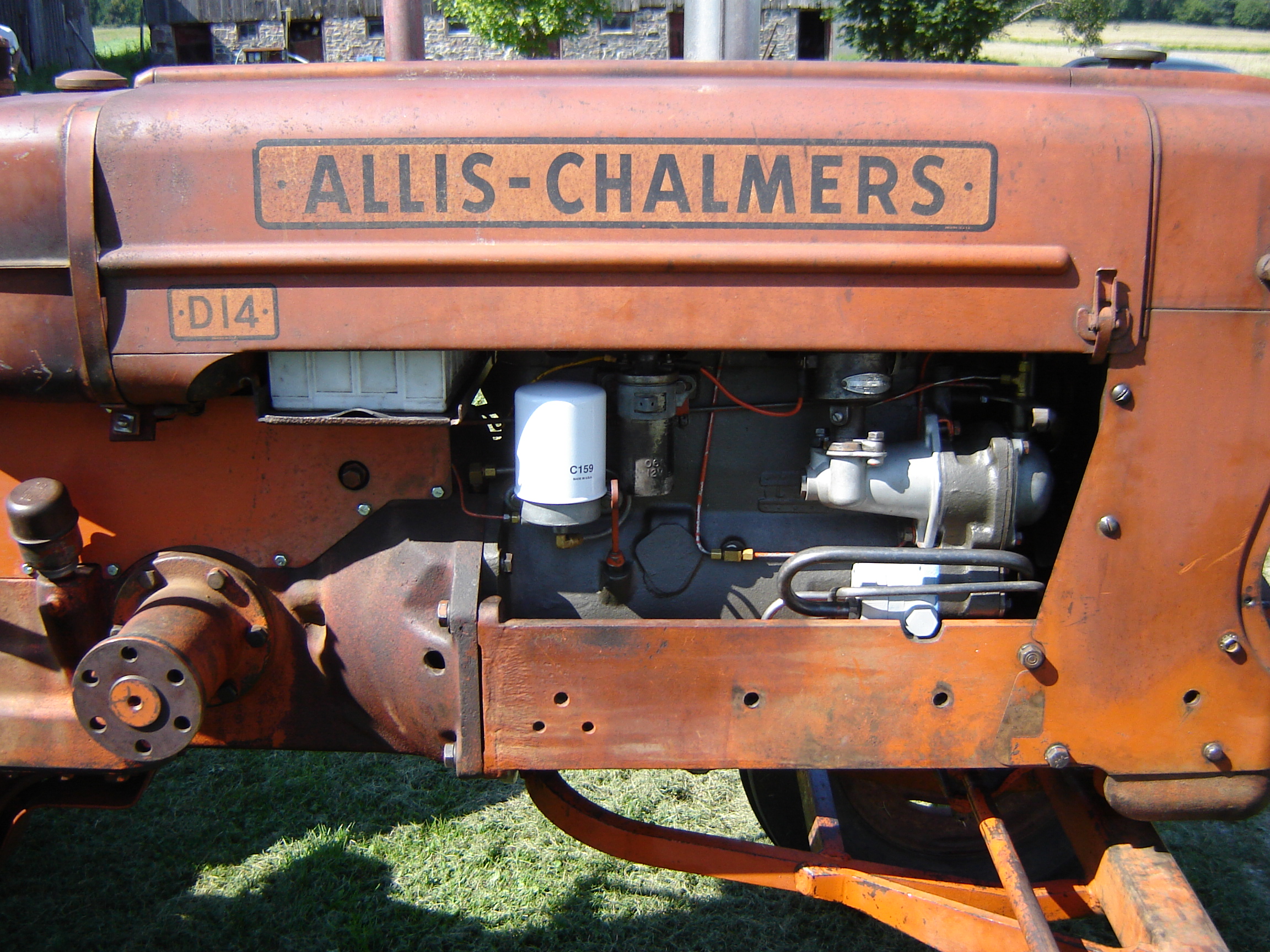

No oval "D-17" decals on yours. That's for the early models. Yours should have a rectangle "D-17"  decal just above the rear hood snap latch.
D14 decal for reference, D17s were similar (except for the aluminum nameplates).  Earlier models from 57 to early 59 had oval decals.  59 and up used these ones...

oval decals are down on the sheet metal below the tank on my series 1
