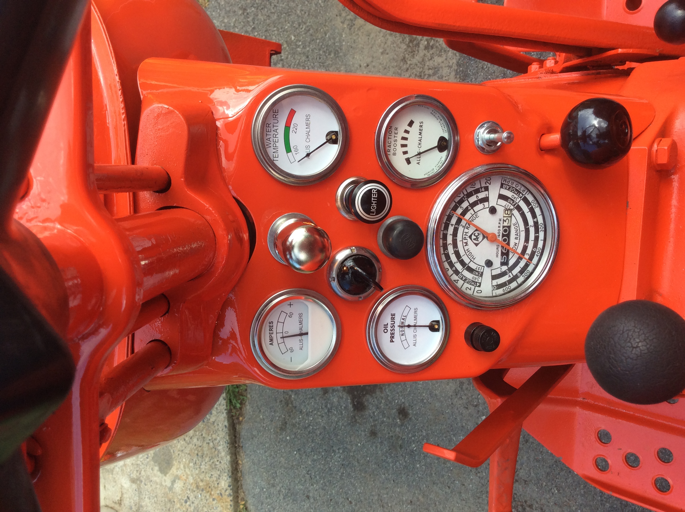

Are the wires on the ammeter reversed?

I had just pulled the light switch on when I snapped the picture that’s why it’s showed negative in the picture. Genny picks right up to positive charge.
