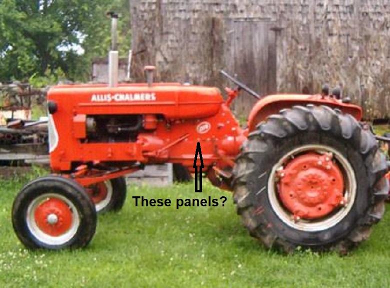

fellow I bought this tractor from gave me two side plates for this tractor but I am having difficulty trying to figure out how they go on. anyone have a ph0to I can llok at to see how they are fastened on. thanks

I am guessing you are talking about the side panels that fit under the gas tank, as in the attached pdf. If not, please post a photo of what you are asking about.
D17_side_panels.pdf
They attach with 1/4" screws around the perimeter, They go from the side of the dash to about the back of the engine on both sides of the tractor. Here is the left side of a D14 with that side panel in place, the 1/4" capscrews are bright finish and show. D17 will be similar.

I was thinking they went on the side under the hood but I think I understand now. thanks for the photo. norm

I take mine off and leave them off . Makes for a nice mouse nest building space. My father took the side covers off both of our D17s. They hung in the shed until the day we moved off the farm .

As Pat says,they are good for looks but invite trouble. I'd hang em on the wall.

Like Jim said 1/4 20 screws . Just cleaned mine with a tap . At least that's the size on my D 15 . If I had side panels I would have them on , but we don't have much of a mice problem down south . Thanks

I like having the panels on the 17 but if you have to do something in there, they are not quick to remove.
