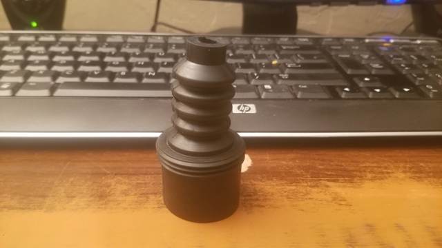

Found a new set of pole shoes for the 30MT starter, and purchased a new solenoid along with brushes/bushings. I rebuilt the motor part as the field coils were good, but have yet to receive the weatherproofing rubber boot so another project at a standstill.

Well unannounced, the rubber boot showed up in the mail today so hopefully finish up that open task this weekend.
