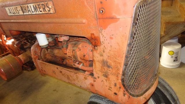

 Update on the D17 progress.

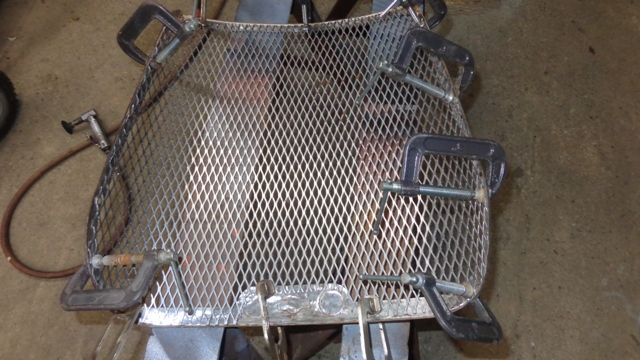

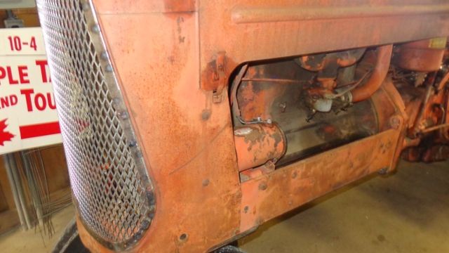

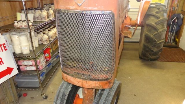

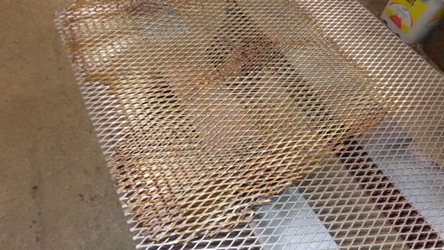

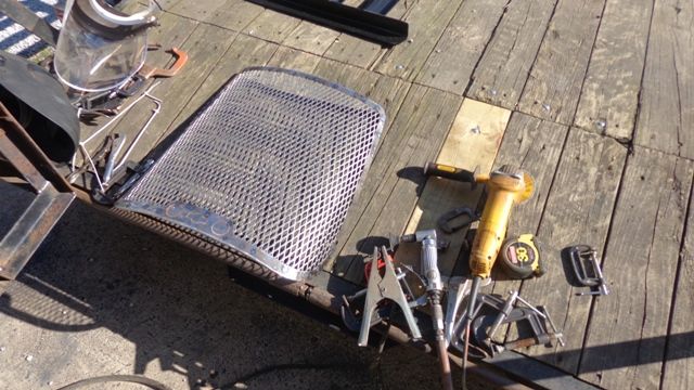

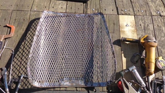

The new grill screen layout. With old screen flattened and on top for pattern.
Cut out, sanded edges and test fit screen to grill frame.
Looks pretty good so far.
May get this tacked together tomorrow? Weather was so nice I had to mow lawn for the first time! Also working on my trailer to get it ready for hauling AC's!

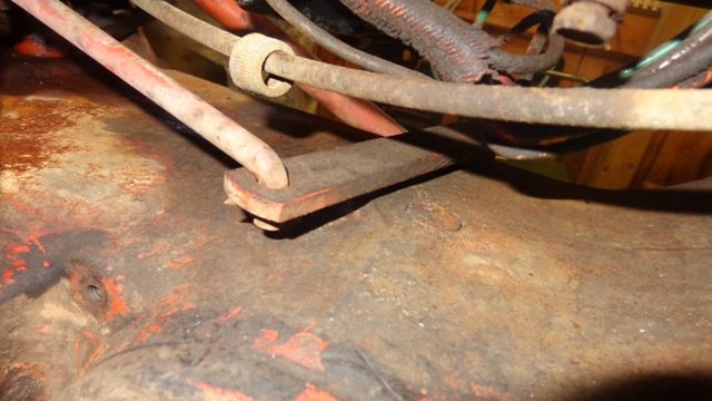

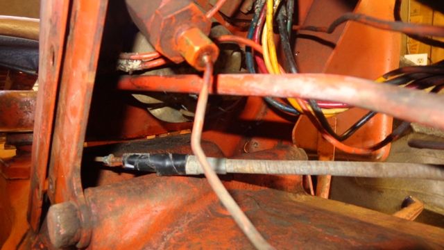

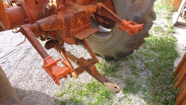

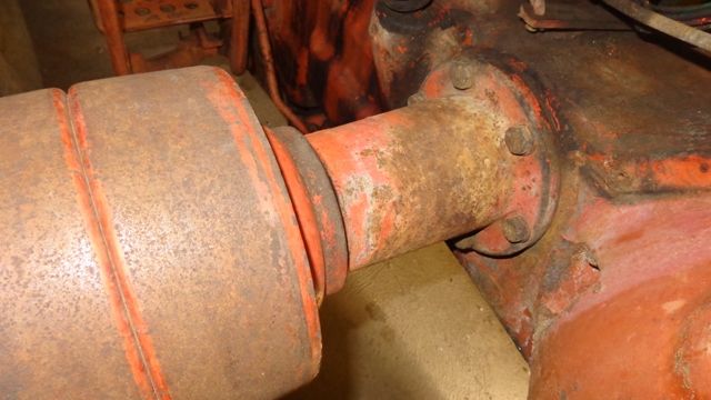

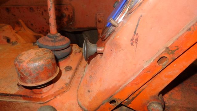

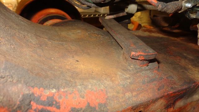

These are some pictures of the belt pulley linkages and set up that Jim wanted.
The knob to engage.
Linkage and lever for pulley
Belt pulley
Linkage coming out of dash
pivot point of pulley engage linkage left side.

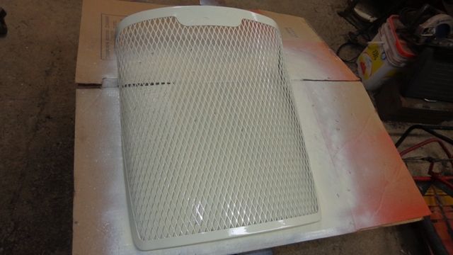

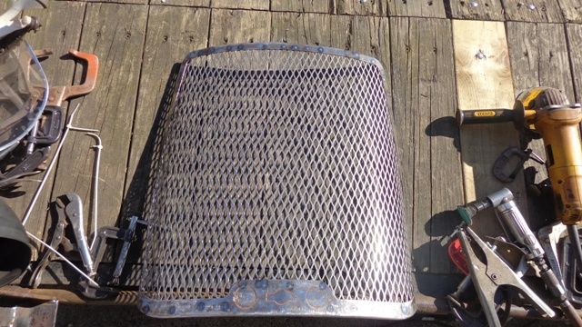

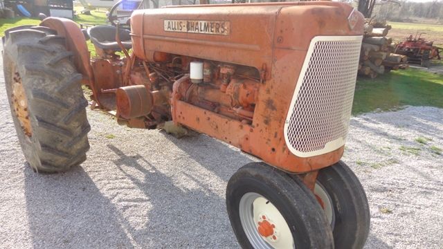

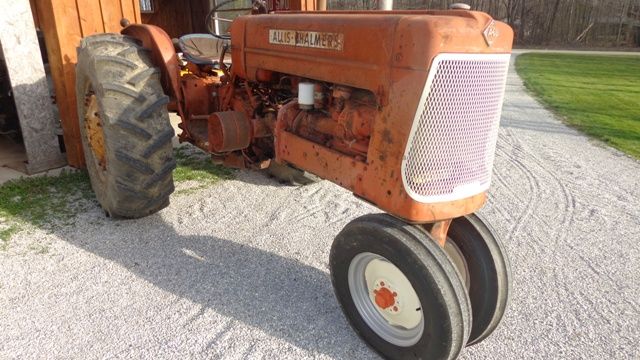

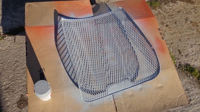

Here are some pictures from today.

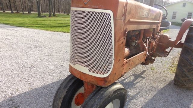

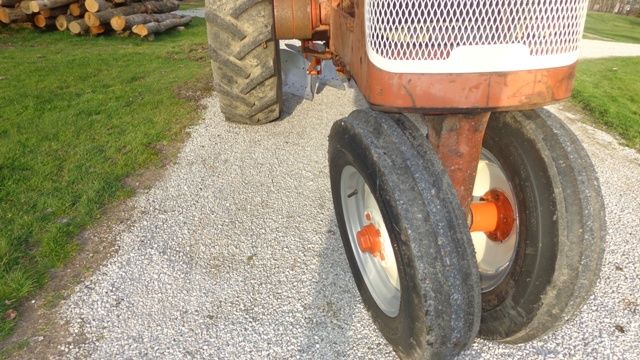

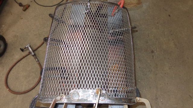

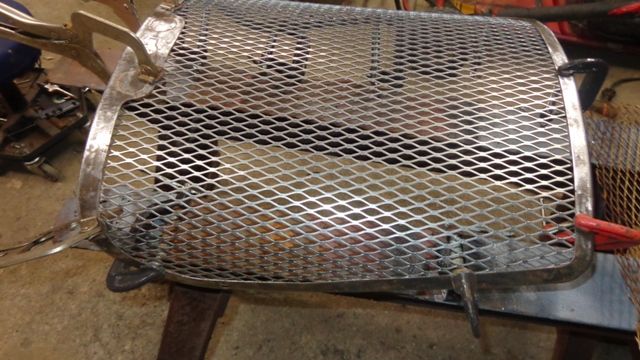

New screen tacked in place. Don't tell anyone but I wished I would have looked at the expanded metal a little closer. I did not realize that one side is a little different, smoother. Of course I put that on the inside and did not notice till it was welded in place!
First trial fit up. It needed a bunch of tweaking. Bending and massaging. And the welds could not be much higher than the screen thickness. Since I did not have a spot welder my welds had to be worked down.

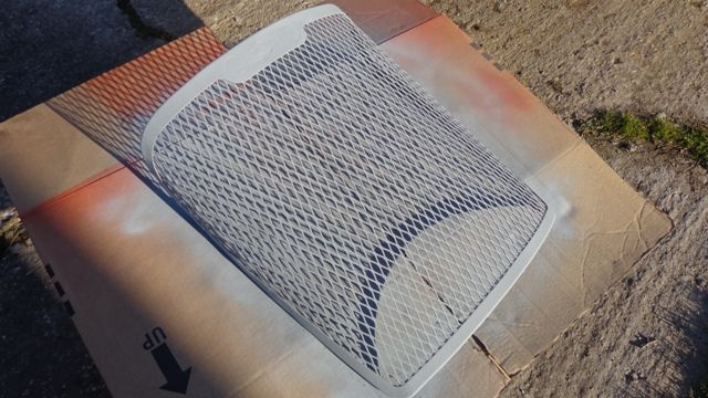

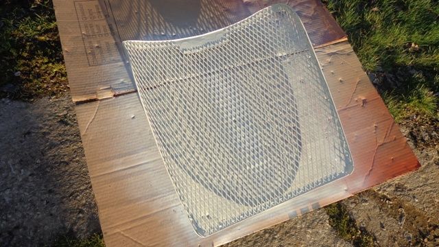

Primer
Cream to finish it.
Will pick up a couple stainless fasteners. Were these like a button head, pan head, or truss head, screw driver slotted screw?

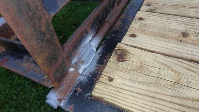

Worked on the trailer ramp redesign and fabrication work most of the day. Can you say sun burn, and some weld burn on top of it too?!!!! Tried to cram all of summer into one day!
Edited by Sugarmaker - 17 Apr 2016 at 8:45pm

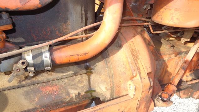

Had a small coolant leak from head gasket. Comes and goes.

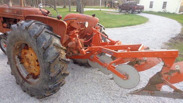

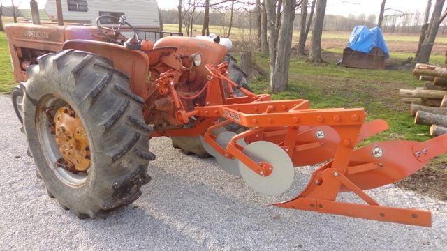

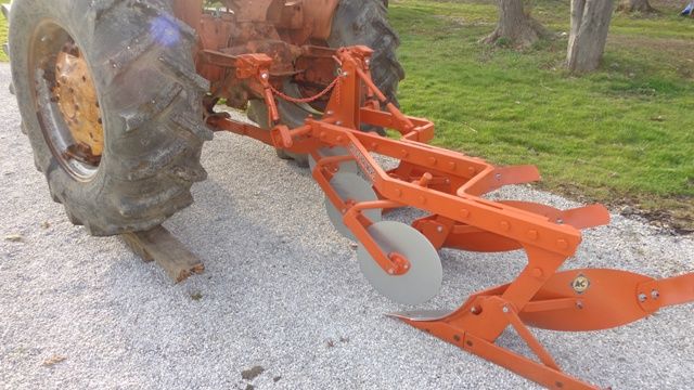

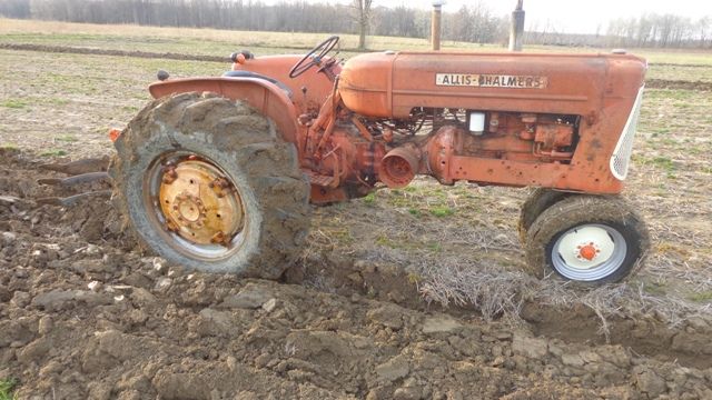

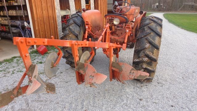

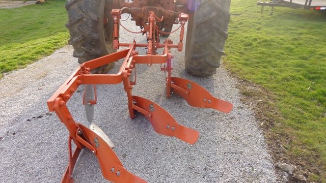

OK time for a little play time in the dirt and to see what this D17 will do. Lets get some mud on the tires!

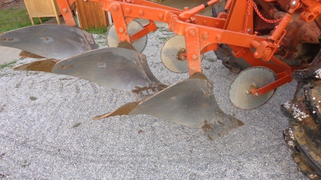

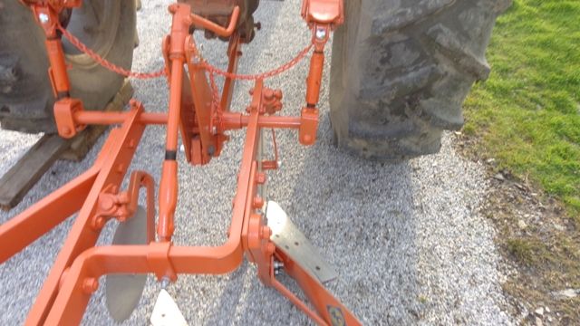

Out come the restored AC three bottoms. Sure was nice that all the adjustments worked.
Setting it up. That's silver paint on the moldboards. Going to try to scour them on some clay behind the house.

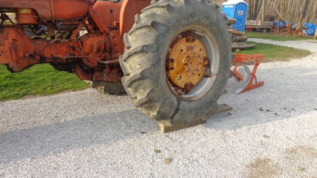

Set up the left rear on about 7 inches of plank.
That right rear tire looks about right for being in the furrow.
This is looking back along the inside of the right tire for alignment with first plow shear. Looks pretty good. Proceeded to level the plow to the ground.

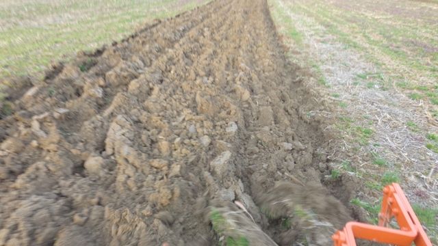

Second gear low range to get the feel of things. And learning how the traction booster control functions. Looks good so far.

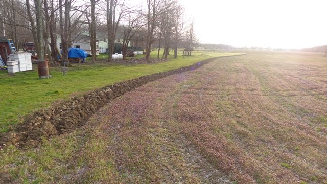

Striking out down the center of this 5 acre plot. Was beans last year.
North side of the field first pass, headed into the sun.
Made a couple rounds and then it was time to shut down for the evening. If the weather is good I may work on this tomorrow.
Never plowed with a narrow front end tractor before. Love the power steering.
She sounds pretty darn good pulling in the hard clay ground. Going slow till the plows are shined up.
Well this combo plowed better than most I have used. 45's were a little under powered. Our Ford 5000 was light in the front for the 4 bottom mounted plows. This D17 just seemed to be having a good time. I know these could pull 4 bottoms in the right ground. But this set of three bottoms seemed about right for ground conditions.
Moldboards cleaned up pretty good too.

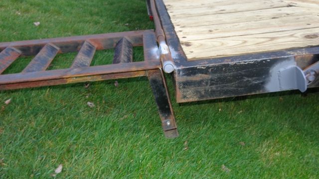

Spent some of the day working on the goose neck tractor hauler (below). Oh yea I spent a hour + on the old WD brush hogging 8 foot high goldenrod too.
Hear is a before shot of the trailer. Kind of reminds me of the MAD magizine restorations. Only partially done. Yep thats me!
Cleaned up the wheels, and painted, new center caps and lug nuts, power washed the deck, and frame. Added stops for the ramps. Located the spare. Built the center ramp. added structure around center tail light cluster (so I would have to work harder to destroy it). added stops for the ramp holding bars. Re positioned the legs under the ramps. Just picked up some Valspar black that I will brush on the frame. May use Thompson water seal on the deck?
Just another toy in the bigger sandbox!

Originally posted by Allis dave Allis dave wrote:
I like the 3rd trailer ramp. Wish mine had that.
Funny how I think everyone tried to cram all of summer into one day last weekend!
Dave,
That third ramp was one thing I wanted to build for loading the narrow front tractors. Lots of folks said just use a old 2x6. I did not think that was safe enough. I also wanted to be able to load garden tractors too. I have about $60 in material for the center ramp. Plus time to build it. It just hooks on the pivot rod. Haven't tried a big tractor yet. I used 2x2 x 3/16 steel angle. made it 18 inches wide. I built one last year for the neighbors trailer that I borrowed. I just gave it to him, since it matched his rig.
 You got that right on the one day of summer! We get a handful of days when the weather is just perfect! Lots of hamburgers grilled and lots of yards mowed in this area!
Go like heck, then rest!

You're a go getter that's for sure.
I've had a 3rd ramp on list since I bought the tractor 5 years ago. If I had a narrow it'd probably be higher priority. I guess If a friend wants me to haul their tract, they can build their own ramp and leave it on my trailer ;)
I wish mine had the bar all the way across the back like your's. It would make the build easier.

Chris,  love the pics and the instructions on the plow set up.
As far as the plantar fascitis... someone on this site sent me a pm a few years ago recommending that i purchase some "pinnacle powerstep insoles" for each pair of my shoes, that it helped him tremendously.  I bought some and have worn them in all my shoes since.  I get them on Amazon now, but used to get them from a place called 'footsmart'.   they aren't cheap, but they did make a big help!!!
