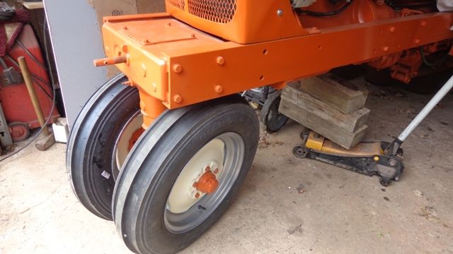

 Completed the painting of the D17 front rims. In for drying and should be able to get the tires mounted in a few days. Weather is cold and rainy!
(my fix on the gas tank may not have been good. Have to take a close look at that tomorrow.)

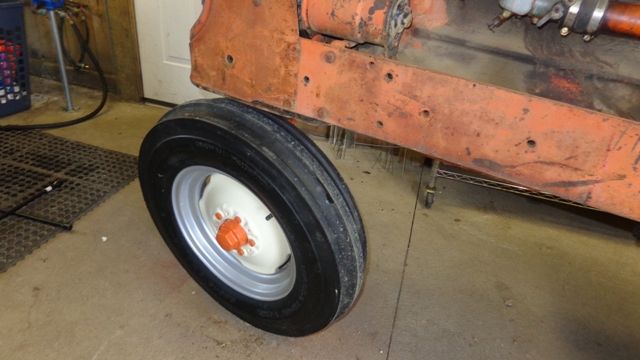

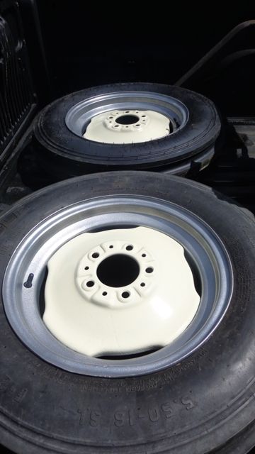

Got to the tire shop and had the 5.50-16's mounted for the WD NF.
During the tire switch: Here is Dad's WD with the new 5.50 on the right and 6.00 on the left.
The WD with new painted wheels and correct size tri ribs.
Over to the D17
The tank is dry too!

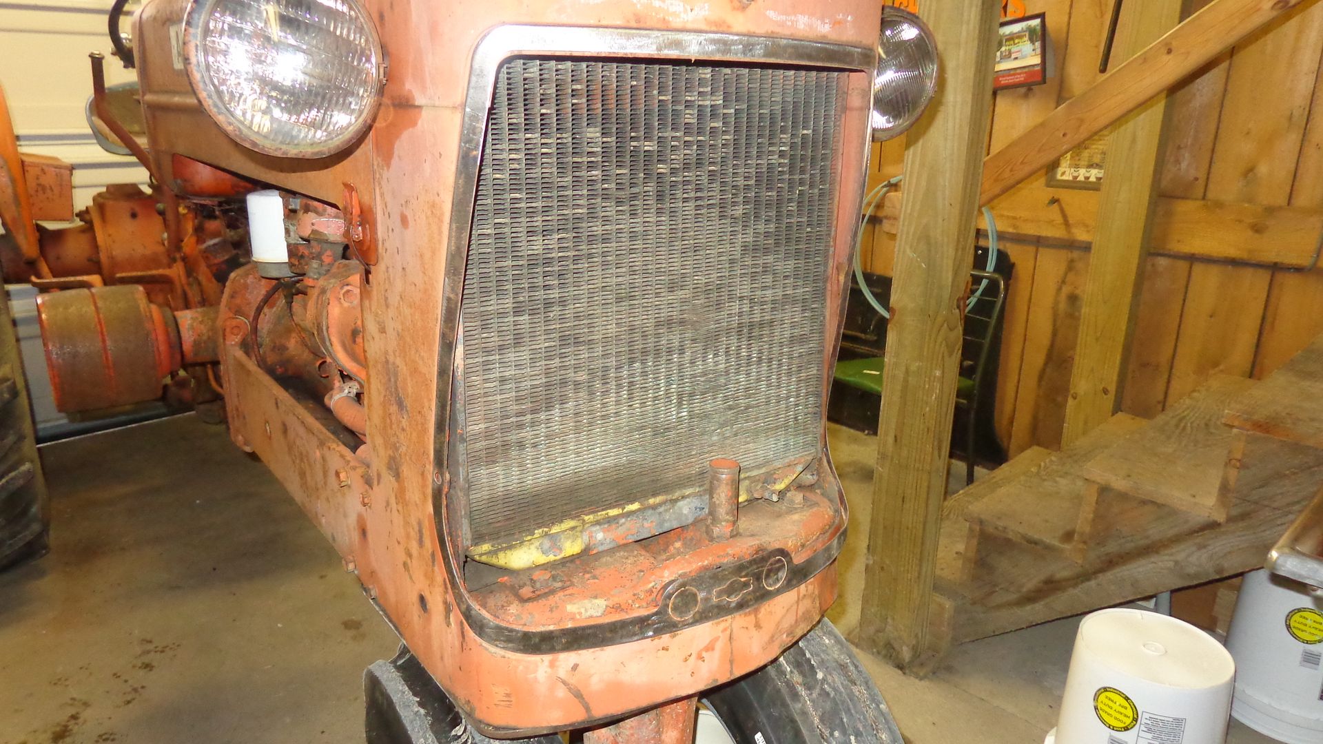

Folks,

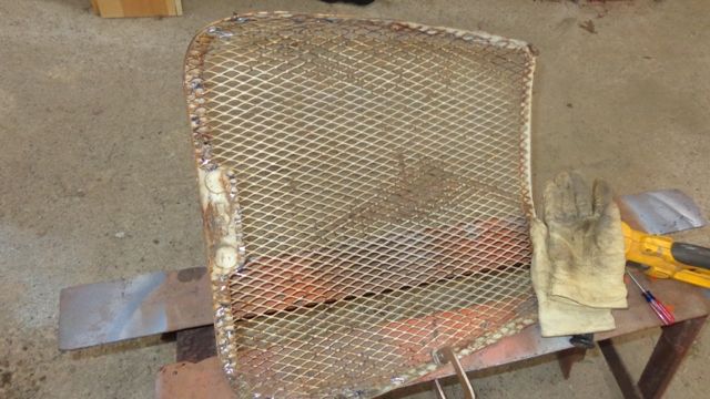

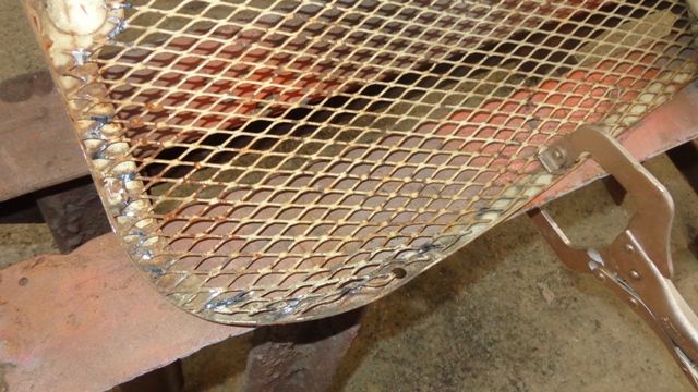

I have been doing some little things. Minor cosmetic issues.

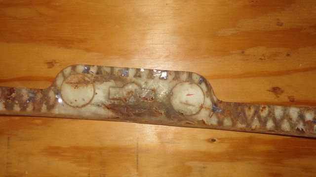

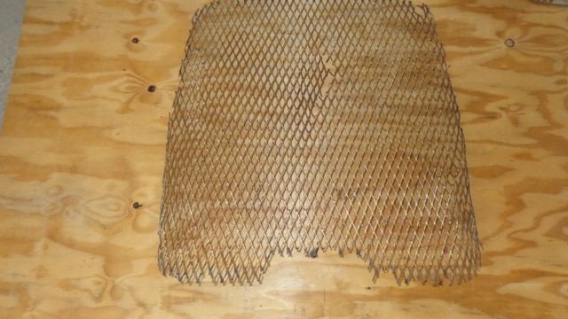

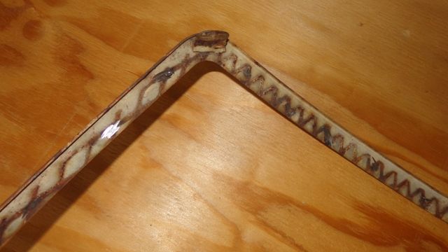

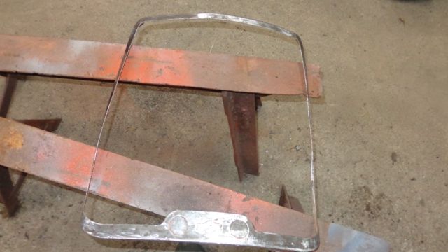

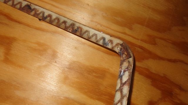

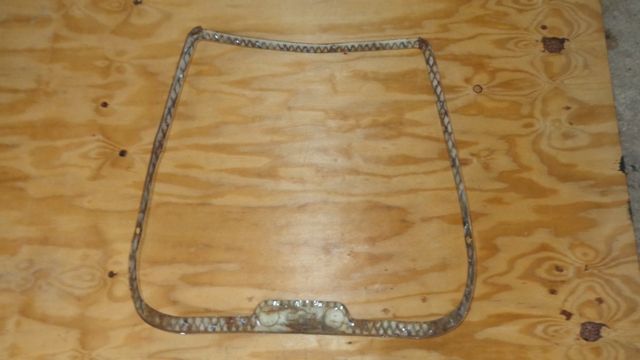

The grill mesh screen had been damaged several times. This looks to be a replacement grill at some point since it is cream on the inside also. And I believe that these 1958 models should have been PO#1. My plan is to go to my local steel dealer and get some expanded metal to match.

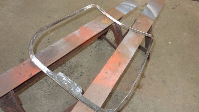

Grinding off the welds that held the old screen. Kind of like surgery with a chainsaw. Must go carefully.
Frame is free at last.
Expanded metal size is 24.25 inches across by 21.5 inches top to bottom. Just in case you have to do one of these:)
Frame shined up and the dents and dings improved with some hammer and dolly work.
This is a very delicate piece. Will have to be careful during new screen fit up, to get the correct fit on the tractor!

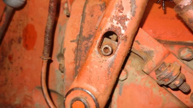

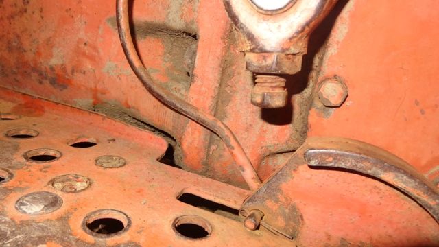

OK on to a couple other questions:

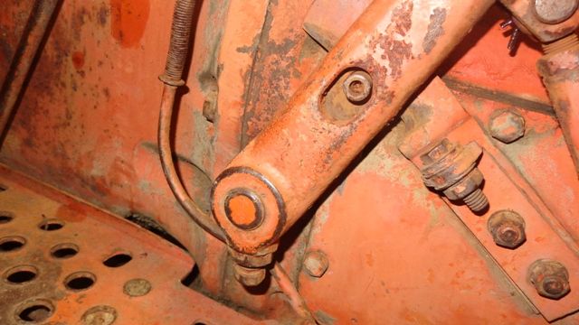

Is this brake rod the correct shape?
Just seems a little awkward to engage and disengage?
On the PD lever there is a cross pin that moves with the thumb control.
It moves to far towards the tractor center and bind the PD from going into High range.
 I think the PD lever will have to come off and it will have to be adjusted?
Pin in down position:
Cross pin in up position

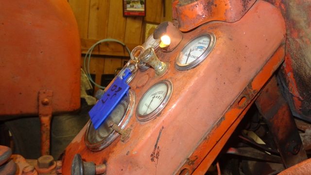

On a positive note I pulled out the light switch (second click) and had a gage light working!! Wahoooo!:)

Pulled the power director handle off the D17 and tweaked the rod that pushed down the cross pin. Bent it to apply some constant pressure outward to keep it from binding on the trans housing. Lubed up the moving parts and reinstalled. This should stop the binding going into high range.
Took the headlights off after checking that there was power to the terminal block behind the rad. but the lights had internal wiring problems. Pulled off the lights and proceeded to pound out the damage inside the bucket. Some welding will be required then clean up and may need new lights. These are about 5-5/8 dia lights (i think they are bigger than a WD headlight. Head light rings had some dings and dents removed too.
Checked the buckets back on the tractor and the straightening pretty much took care of the cross-eyed look:)

The dash was a mess, I built a new one of those. The wiring was a mess, I thought I had that figured out, I gave up on that a few nights ago and decided to just run all new wires. I did that on my D17, I should have done it on this one to begin with. Old wires get brittle and broken and don't carry current very well.
The seat pivots were worn, the steering was worn, the drawbar mounts were worn. I turned out new pieces on my lathe and have those all tightened up.

Have welded up the rusted holes in the headlight buckets. Welding rusted areas is always a challenge on thin metal.
I will try to get some pictures of the grill repair as it comes together. Test fit the screen to the frame tonight. (its going to be cream, sorry:))
Opened and cleaned the power steering fill port/vent and added a quart of ATF.
Found a new small leak of antifreeze from the head gasket near the rear left side.:(
