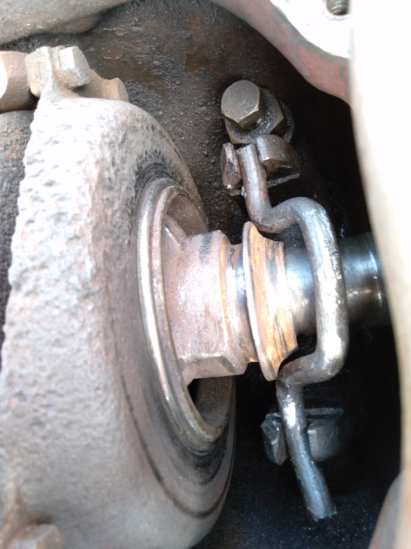

I bought this WD-45 knowing that it had hand clutch issues. The bronze shift collar broke and the guy tried to farmer fix it with that bent round piece, but it didn't work and caused a bunch of wear on the fork arms and the throwout part that pushes on the clutch. I don't recommend trying something like this.

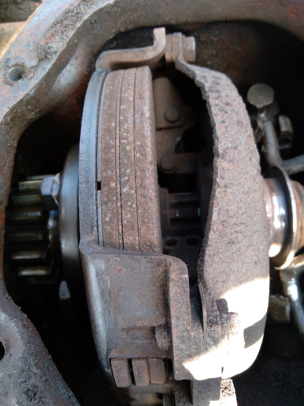

I was going to replace the bronze collar and the worn throwout part with a spare one I have, but then I got to looking at the clutch pack and it's down to a few shims left, plus the 3-disc spacer. The rear disk looks especially worn. What would you guys do - replace the rear disk or find a good used 3-disc clutch assembly?
I'm planning on semi-splitting with threaded rod in the rear end/frame rail holes it per the knowledge base thread on here. I'll be replacing the parts I mentioned above plus the hand clutch shaft seal, belt pulley seal, transmission gasket, and hand clutch handle bushing since they're pretty sloppy. Might have to replace the shaft that handle rides on if it's worn too. Anything else I should look at or replace while I'm in there?

The rear plate does look thin. Never saw a rear cover look pitted like that. I would replace the brass collar and hub along with rear plate. If rivets are good In other plates. Replace spacer with new shim pack and it should run a long time.                       MACK

Thanks Mack. Sounds like I should probably wait to order anything until I have the tractor split apart and can take the clutch apart. If the other plates look rough I will source a good used clutch. I got to looking at it closer and 2 pins are missing in the little cam arms inside the clutch, too. I should probably track those down before they jam into the PTO drive gears, if they haven't already.
This is my second tractor that has had a pitted rear hand clutch cover. I think what happens is they sit for a very long time somewhere with moisture or a lot of condensation cycling inside there, and the rust seems to eat through that rear plate much faster than the other components in the torque housing. Also doesn't help that the oil had been drained.
