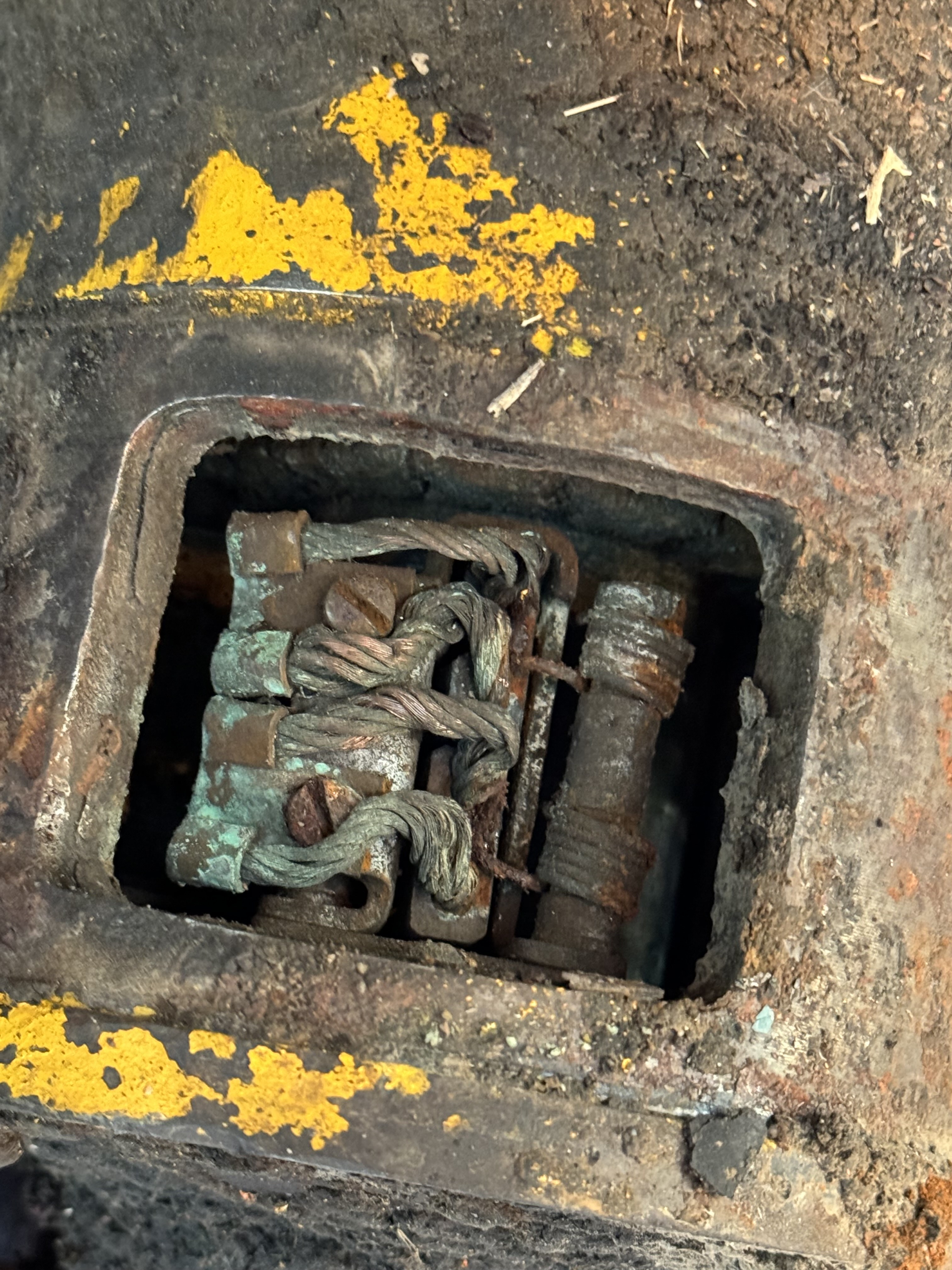

Thanks for the encouragement. Yes, flexible and have the necessary socket extensions and universal joint adapters. I spent some time with the service manual today and it appears there's a band around the starter that, once removed, allows access to commutator and brushes. I plan to remove the band this weekend and do some gentle cleaning. If I can get some 600-800 grit looped around the commutator, I should be able to clean it up.

You would be much better removing the starter from the engine and taking it apart than trying to "burnish" the commutator segments with it in place. It is probably a 40MT series starter and they are a bit heavy and awkward to handle so be prepared for about 35 pounds of dead weight once you start removing the three fasteners retaining it to the flywheel housing. There are both four brush, and eight brush variants of this starter and both work the same and on a bench the commutator and brush faces and commutator segments are easily cleaned up. At the same time when the starter is removed, take the solenoid apart also and address both it's contacts, and copper ring as these burn and carbon track with usage. They can be the source of no starter engagement but if you are getting no response at all, and you prove voltage coming from starter switch, and grounds are good, this is where to look first.
I've done a lot of these myself but anytime I pull a starter or alternator anymore it goes in for rebuild. I don't have a growler for testing, and cannot cut a commutator for proper segment depth so this is best left to someone in that game. There are two or three different sizes/styles of bushings in both the starter nose housing, and end plate and these should be evaluated as both wear with use. I've found many times over the years it can be difficult to beat someone at their own game.
Should you decide to do this, (and it's easy generally) do not use emery cloth for your abrasive. It is conductive and can cause things to go haywire as it's electrically conductive. Use either aluminum oxide, silicone carbide, or flint paper to clean your electrical components. A good spray of electrical contact cleaner to rinse away any filings is always good too.

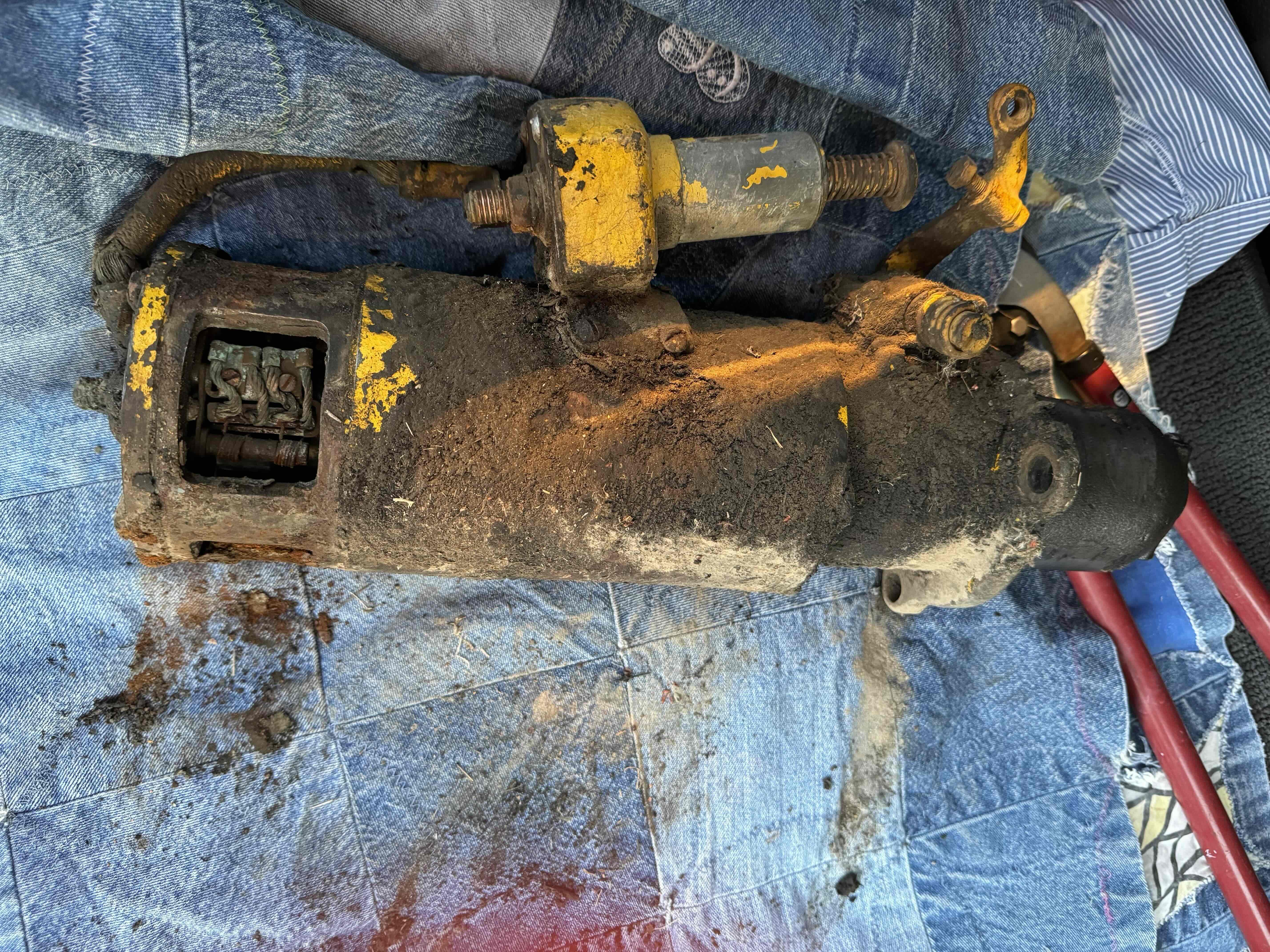

Thanks everyone for the feedback. I can now answer my first question... it's not possible to reach the 3rd bolt on the HD9-B's starter from the top. Thankfully, it was straight forward to pull the belly pan below the engine and access that third bolt - and the associated nut behind it! Oh, did I mention I don't like spiders?
The starter is corroded and frozen so it's time for a rebuild from a pro. I had more than my share of fun removing it.
