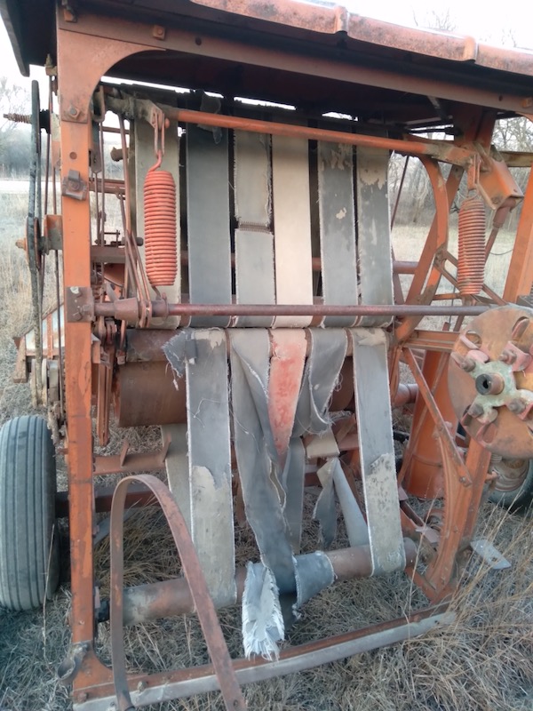

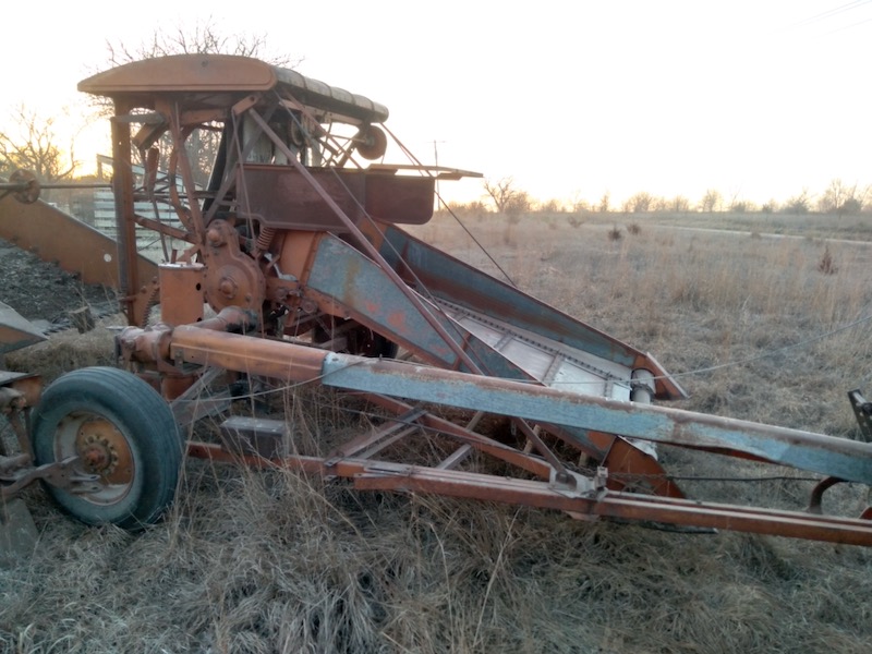

I've always wanted a Roto-Baler. What do I need one for? Not much, but maybe I can put up a few straw and hay bales to have handy. This one dates to 1954 and is going to be further down on the project list for now. The belts are trash.
The cheapest belts I can find look to be about $700. Two questions:
1. Are there any specific expensive/difficult-to-repair trouble spots with these that I need to check before I drop $700 on belts? I will be sure to make sure everything is freed up first including the brake drum. I'm surprised how many things do still turn freely.
2. The rubber on the press rolls is old and cracking. Is the main way to address this to send them out to a company that redoes the rubber (I'm thinking of companies that do crimper rolls for mower/conditioners)? Or, would you skip that for now?

From my experience with Roto-Balers the rubber parts have the most deterioration. If you were to find a NOS press roller, you'd be surprised how worn down the one on your baler is. When in use the twine knife MUST be razor sharp. Also the proper tension of all the springs is needed for correct timing on all the adjustments, just using cheap hardware store springs will give you no end to grief if they aren't close to the proper size and tension. The latch plates on the roll arms must have good shape edges to consistently latch every time.
  At one time Gary Agrisom was selling a spring kit and a new knife. He may not be diong that any more.
  As finding good Sisal twine was getting nearly impossible, I made a larger twine can and tightened the twine tension and was using plastic 20,000/110 large round baler twine. However finding good plastic twine can also be a challenge. I had some that didn't cut well.

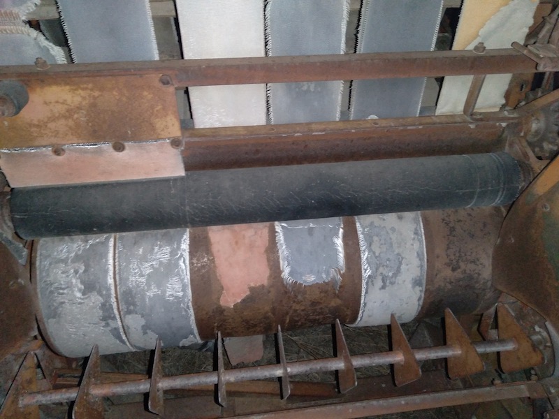

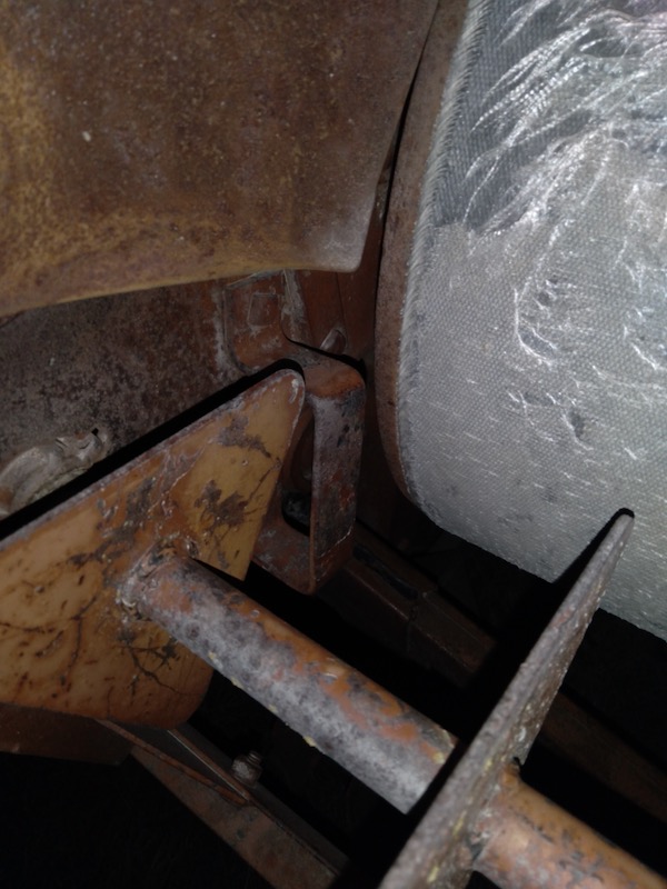

A few more pics - the front press roll is the one that is most obviously rough. I found a few places that recondition these but I haven't called yet to see what that costs.

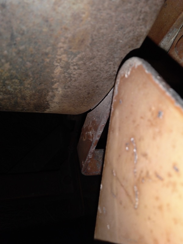

The main drive roller has been rubbing for a long time against the LH side and has grooved the bracket right next to it.
RH Side has a decent gap so I'm guessing something is worn out in between. Maybe I can shim or adjust it back into center.

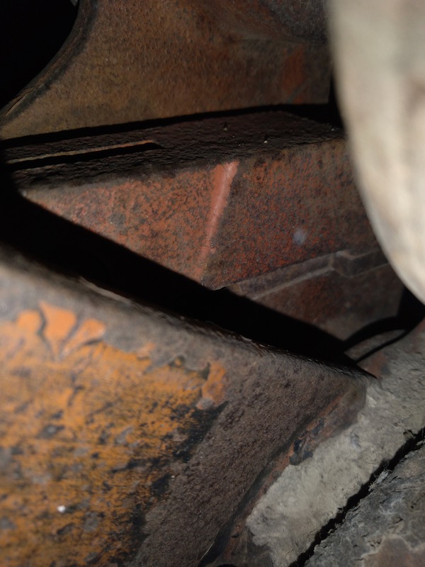

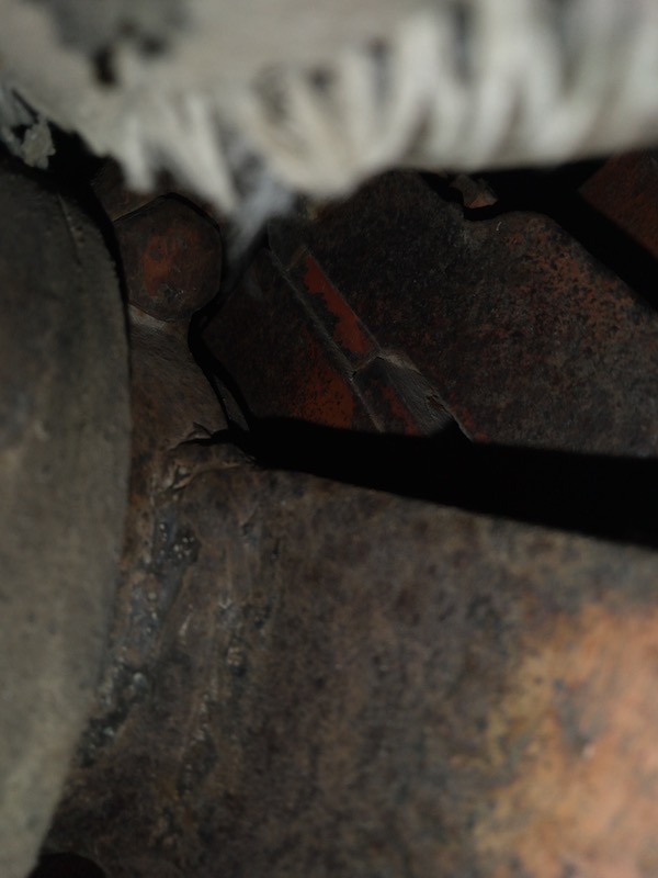

PaulB here are the pics I could get of the latch plates (learned what those were today - thanks for highlighting that I should check them). They seem to have sharp edges still but I may need to pry them open to fully inspect them?
LH:
RH:
Points: 5274
Post Options Post Options   Thanks (0) Thanks(0)   Quote PaulB Quote  Post ReplyReply Direct Link To This Post Posted: 28 Feb 2024 at 6:33am
Opening the rear belts is easy when you remove one end of the large springs at the rear and trip the latches.
  When you contact Gary Agrisom see if he still has any of the repro aftermarket twine wrap guards still available. This kept the twine from contact with the press roll until the twine arm moved a bit.
