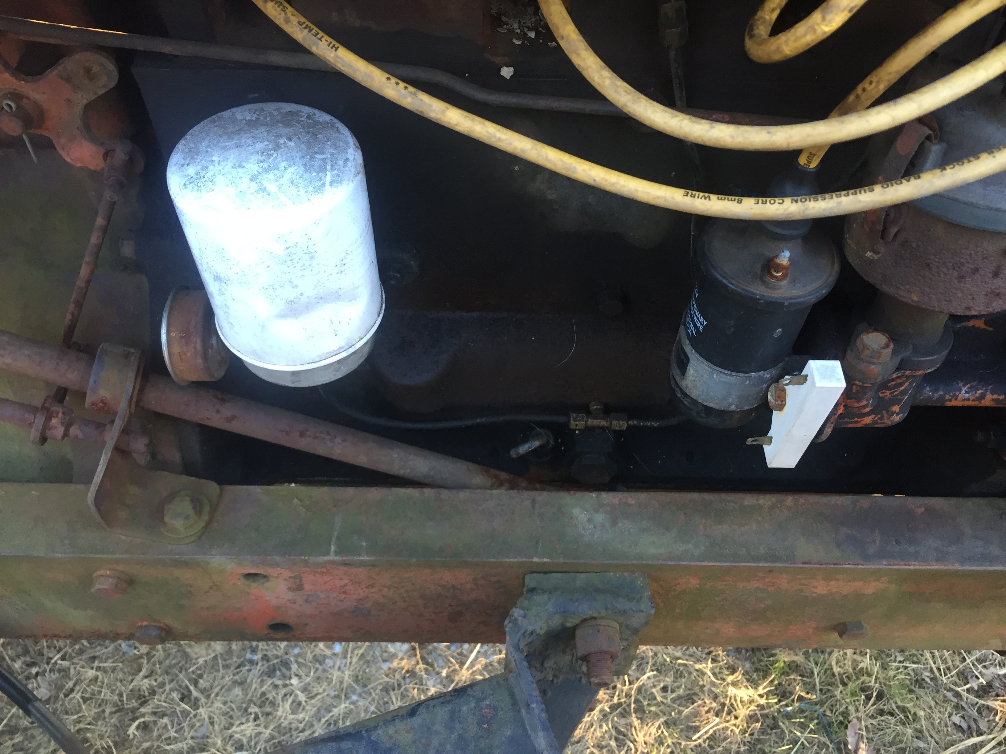

I bought a 1953 WD45 with a loader it ran when I bought it I cant seem to get it running now. It sat all winter and now I want to get it running and get rid of it. I Need to rerun all the wires from the starter, resistor and I think the coil. Is it possible to smoke either the resistor, coil or starter by constant cranking. any help would be appreciated. thanks I will try to post pictures

The tractor turned over strong then it started then I shut it off and tried it again and it would not fire. Then when I cranked it more it got weak then would not crank at all I thought it was a dead battery but when I put the charger on it said the battery was charged, I don't trust the charger. This was all before it sat. Does someone have a wiring diagram for the WD45. The goats trashed all the wires, little buggers. Would I be able to pick up a new coil and resistor at auto zone or is that a specific part for the WD45. The previous owner had the wires ran all willy nilly I had planned on redoing them anyway to neaten them up so they could not be ripped off. I will get new switches too. I plan on tearing into it first thing tomorrow morning, going to put the battery on the charger now.

can anyone recommend a coil that is available from napa, auto zone or advanced?
I took the coil, resistor battery and carburetor off I'm going to clean it tonite and then put it back in tomorrow morning before the stores open then make a parts run.

I replaced coil, resistor and battery now it cranks but it has no spark at the plugs.

Do the points & condenser
You do have electric to the coil

Run a jumper directly from the battery to the coil if you have spark now start looking at your wiring if not it's in your distributor. Are you sure the points are set corectly
Post Options Post Options   Thanks (0) Thanks(0)   Quote CTuckerNWIL Quote  Post ReplyReply Direct Link To This Post Posted: 19 Mar 2018 at 9:26am
First thing, turn the ignition to the run position and check for battery voltage at the coil. If you don't have battery voltage there, you have found the problem.
 If it were mine, I would pitch the resistor. Buy a 3 ohm coil made for any 4 cylinder engine. The one I have on the 45 was on a shelf at Farm and Fleet and listed for a Volkswagen.

I Ran a wire from the battery straight to the coil and resistor and now I have spark. sprayed some starter fluid in the carburetor and it started sputtered ad stopped. this is with the gas on, I checked the gas line and it was not plugged up. I cleaned the carburetor when I started this project. should I clean it again?
