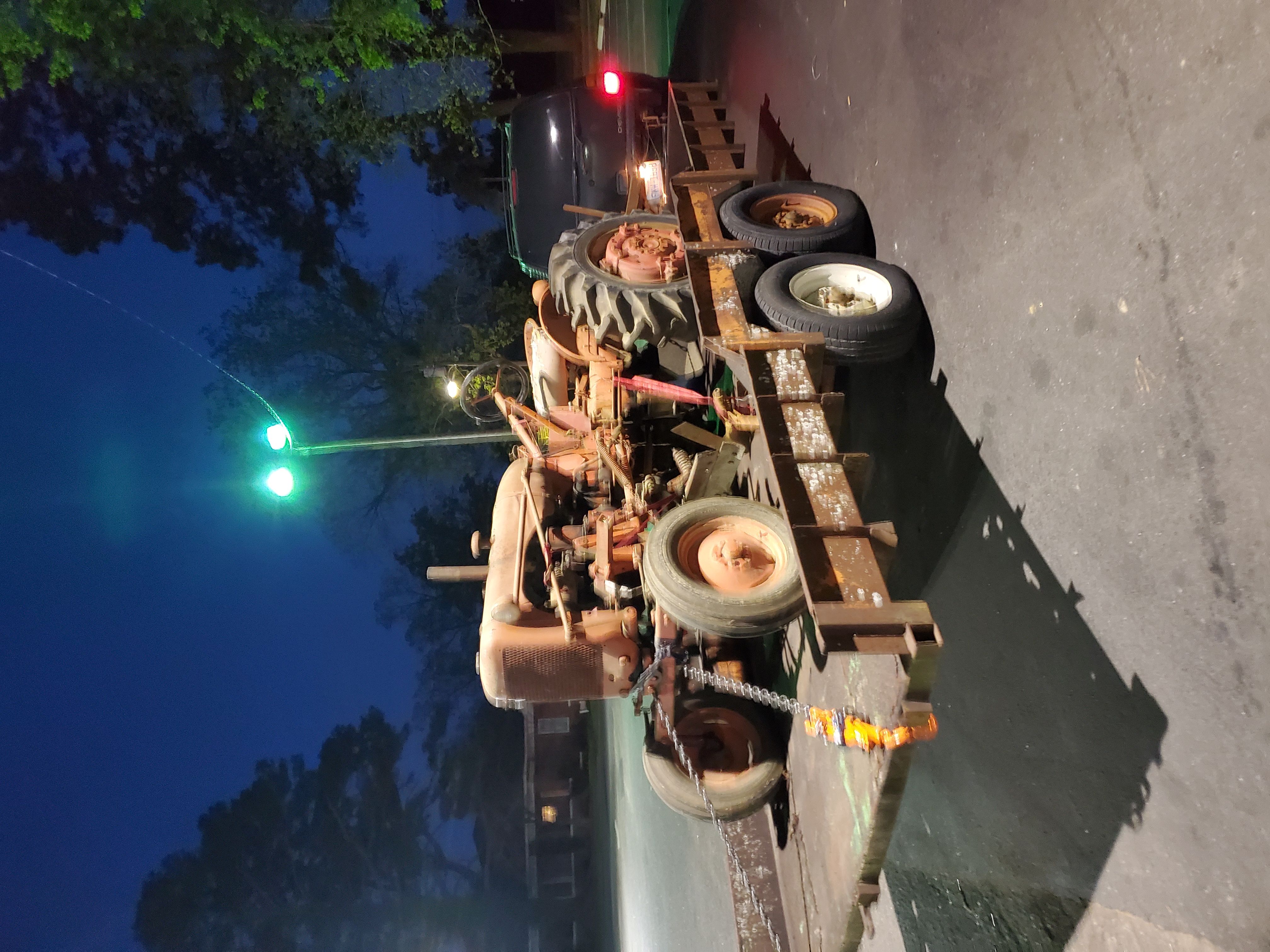

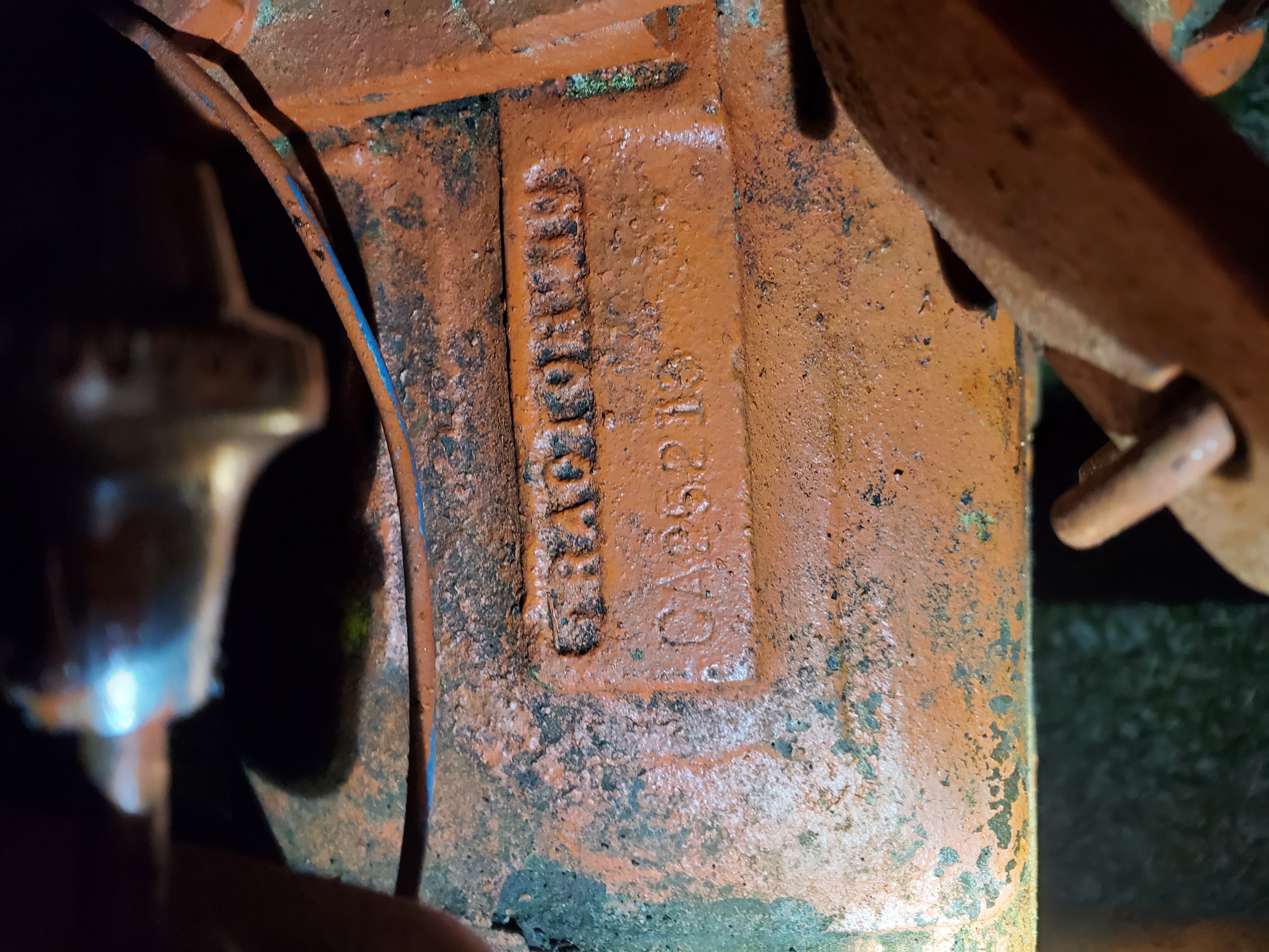

I inherited what was believed by my wife's grandfather (deceased) to be a 1949 AC model B. After getting the tractor home and researching the serial number I believe it's a 1953 model CA. (CA25213). I got the tractor with all the sweeps etc, planter, disk, double plow, side dresser the works. It hasn't been ran in 3 years so from the top I drain the old fuel, cleaned the bowl, replaced the battery, and cleaned the points. The tractor will not start by battery or by hand. The new battery won't even get one revolution out of the starter. I took the starter contact apart today and cleaned it up and put it back together. Some better but still not turning over completely. The tractor isn't locked up as I can turn the engine by hand. I'm also not getting power to the coil during ignition process. Any ideas or recommendations? Thanks. Btw yes it's still original 6 volt.

Wow, that’s a nice solid looking old CA to inherit.
They are great tractors.   As far as getting it running, I’d try to repair the starter first, remember to clean all cable connections to bright and shiny, might even be a good idea to replace cables. You can remove the starter with one bolt after disconnecting the wiring to it, make sure the starter is getting a good ground and the inside of the starter hole and bolt and housing is clean.   Could also pop off rear cover and check brushes, but at least clean the grounding areas.
You didn’t say whether distributor or magneto, but sounded like a distributor, if distributor and coil isn’t getting any power, probably in the wiring or switch, also remember on 6 volts if points closed there may not be but a couple volts there, not 6.   You can run a jumper to coil from negative side of battery to side of coil not connected to distributor, if it’s still 6 volt negative ground. Then you can try to crank it like this or repair wiring to it. And recheck spark.   If Magneto ignition, the one wire to it either sends ground or ungrounds it , unground it to run.
After a few years of sitting you will probably have to remove carb and clean it out real good or rebuild it, you can usually just clean them real good to start if you just want to hear it run, and check gas flow through carb by removing plug in bottom of carb and making sure it runs a nice steady amount through it for 30 seconds or so.
You could put some oil, not much in each cylinder to help lubricate things and build compression.   Remember once you get spark and fuel, and compression to it you could pull it off with another tractor or truck, sometimes they need that the first time you get them back running especially if you can’t get the starter working any better than it is now without sending it out for a rebuild.   I’m sure you put new gas in it too, and inspect oil for condition and for coolant In it.
Try a couple of these things and check back with us, a CA is a great tractor and you have several pieces of equipment with it a huge bonus.
Good luck with it

Great looking tractor.....way more tractor than a "B"!  Is that a grader blade that has been somehow affixed to the cultivators?  If so, that is quite innovative!

Yes that is indeed a grader blade that he made and attached. He was always tinkering and coming up with something. I am spending some quality time with kids before having to start back on 3rd shift, so I will try these things as soon as I get a chance.

That one's way nicer than the '52 CA I just dragged home. Keep us updated as you get time to work on it.
