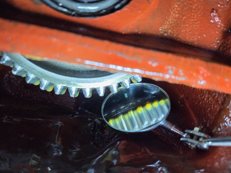

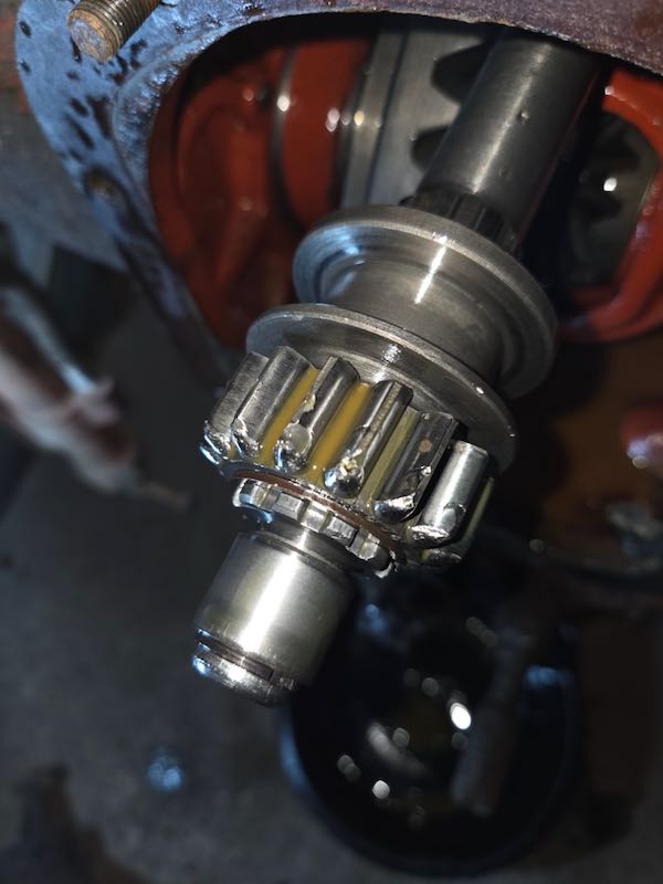

Got the carb off and the starter out. The carb had definitely had some gas dry out in it. The float was half full of gas. I think the threads for the main jet plug/adjustment needle assembly are trashed... they look stripped and there was a bunch of thread tape crammed in there that ended up everywhere. It's interesting that this carb has a main jet adjustment needle. Per the parts catalog and my other CA it should have a plug. I may need to make sure all the jets are sized properly if parts were getting swapped around. The main jet itself had no gasket on it when I removed it. I think someone probably cleaned this up for the auction just enough to get it running after it sat in the guy's collection for however long. Worst case I should have another carb bowl with good threads for the main jet plug/adjustment.
The starter pinion looks great. The ring gear... not so much. I am actually wondering if this tractor was never converted to 12V and someone slapped a new 12V battery in it before the auction. Will need to dig into the electrical more later to see if that's why the starter is slamming it so hard, and replace that ring gear or stick with hand cranking for a while.

most tractors converted to 12v just had a battery change.. They are still using the original  6v starter and ring gears... I have several that way..

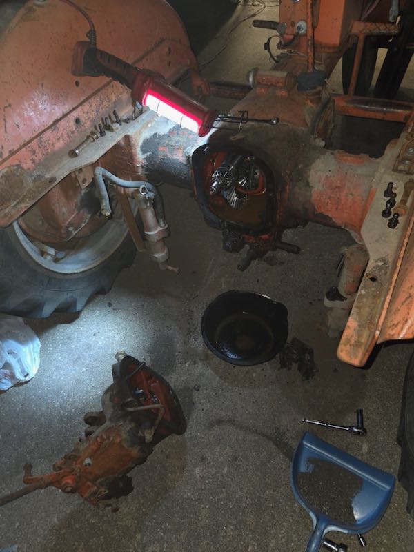

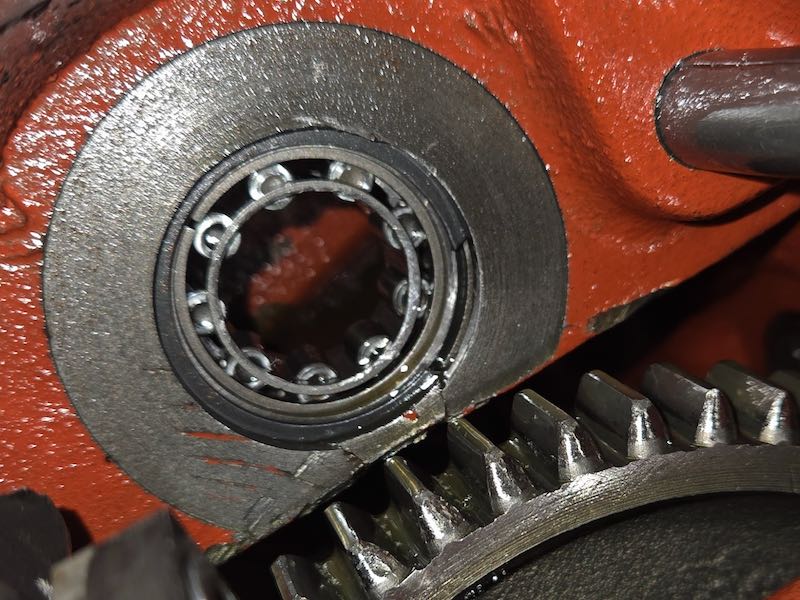

I got the PTO/BP/Hyd housing off today.
The sliding drive gear on the main shaft has experienced some trauma - maybe just from engaging the PTO with the clutch still engaged.
The casting is cracked around the rear bearing for the main shaft. I'm guessing a chunk of something wedged between the gear and the casting. I also wonder if the bearing race is cracked... Didn't notice that earlier, but looking at the picture it sure looks like it. I may have to tear this down.
Okay, the moment you've been waiting for, Les... The reason for the belt pulley shaft not spinning. I struggled to get this not so great picture, but the gear teeth for to drive the BP on the big double gear are gone... Someone intentionally ground them all off.

Post Options Post Options   Thanks (0) Thanks(0)   Quote wjohn Quote  Post ReplyReply Direct Link To This Post Posted: 2 hours 7 minutes ago at 11:22pm
I can only figure that someone didn't like that shaft spinning when they had the PTO/hydraulics engaged, or more likely they trashed it somehow and went in and cleaned what remained of the teeth off. I suppose a belly mower hitting something solid could maybe do damage to those gear teeth? You'd hope a belt would slip, but that's all I can figure. There is no pulley on the shaft so maybe someone had a belly mower and v-belt pulley on there once upon a time. There was a C at the same auction that did have a v-belt mower pulley on that shaft.
I plan on planting and cultivating with this tractor so the belt pulley doesn't matter to me. I might do some PTO work with it eventually since I do have a sickle mower for it. I definitely need the hydraulic pump to work. I am tempted to replace whatever bearings are needed, clean up any high spots on the damaged gear teeth, and put it back together. My other option would be to steal parts out of one of my other 3 CAs (all currently non-running).
I am going to pull the side cover off the transmission next. Turning the mainshaft by hand still causes the wheels to move more than I think it should even with the gear oil drained.
