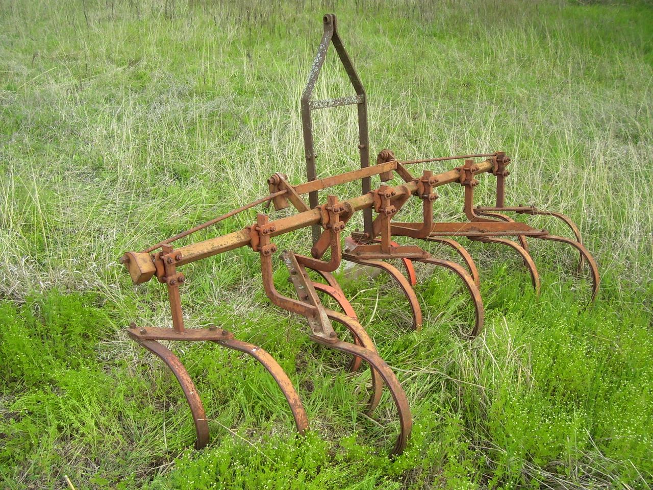

I just picked up a WD field cultivator from a forum member last weekend as well. I'm hoping it'll be perfect for knocking out some spring weeds while ignoring a few rocks in my fields.

Good looking cultivator! I have never seen on like that.

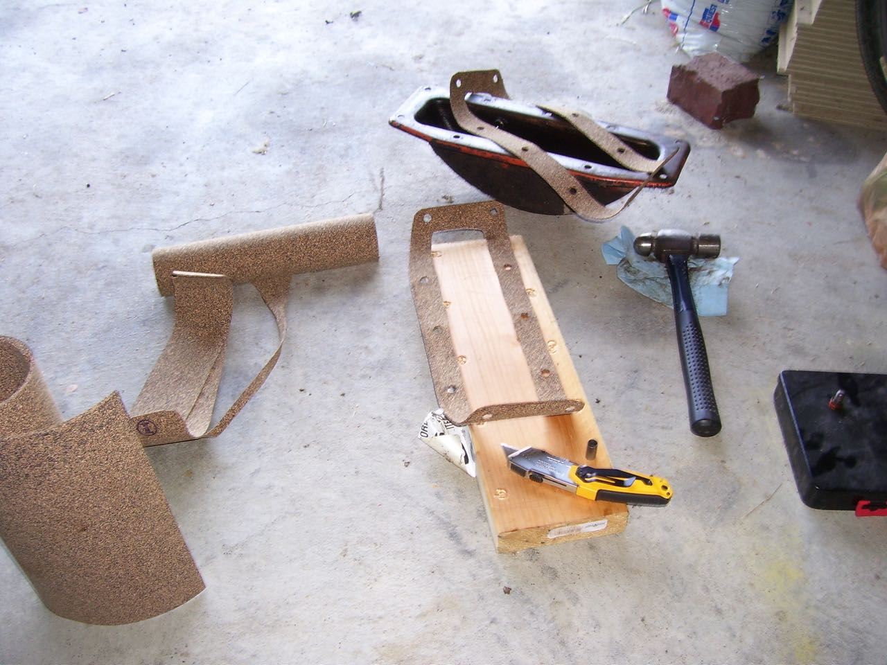

The oil leak at the rear of the engine was mostly coming down the inspection cover. Took that off and the flywheel appears to be a little oily. I had not too high hopes that only the pan gasket was leaking but I'm pretty sure that the rear main seal is the main issue. It was leaking slowly when not running, and leaked a drop every 20 seconds or so when running. I'm not sure if I'll pull the engine to do the rear main seal now or wait until winter. There's a leak up toward the front of the engine somewhere too but not nearly as bad.

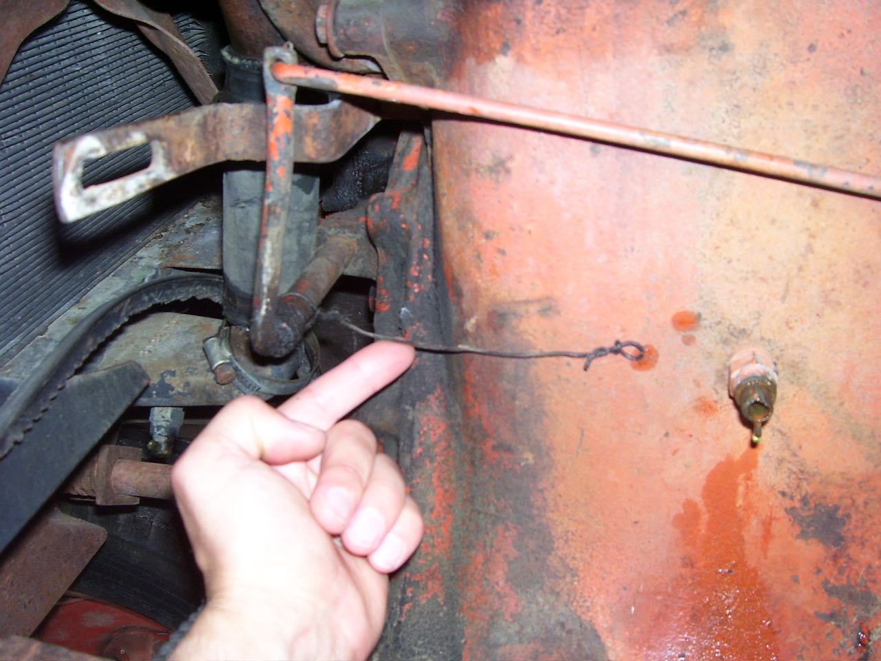

Anyone know what this mystery wire could've been for (second photo)? It's just hanging off the governor shaft tube but looks like it was tied to something once upon a time.

Typical oil leaks on these. I see the clips on the oil pan for the pan gasket end pieces.
My guess on the wire was it hooked to a spring that attached to the carb lever?
Looks like vertical governor lever has been tweeked to adjust the length between the end and the carb.

Good thought. I bet it's for a missing surge spring. I seem to recall Dad's WD had a spring hooked down to the engine block coolant drain petcock, and there's nothing of the sort on my tractor.

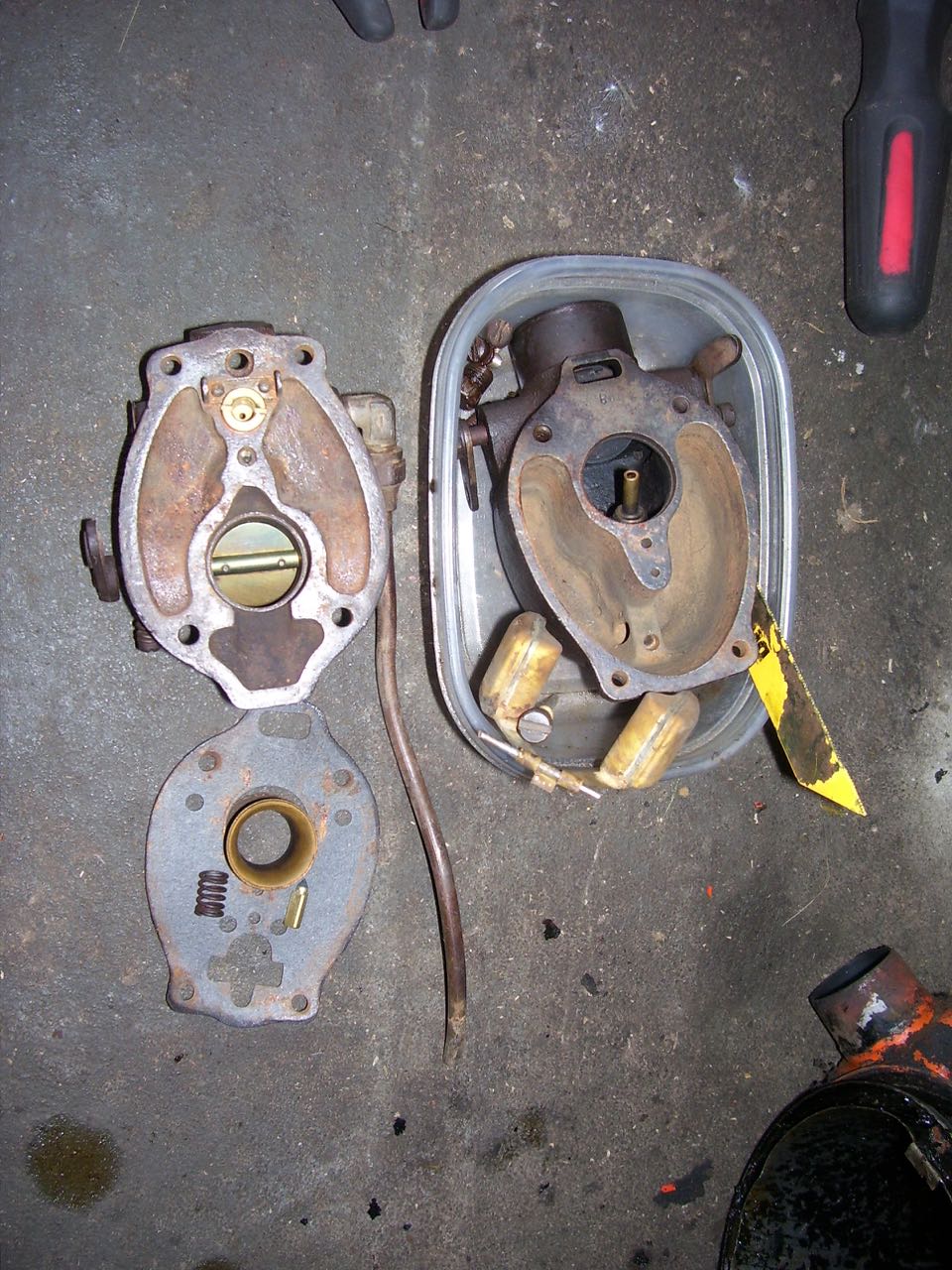

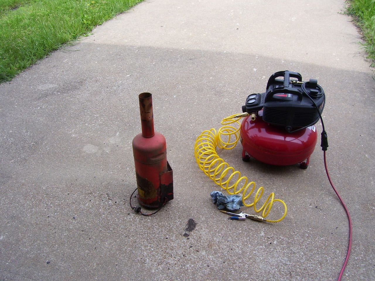

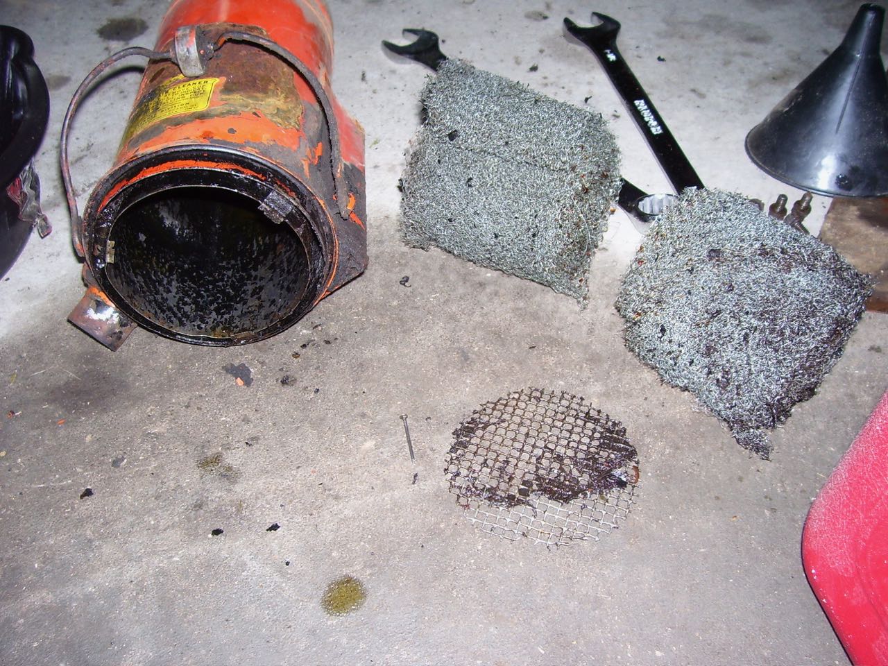

The air cleaner didn't look so bad at first. I tried blowing compressed air through the top and wasn't getting much flow through it, and then I saw the mud dauber nest. There's a pile of other gunk up around that area where the intake tube of the air cleaner transitions into the space between the outer wall and the inner wall that holds the mesh. Not sure if that makes sense but on these air cleaners the air comes down between the walls and is then sucked up the middle through the mesh to the carb. Anyway, it's pretty tough to get to and it's nice and oily, so I finally figured out that I could shove a scrap piece of metal shipping banding in and work the crud loose.
I never have found a good tool for screwing/unscrewing the needle valve seats in carbs. This old reciprocating saw blade works okay but could be a little stiffer.
Points: 8661
Post Options Post Options   Thanks (0) Thanks(0)   Quote Sugarmaker Quote  Post ReplyReply Direct Link To This Post Posted: 28 May 2019 at 9:13pm
wjohn,
Your getting right into it! Awesome! Yes these air cleaners can have a bunch of gunk in them! Carb doesn't look to bad!

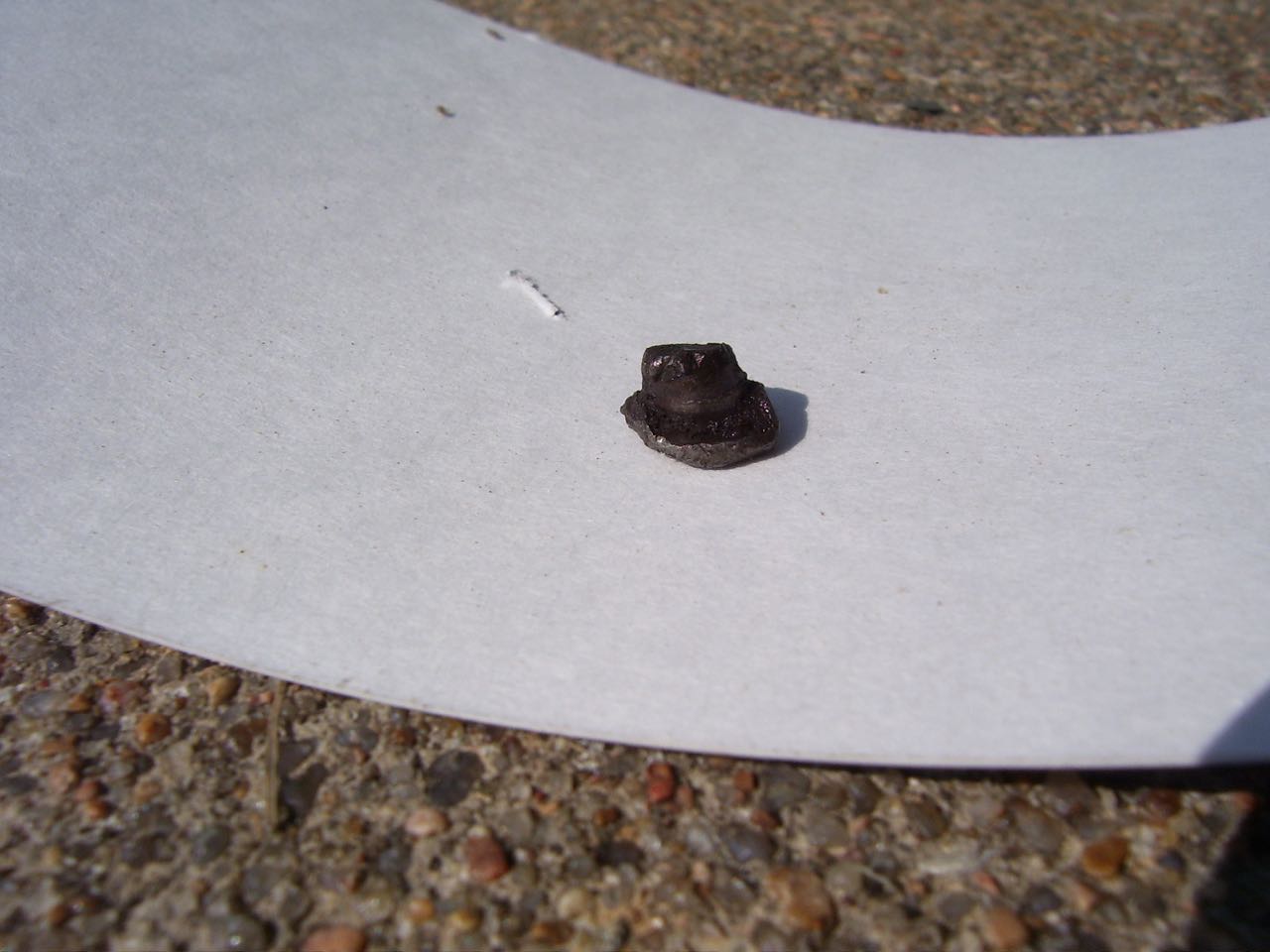

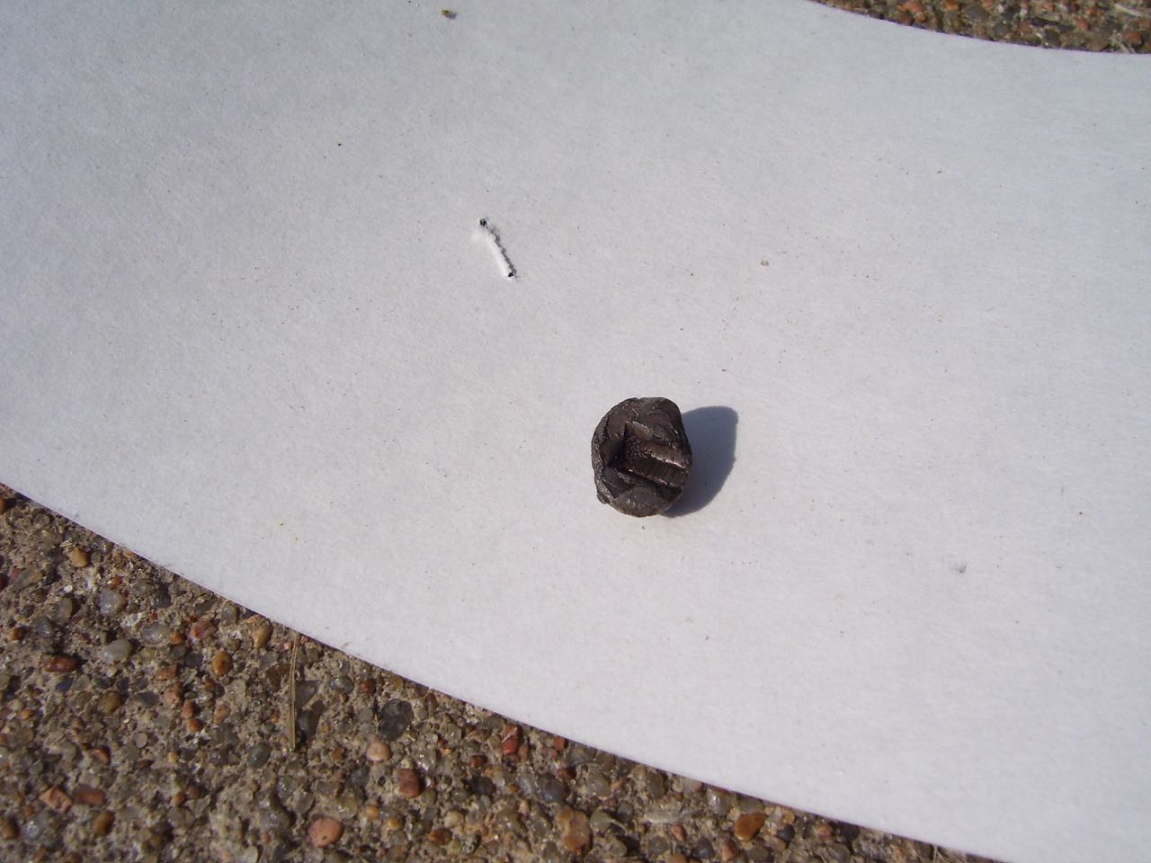

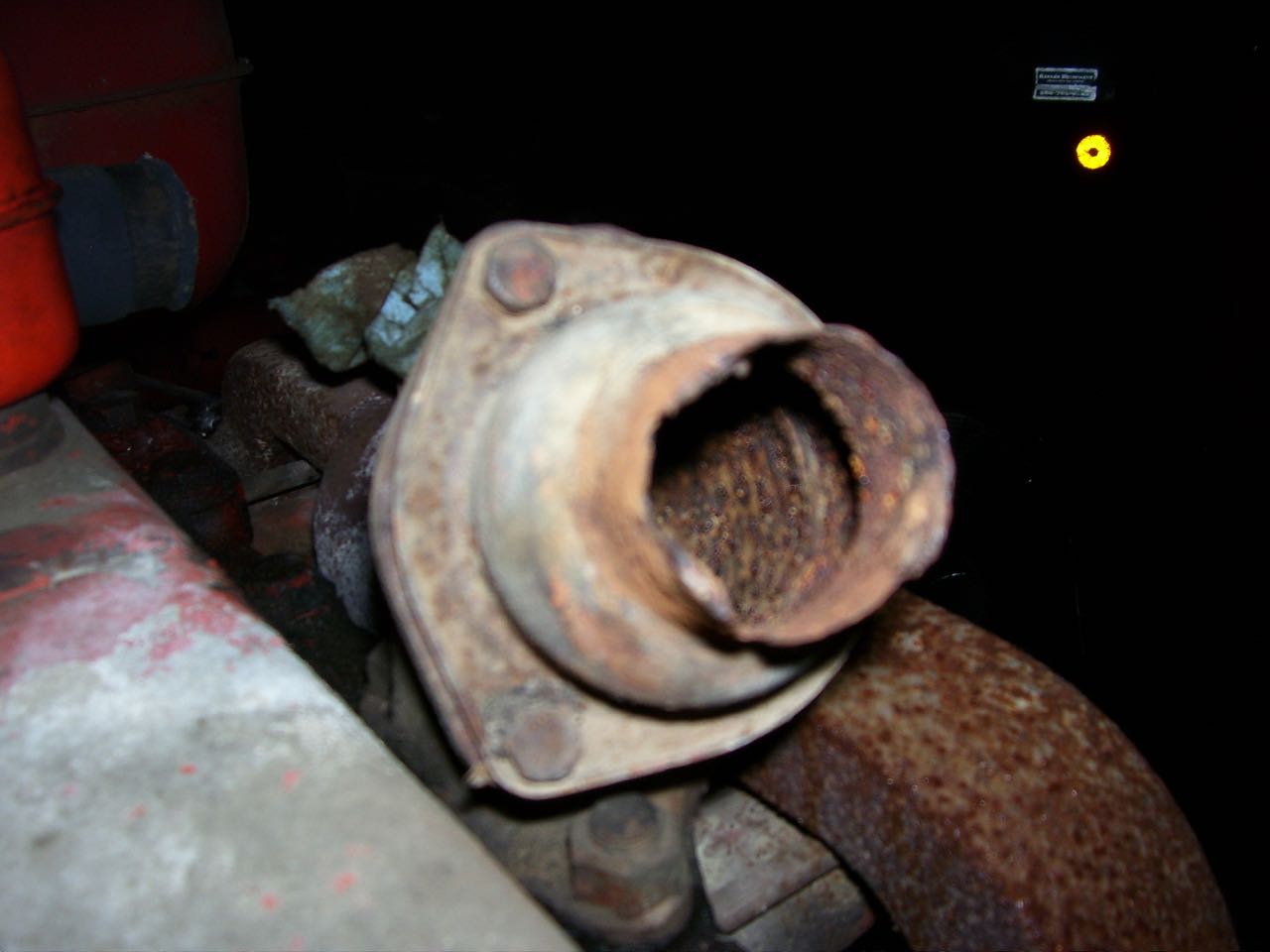

On a potentially scarier note - anyone know what this part is in my pics below? It was lodged inside the cavity in the drain plug for the PTO housing. It's small, round, and sort of mushroom-shaped, like the broken off end of a good-sized nail. Looks like it's been pushed between a set of gears at some point on its journey... The end of some kind of pin, maybe?
wjohn View Drop Down
Joined: 19 Jan 2010
Location: KS
Points: 2392
Post Options Post Options   Thanks (0) Thanks(0)   Quote wjohn Quote  Post ReplyReply Direct Link To This Post Posted: 21 Jul 2019 at 8:19pm
Anyone have any thoughts on the mystery part?

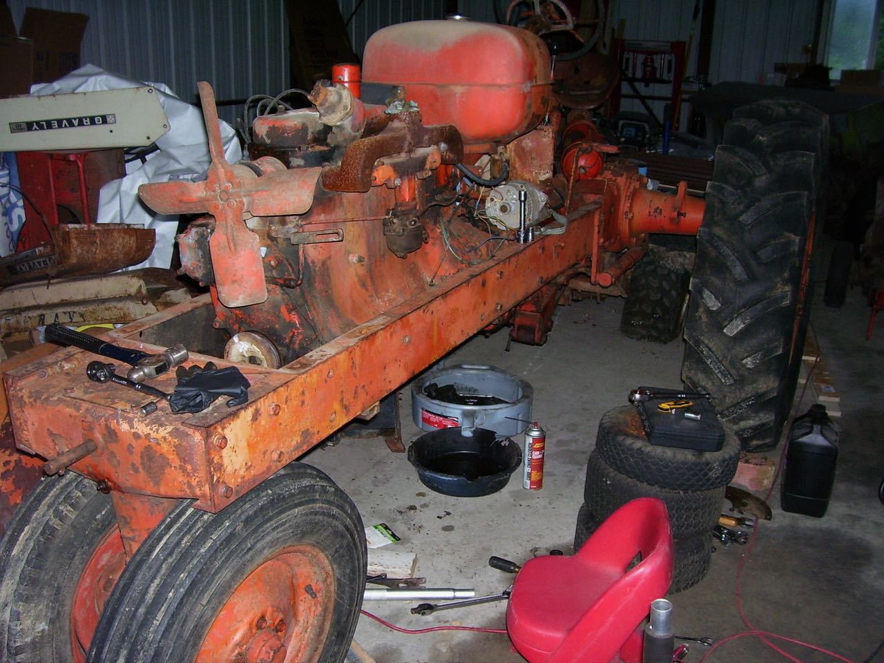

I got the right rear wheel off today. All the eccentrics came loose without much effort, but the left side ones are all rusted/painted solid. I broke off the bolt for the spinout stop and figured I'll have to soak/torch the eccentrics on that wheel someday. The fluid in the RH final drive wasn't as nasty as I expected. It definitely needed to be changed, but didn't seem to have much water or lumpy stuff in it. I made a couple of gaskets and got that side put back together.
Then I moved on to the radiator/grille. Getting to those two larger bolts up under the frame was a pain until I found the perfect combination of extensions... And they still fought most of the way out. It also looks like the rusty thermostat housing was a problem waiting to happen, and there was no thermostat. All I'm seeing for replacement parts are the cast housings vs. this thin stamped steel housing that rusted through.
I spent a few minutes beating on the steering shaft pins and got nowhere, and called it a night. From looking at other threads it looks like I'll have to get the drill out.

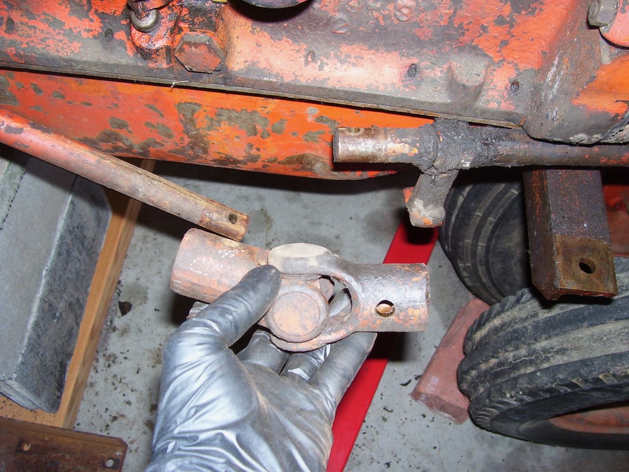

Small milestone: the steering shaft u joint is completely out. I removed the frame rail and the rear u-joint pin came out after some solid smacks. It's really helpful to be able to block it against the engine block so that you're transferring the entire force of the hammer blow solidly into it, instead of into all the slop of the shaft and supports.

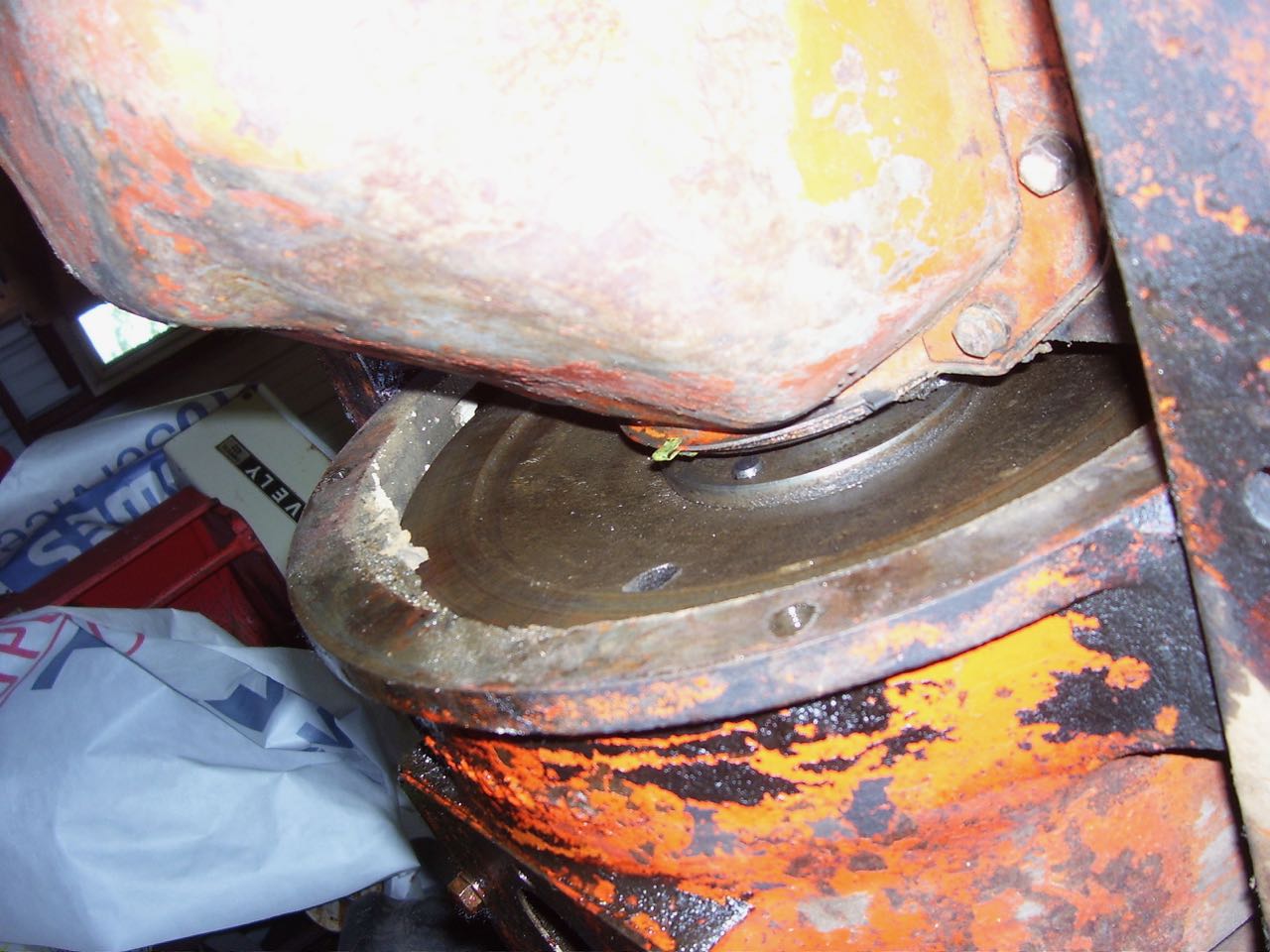

The support around the clutch is totally egged out. It's bad enough I'm not sure if I can oversize it and put a bushing in, but we'll see. The shaft also needs material added in several spots. I may leave that for a project in the distant future. For now I think I'm just going to rebuild the u-joint since I have it out and it clearly has no lube and lots of play. Hopefully now that I've knocked the pins loose once they'll come out easier the next time.

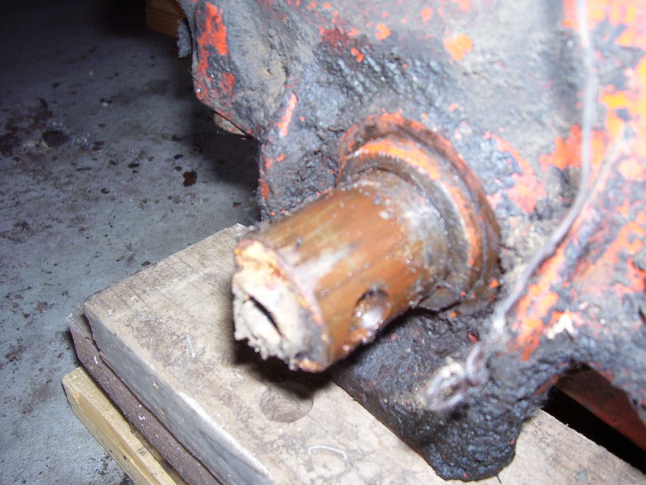

Now onto the pin in the hand crank shaft. I know they're Sugarmaker's absolute favorite, and mine sure didn't want to budge at the end of the day today. I called it a night and made supper.

 I like your documentation: pictures and descriptions! Yes getting something soild under any of these pinned joints is the key to knocking them out. The steering u-joint may be the toughest. taking the frame rail off seems like a pain, but will save you much frustration putting that joint back together. And you now have all those bolts loose in case you need to do this again. Add never seize to the bolt threads.
On that crank pin it is way easier to work on them with the front grill off, which you have done.  I like a floor jack between the back of the tires and a piece of solid steel coming up from the jack to support the shaft. Then you can get a real solid whack on the stubborn cross pins. After changing them 3 or 4 times,  like I tend to do the come right out!Smile
Are you pulling the engine to do the rear seal? Don and I will tell you thats really the best way to fix that leak. Pulling the engine probably not much more work than the u joint rebuild.
By the way I had problems finding the new u joint (cross and bearing for these. Maybe they are more available now???

Great idea pulling the frame rail! Wish I would have thought of that when I did the one on my narrow front. Getting ready to put (Char-Lynn) power steering on the wide front, will pull the rail.
The joint I used in mine came from Napa, box has 861 on it as part no. Here's a qualifier; I had to do some filing on the yokes to get the clips in if I remember correctly.

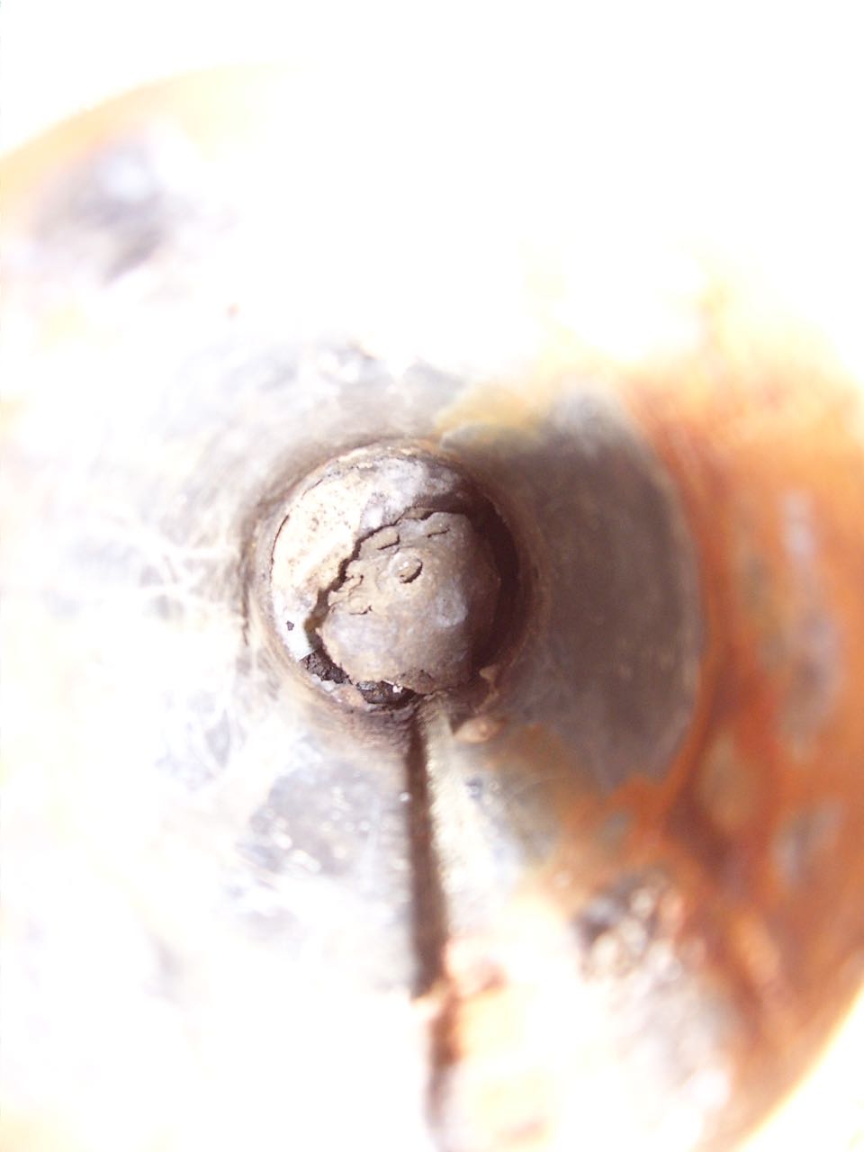

I just got the pin in the hand crank shaft out. I realized I had a 2.5' piece of 1 1/4" round stock in my shop that was there when I moved in, so I tried to figure out how to hold it and hit the end of it... Then realized it was heavy enough I could probably just use it like a battering ram, and sure enough the pin started moving.

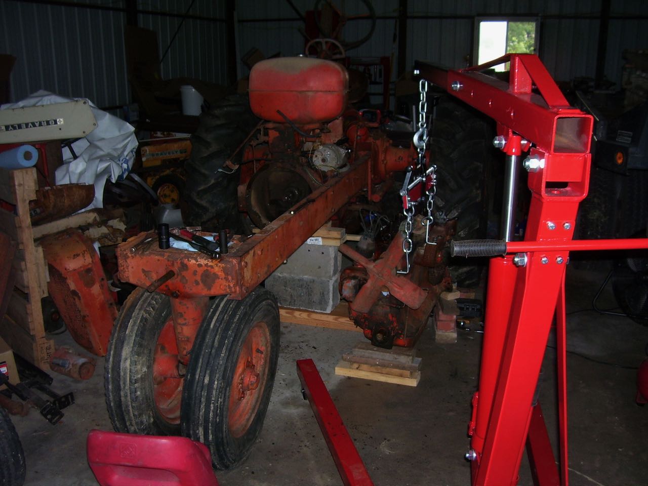

I think I'm ready to pull the engine off now. I don't have a stand so I'm either going to get creative or buy a cheap stand next week, haha. That sure would make doing the oil pan gasket job a lot easier as others have mentioned, so I may bite the bullet and buy one.

Success! Not a big deal to many of you veterans, but I'd never had to pull and engine out of an AC before. I think I'll have to remove the front wheels to get it back in because my hoist was up against the tires and wanted to pull the engine a good 5" forward to hang dead center the way I had it hooked up.
I found a cracked rocker shaft pedestal so I'll need to source a used one somewhere. I'd rather not rob parts off my other tractors yet since I still think they all have hope. The front crank seal wasn't seated all the way, so the only thing I can think of is either it wasn't installed properly or someone was trying to keep it out of a well worn groove in the crankshaft. Disassembly will tell all.

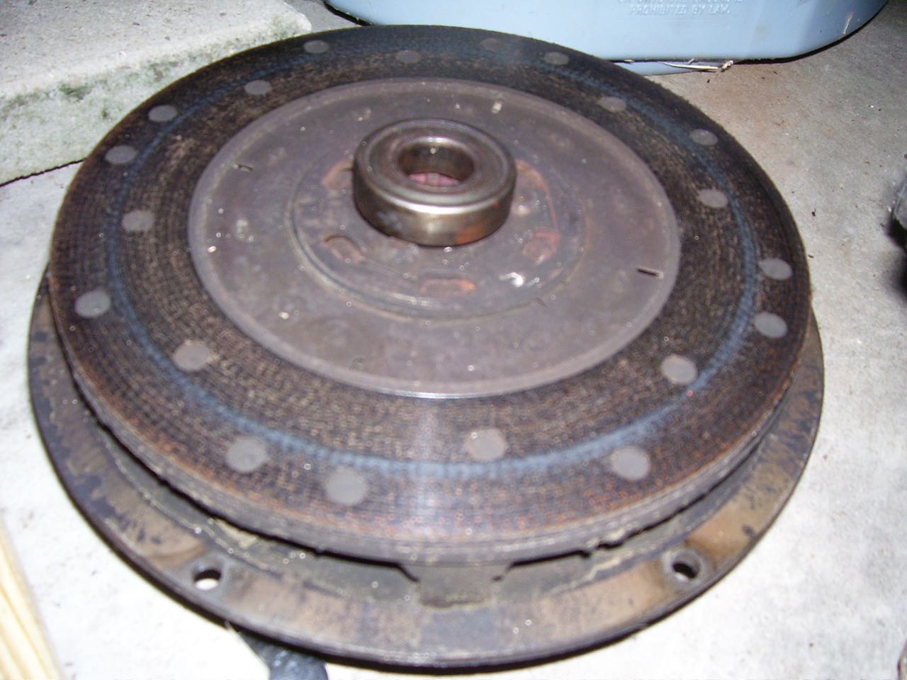

The clutch still has some life left. At least, there's a ways to go before it's hitting rivets. I'll check to see if there's a minimum thickness spec, but unless it's close to the bottom range of that then I'll plan on reusing it. Interestingly the pilot bearing had fallen out (I can only assume it tried to stay with the transmission input shaft during engine removal) and was missing the seal on one side of the bearing, so it didn't have long for the world. There was no lubricant left and it makes a nice loud rattle. Unfortunately I wasn't thinking and the "good" side of the bearing is showing in the pic with the clutch.

wjohn,
I believe I shortened one leg of the base of the engine hoist by the wheels and came in from the side of the tractor rather than the front. While your at Harbor freight getting the low cost engine stand, splurge and get the engine leveling unit too. You will thank me for both when your done!
Your doing good!
That front seal does look like its out more than normal? You will have that cover off so you can put in a new seal and check the crank grooves. I put a speedi sleeve and new seal and still have oil weeping a little. Geting the cover centered on the shaft is important.
Just poking you on the paint thing! It takes a lot of time for that process.
I bet someone on here has the good used pedestal that you need. Cant remember but I believe they are different from a WD to a 45?
Keep hittin at it! Thanks for the pictures and the updates.
Off to haul tractors to the local fair.

Are you talking about the same leveler I have hanging from the hoist in my last post? If so, yes, I wouldn't want to be without that. I was thinking if I had a different angle for one of the legs of the hoist I would've been able to slide in from the side, but shortening would be an option too. I'd prefer to not permanently alter the frame if possible. I was also wondering if I rotated the front wheels one way or another if that would let me sneak in as well... I may have to jack it up and play around with that just to see.
I haven't looked at the parts book yet but I'm assuming the pedestal differs between short and tall heads. Centering the timing cover might be interesting but I think I can wrap up a piece of PVC pipe to the right thickness as I've seen somewhere on here before! Your seeping front crank seal is a bummer for sure. Odd that it happened with the speedi sleeve and everything, too.
