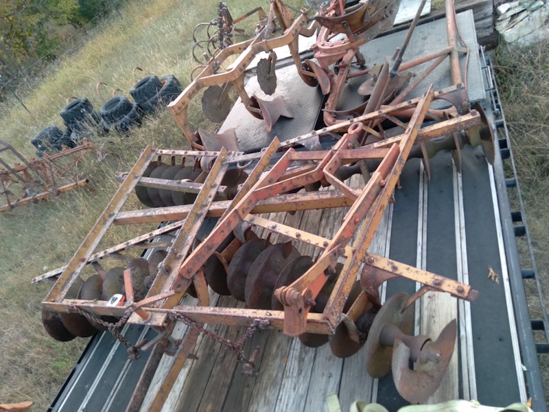

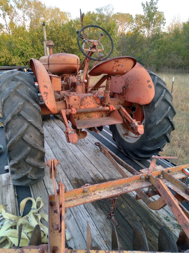

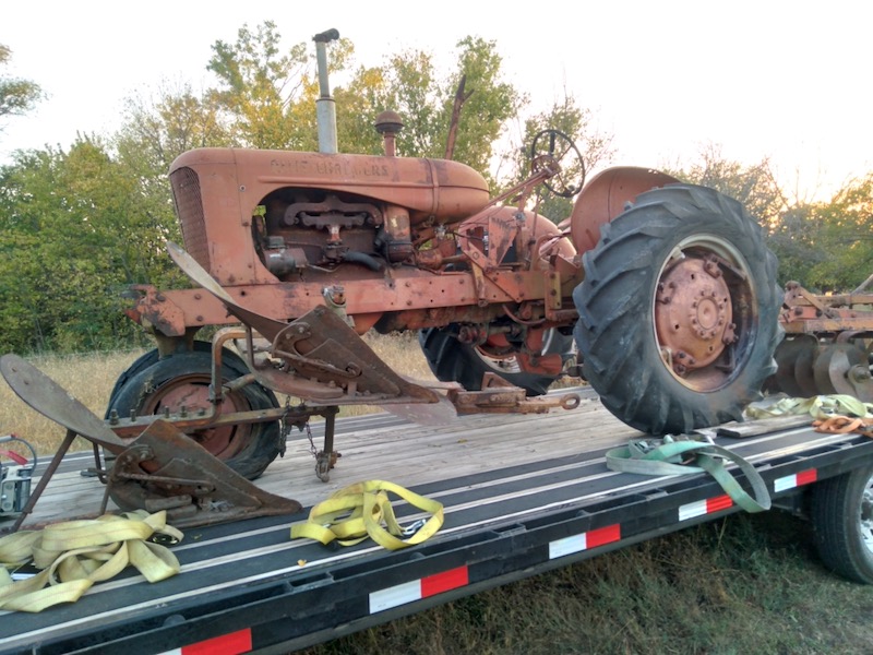

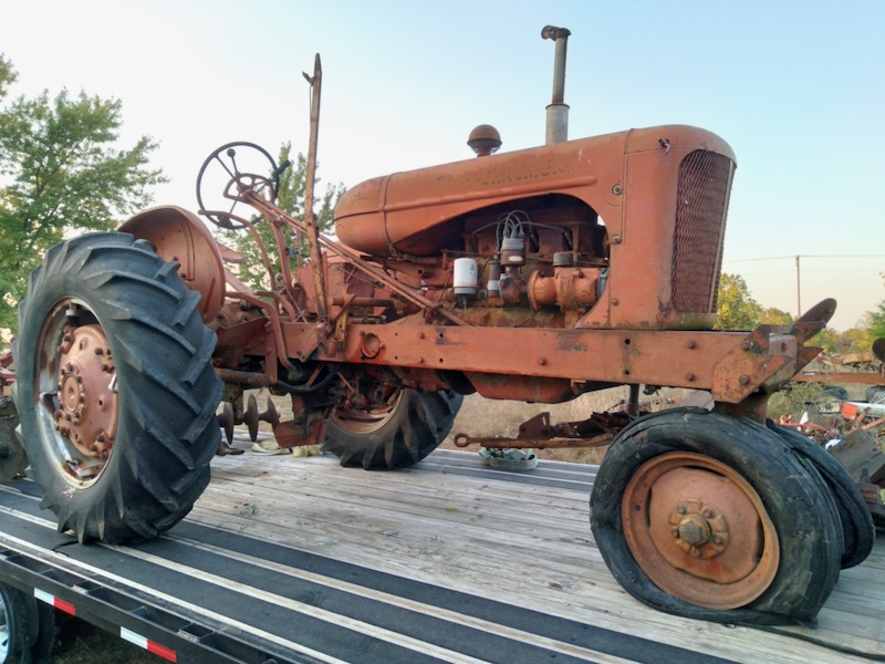

I'm going to have to stop dragging stuff home for a while after this one. I've been looking for a Snap Coupler disk and this one popped up 3 hours away, with a 1951 WD, a pile of parts, and 3 plows. The engine even turns over slowly with the starter so I may spend an afternoon messing around with it to see if it will run.
I believe the disk is an 8.5' 20 series. It needs new disks, a few scrapers, and probably bearings.

Nice score wjohn! It seems like when it rains, it pours. It's raining Allis on you, well, and some Farmalls too. I'm curious what the drawbar on top of the disc is for?

WOW, I can't believe the condition of the sheet metal !
Especially the tail end of the rear fenders.
No jams, no scratches, no cracks
That Tractor is a museum piece.
What is the Serial Number?

Good question. I have been poking around at pictures online. The two bars at the end have a slight downwards (or upwards?) curl at the end of the two points where it would have connected to whatever implement it was for. It doesn't look like any Snap Coupler disk, rake, rotary hoe, etc. that I am familiar with. It's closest to my field cultivator hitch but that doesn't have the curved pieces at the ends.

The tractor SN is WD92996. The engine is WD300982PA so it's only about 10000 engines into production with the tall head. Just before the camshaft thrust hardware changes.
It's been repainted before but does have very good fenders. The WD-45 I got last weekend had the usual destroyed back fender sections.

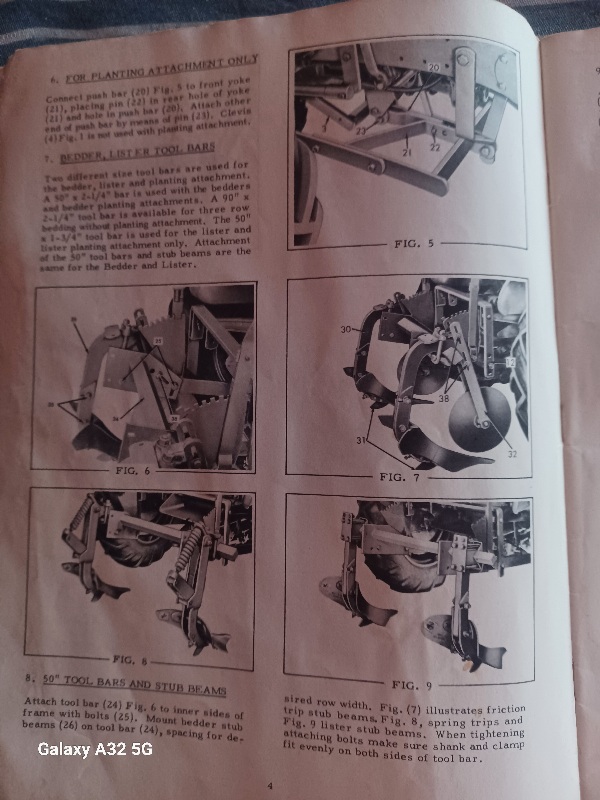

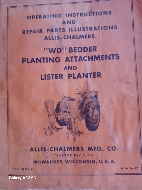

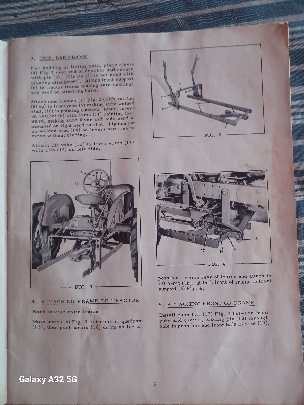

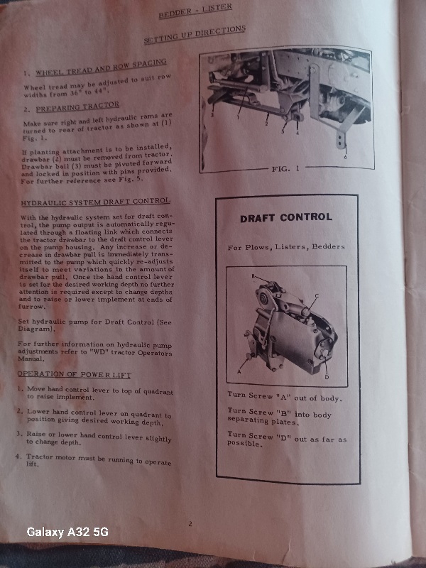

Here's some pictures

Thanks for posting those pictures. It's interesting that the front of the hitch is supposed to be up in front of the pin/snap coupler bell on the tractor. Someone put a snap coupler eye on the front of this. Too bad it didn't come with the depth adjust levers and the toolbar. That would be handy. Still, it's about 2x the size of the hitch weldment for the spring tooth field cultivator so it should be beefy.
Maybe even bale spear frame material?
