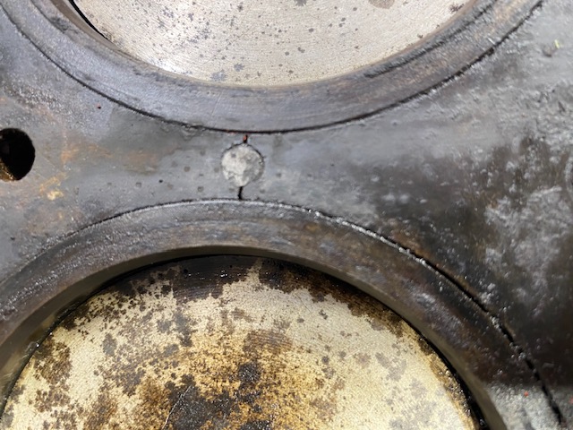

Low on compression last fall when I bought her. #2@65psi, #3@45psi. Front and back cylenders were around 115 and this tractor hadn’t run in years. Here’s what I found so far this morning.

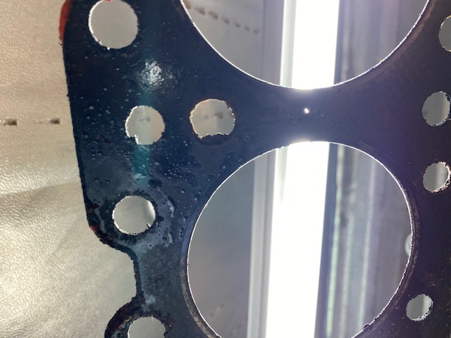

Someone drilled between 2&3 and installed a plug. The head gasket has a hole right above plug. What should I do next please? Thanks. Dana

Oh and when I preformed the leak down compression check those two cylinders bubbled in the radiator.

Post Options Post Options   Thanks (0) Thanks(0)   Quote steve(ill) Quote  Post ReplyReply Direct Link To This Post Posted: 11 Oct 2023 at 3:57pm
Normally your looking for a HAIR LINE crack that MIGHT catch your finger nail when you run across it.... a few thousands wide.. Thats about 10 TIMES that size.. I wonder if the crack was that big, or they pounded the plug in there and spread it...??
Most would say the block is toast...... About 15 years ago, Dick L had a post where he went thru the freeze plug on the side of the block and drilled thru the block on the opposite side, threaded it, installed a bolt all the way across and pulled it back to a hair line crack.. Left the bolt in permanently.... The gasket will seal a crack 5 thousandths wide.. not 1/16 - 1/8 of an inch.

Post Options Post Options   Thanks (0) Thanks(0)   Quote Tracy Martin TN Quote  Post ReplyReply Direct Link To This Post Posted: 11 Oct 2023 at 6:37pm
Heads gasket was leaking across fire rings.Make sure sleeves are protruding correctly. Probably just clean up block and head, new gasket should fix it. If you want you could put sealer in crack , let it cure before replacing head and gasket. JMHO, Tracy

Post Options Post Options   Thanks (0) Thanks(0)   Quote steve(ill) Quote  Post ReplyReply Direct Link To This Post Posted: 11 Oct 2023 at 7:04pm
He has a water leak into the combustion chamber also... Antifreeze is coming up thru the crack ( or combustion is actually going down the crack into the water jacket.

Post Options Post Options   Thanks (0) Thanks(0)   Quote AC720Man Quote  Post ReplyReply Direct Link To This Post Posted: 11 Oct 2023 at 7:57pm
The plug doesn’t make sense to me why it was placed. I know of folks drilling a hole to stop a crack but that is an extremely big plug to do that if that’s why it was done.

Post Options Post Options   Thanks (0) Thanks(0)   Quote jaybmiller Quote  Post ReplyReply Direct Link To This Post Posted: 12 Oct 2023 at 6:38am
curious... but would removing both sleeves be on the 'todo list' ???

Post Options Post Options   Thanks (0) Thanks(0)   Quote Gary Burnett Quote  Post ReplyReply Direct Link To This Post Posted: 13 Oct 2023 at 2:35pm
For only the cost of a head gasket I'd spread JB Weld over the crack and between the cylinders and bolt the head down tight while the JB is still pliable.Let it set for 2 days before cranking.
