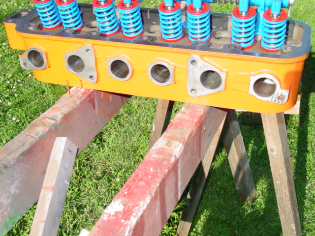

Post Options Post Options   Thanks (0) Thanks(0)   Quote Dick L Quote  Post ReplyReply Direct Link To This Post Posted: 04 Dec 2017 at 12:47pm
B, C, CA and RC Allis Chalmers made heads are all interchangeable. The only difference you will be able to see with your eyes are the numbers stamped in the push rod galley on those that do have numbers.
That is as long as I have not played with them. Then they look slightly different.
This one went on a B.
Edited by Dick L - 04 Dec 2017 at 12:49pm
