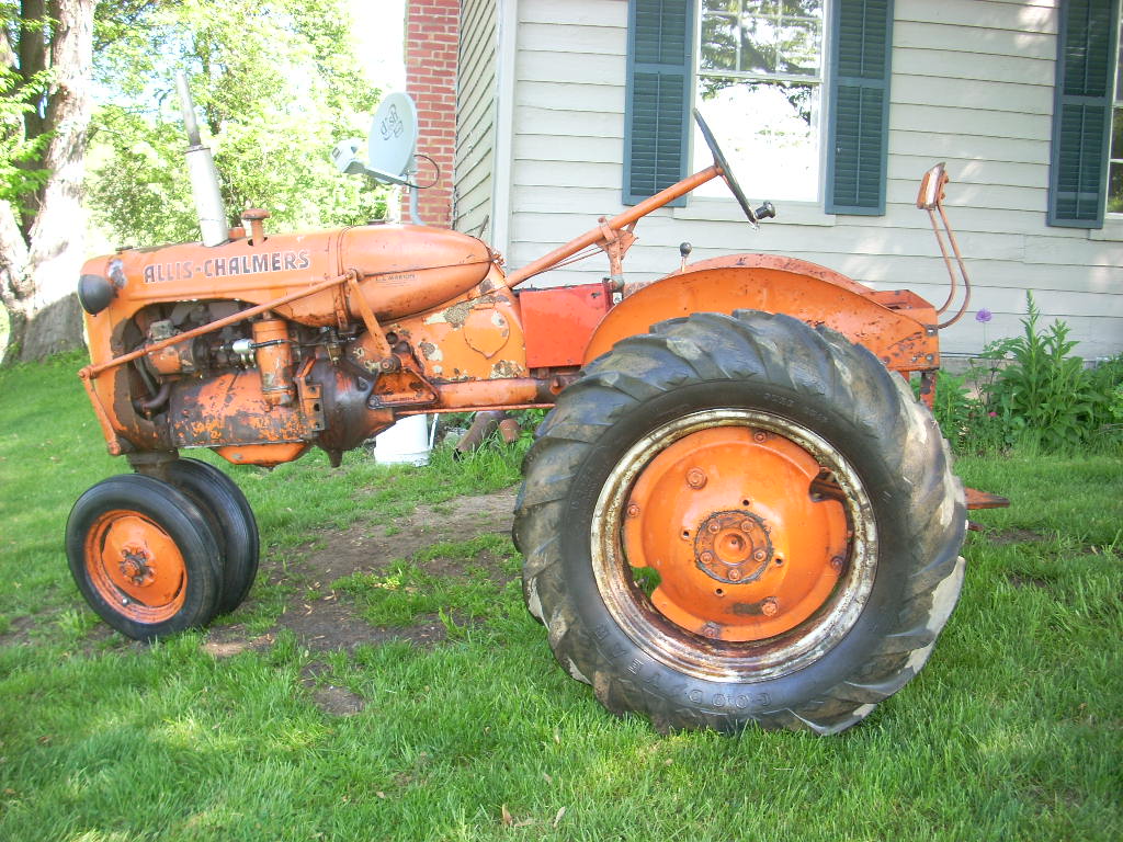

just took off the cultivators, changed all fluids and filter and gave her a primary bath. This is the last tractor I had to get ready for the year, besides still waiting on the head for the XT. Got to wondering if anyone has ever heard of a belly mounted bush hog type rotary mower? I haven't. If I got another Woods L306 like on my CA how would it hook to the C? My CA drive pulley is where the belt pulley used to be, is the C the same or does it drive from the smaller than standard PTO? I realize the CA has a hand clutch and the C does not so I'm wondering how the Woods is driven on a C which would need an over riding clutch I would think. Thanks, Dana

Everything will be the same on the C as on the CA except the hydraulic lift , if you have it. I have never needed an overrunning clutch on the woods mower. It doesn't have the inertia of a brush hog type mower and the brakes can very easily stop it. I had my Woods belly mower on the CA for many years and never had the hand clutch working. I have the same mower on my B now and get by fine even though the brakes are about usless..

Post Options Post Options   Thanks (0) Thanks(0)   Quote CTuckerNWIL Quote  Post ReplyReply Direct Link To This Post Posted: 20 May 2012 at 6:51pm
Cap'n, looks like you have both the swinging drawbar and the ASAE drawbar on that C.
