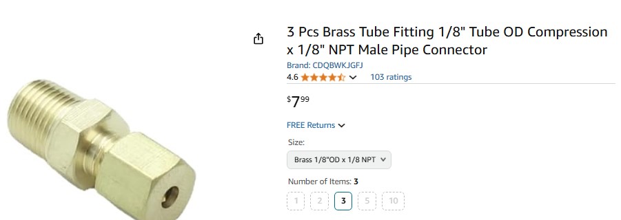

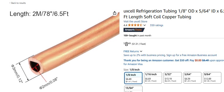

EDIT- while I'm here & thinking of it, what size compression nuts are the head/governor oil lines? Mine came without any of the original but I have some copper line that may be good, just need to confirm the thread sizes.

Post Options Post Options   Thanks (1) Thanks(1)   Quote steve(ill) Quote  Post ReplyReply Direct Link To This Post Posted: 17 Feb 2025 at 6:06pm
on the external oil lines... the line is .125 or 1/8 inch OD... The NUT is .375 or takes a 3/8 inch wrench  ........ the FITTING into the block appears to be a 1/8 inch pipe thread.
something like this...
Edited by steve(ill) - 17 Feb 2025 at 6:12pm

Brilliant thanks Steve. Will get the calipers on the line I have & see if it's correct (it's off an old refrigerator, looks to be about 1/8 or 3/32), else will just have to buy some as I don't like the pvc pipe solution I'm currently running.
Thank you.
Points: 90631
Post Options Post Options   Thanks (0) Thanks(0)   Quote steve(ill) Quote  Post ReplyReply Direct Link To This Post Posted: 18 Feb 2025 at 7:59am
YEP... hard to believe a tube that small is doing much good... but it only takes a  drip- drip to keep an oil film on everything... This is flexible refregeration tubing-- on Amazon.... i think it is actually METRIC... so it MAY BE a few thousands less than 1/8 inch

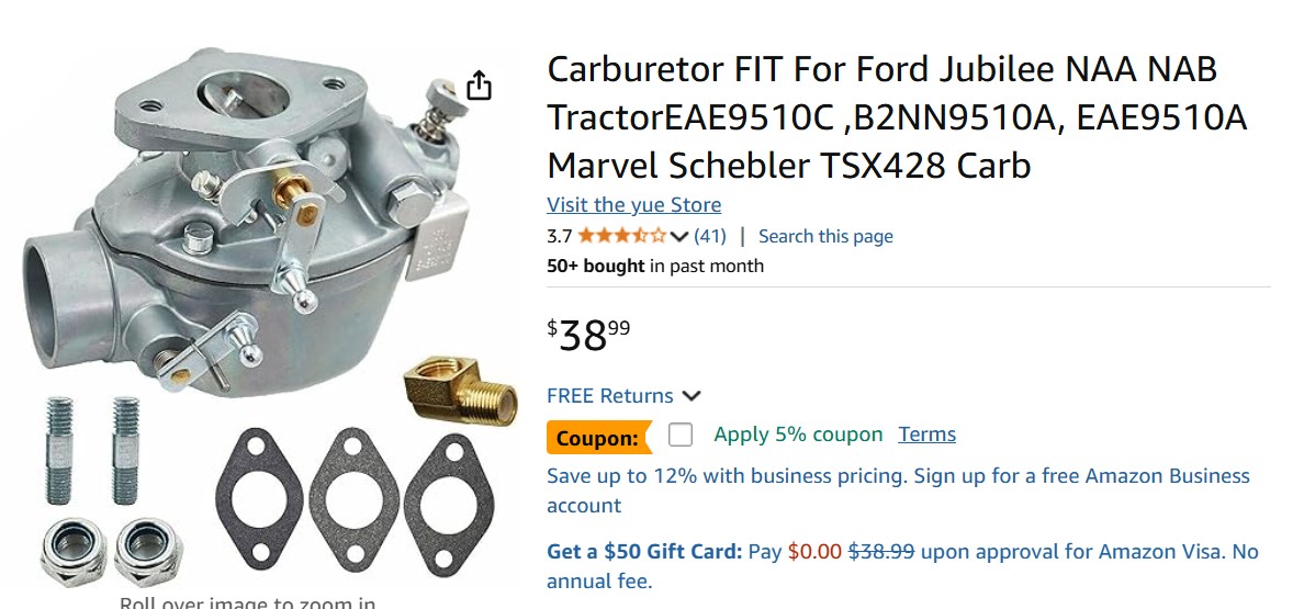

Now, should I go for a used correct carb & eat the shipping? Or dabble with one of the £70 Amazon 24T2 replicas (this was the alloy carb fitted to EB models & Ferguson TE20's too so should work fine, maybe even better than a worn original)

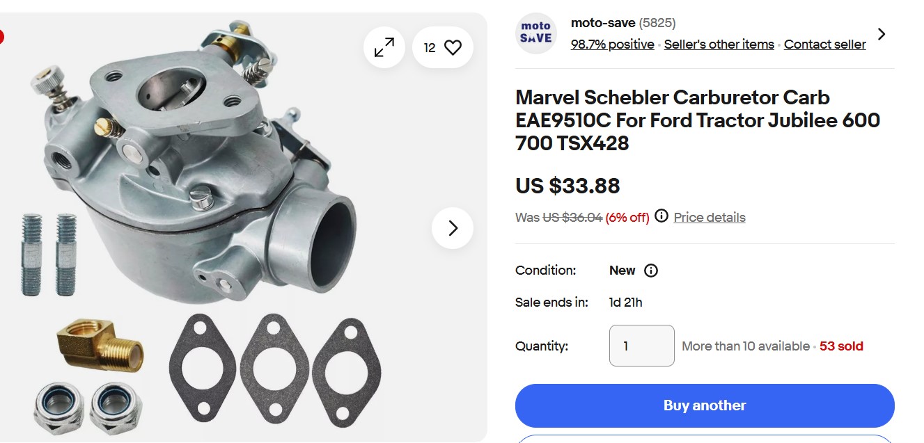

i bought one of these off e-bay 2 years ago.. Had to remove the ball socket and extend the arm on the throttle shaft.. Installed and it run about 75% good.... Had a miss at anything over 2/3 throttle .... Last year i took out the main jet and drilled it .003 inch oversize ( 10% more area) to increase the fuel flow and now it runs great.... These are china versions of the Marvel Schriber Carb and are CHEAP... dont seem to have that for the Zenith carbs......
I would guess you can get the same or similar on AMAZON.. I looked for a CARB that fit something around 125 cubic inches and tried to make sure the bolt pattern was the same ... figured i could modify the throttle arm and choke arm if needed.... A lot simplier than a B&S or auto carb..
Points: 90631
Post Options Post Options   Thanks (1) Thanks(1)   Quote steve(ill) Quote  Post ReplyReply Direct Link To This Post Posted: 06 May 2025 at 10:35am
Amazon today........  this is setup for a 138 cubic inch FORD... not the ball socket on the throttle and the arm is upside down.... remove, make new, and solder into place...make sure the arm and link  DO NOT TOUCH the engine block / drag.... remove ball on choke scrap , and connect arm to the hole in arm.
Edited by steve(ill) - 06 May 2025 at 10:38am

Nice Steve, I never thought of looking for the Marvel knock-offs I was hung up on the Zenith (partly in the vain hope the emulsion tube might fit the real carb).
That's a great option for if I strike out on getting the original sorted, don't like sending money to China but at least these are half the price of the other ones.
