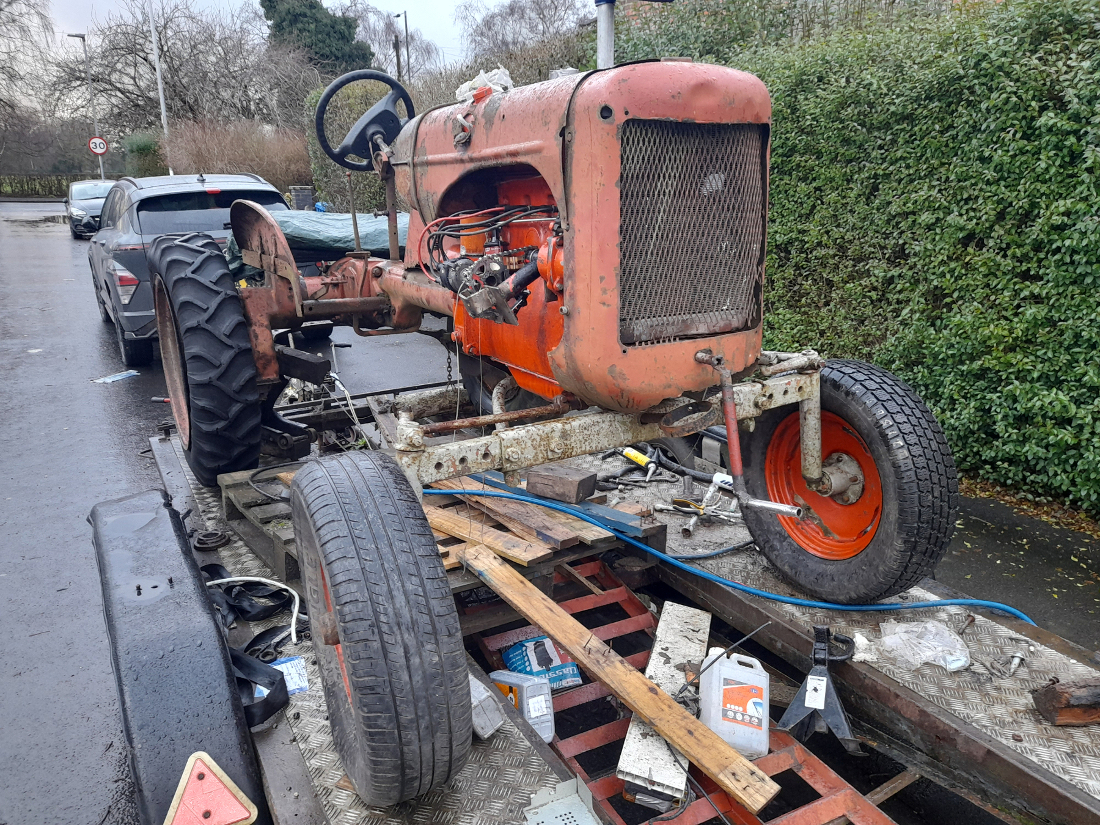

Hopefully some photos of the hackery & tractor as it now sits. Smile

Trying again lol I prefer welding and waylaying on stuff with hammers much more than computers! EDIT- Wahey we have pics at last! That was harder than it shoulda been!

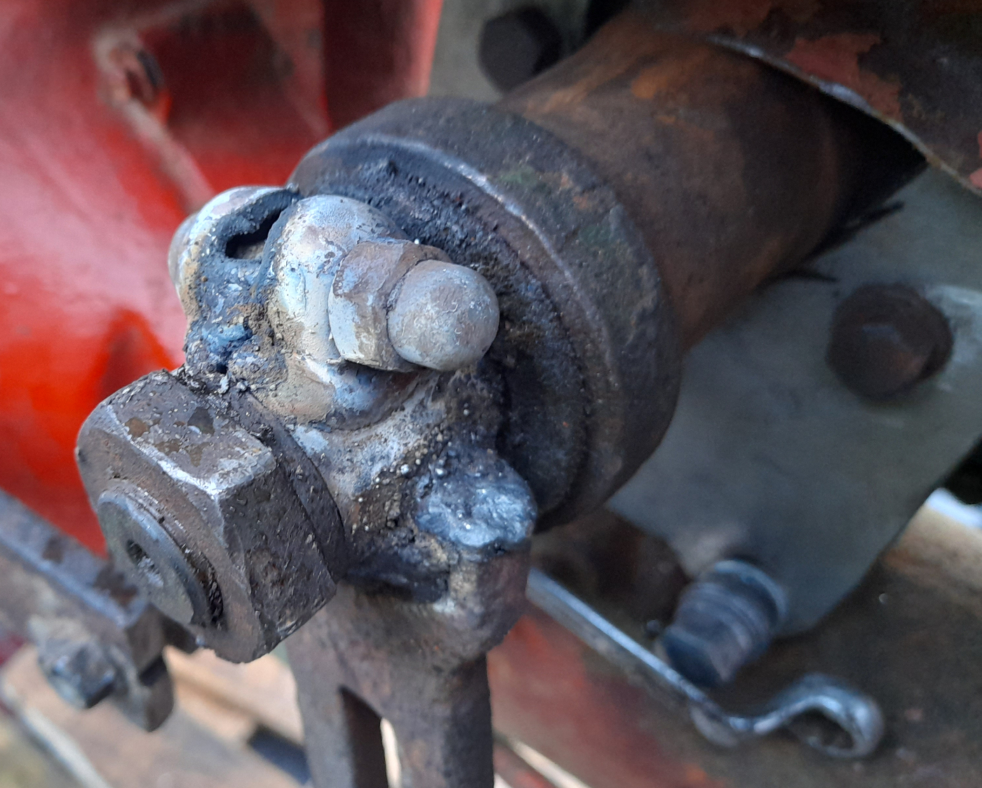

First up is the abortion that is the "spline" end of the drop arm (well, the bicycle seat clamp & 3 point link that identify as the drop arm!)

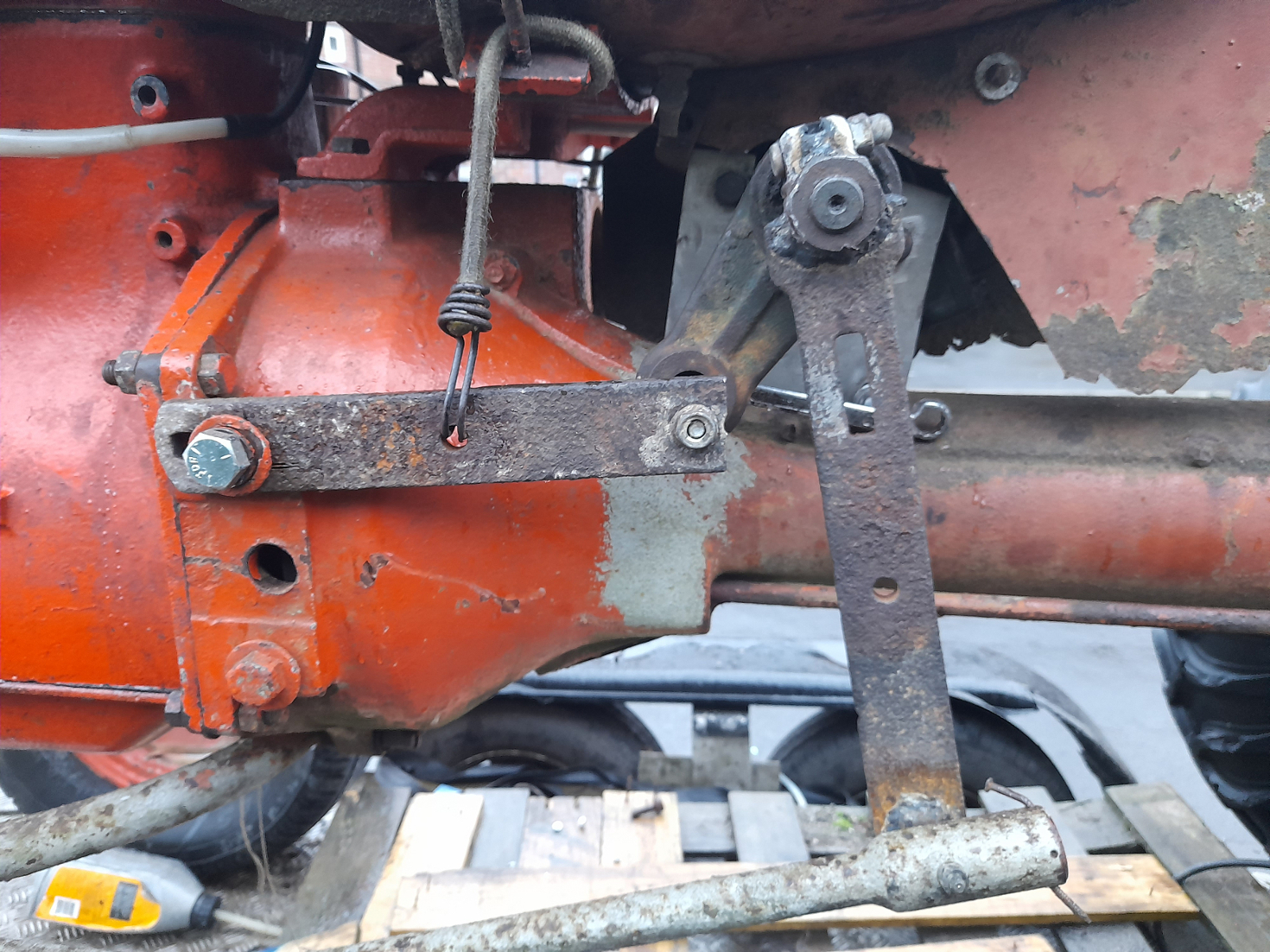

Then the steering gear bracketry & drop arm rig up as a whole...

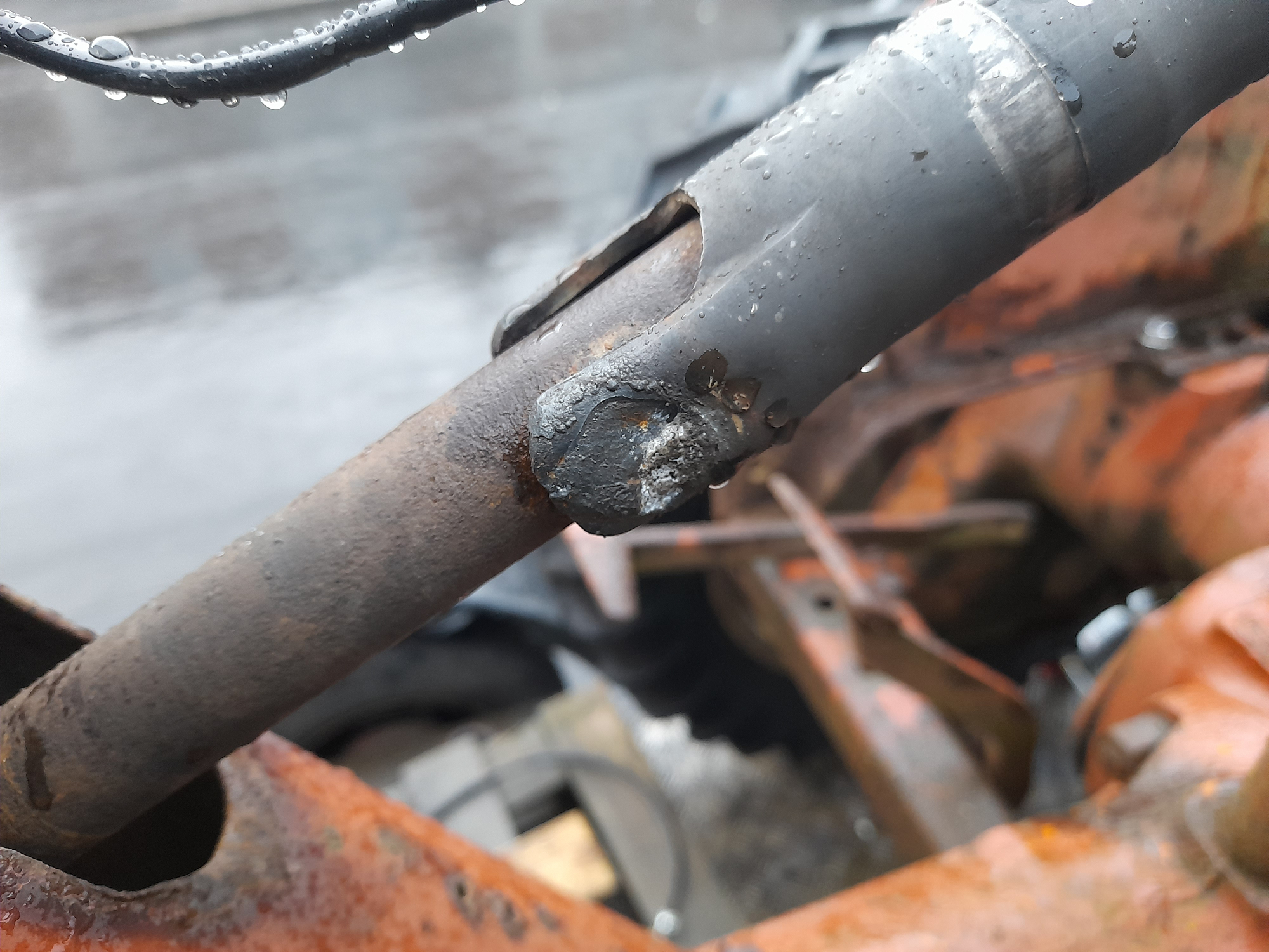

The marriage between 1940's Fordson & 1990's Citroen steering column...

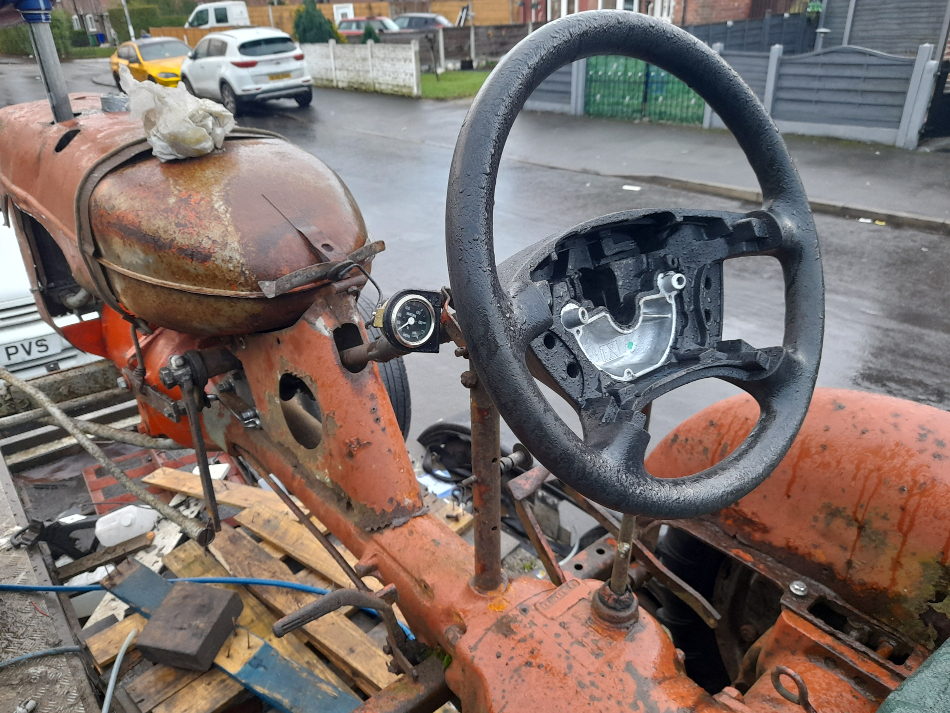

Kinda the view from the driving seat, didn't fancy a wet azz so I'm off to the side a bit!

Will the English ministry of recycled steering wheels allow you to use it without an airbag?Wink

Wouldn't surprise me if there is a Govt. agency for such. Not that any of our 30+ year old airbags would be likely to work anyway (We die like men, even the women...)
