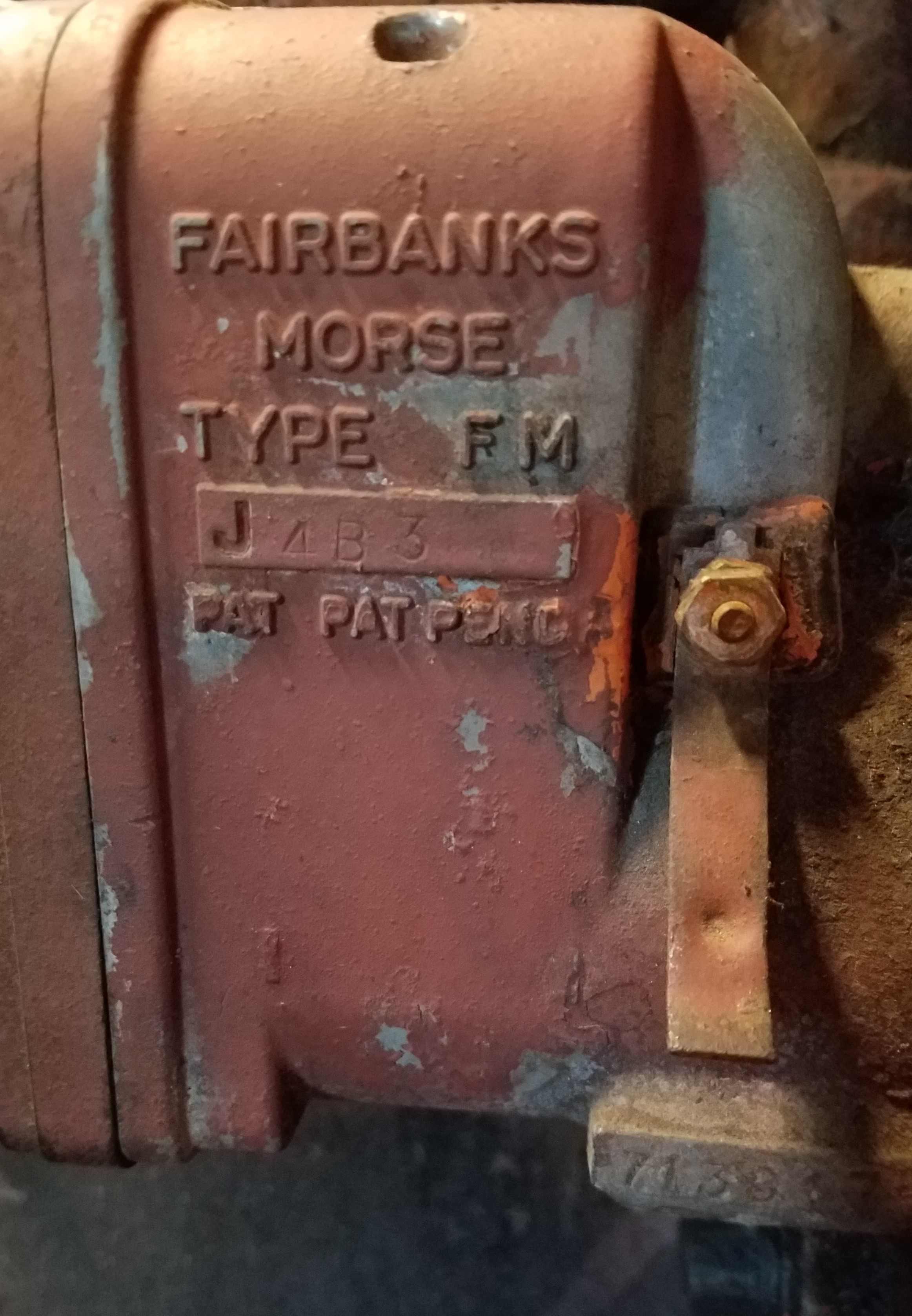

It's a distributor, but seems to be an earlier model than what all the manuals and other people show on their Model B's.
As far as the inspection hole, I can't seem to find it. If I understand, it should be on the left side of the torque tube, right around where the tube starts to taper down in size?

The picture you posted is a picture of a Magneto. If that's what's on your engine, you have a Magneto not a Distributor.  As Steve/IL mentioned, if it didn't fire on ether it either has a spark issue or timing is off.

Make sure the gears inside the mag are timed right, then make sure the mag is timed to the engine correctly.
