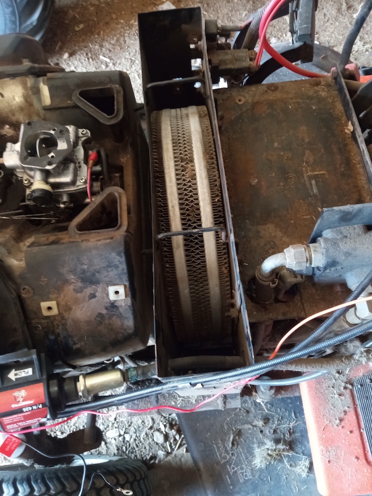

I am trying to replace the ignition coil on my 1920H. Can't seem to get the cover off the back of the engine. What do I need to do get to the coil? Any help would be appreciated. Thanks. rrhead(SD)

Remove the engine. Do not let the drive shaft come off the hydro or you will have a vibration!  Take the 4 bolts out of the hub on the engine.
