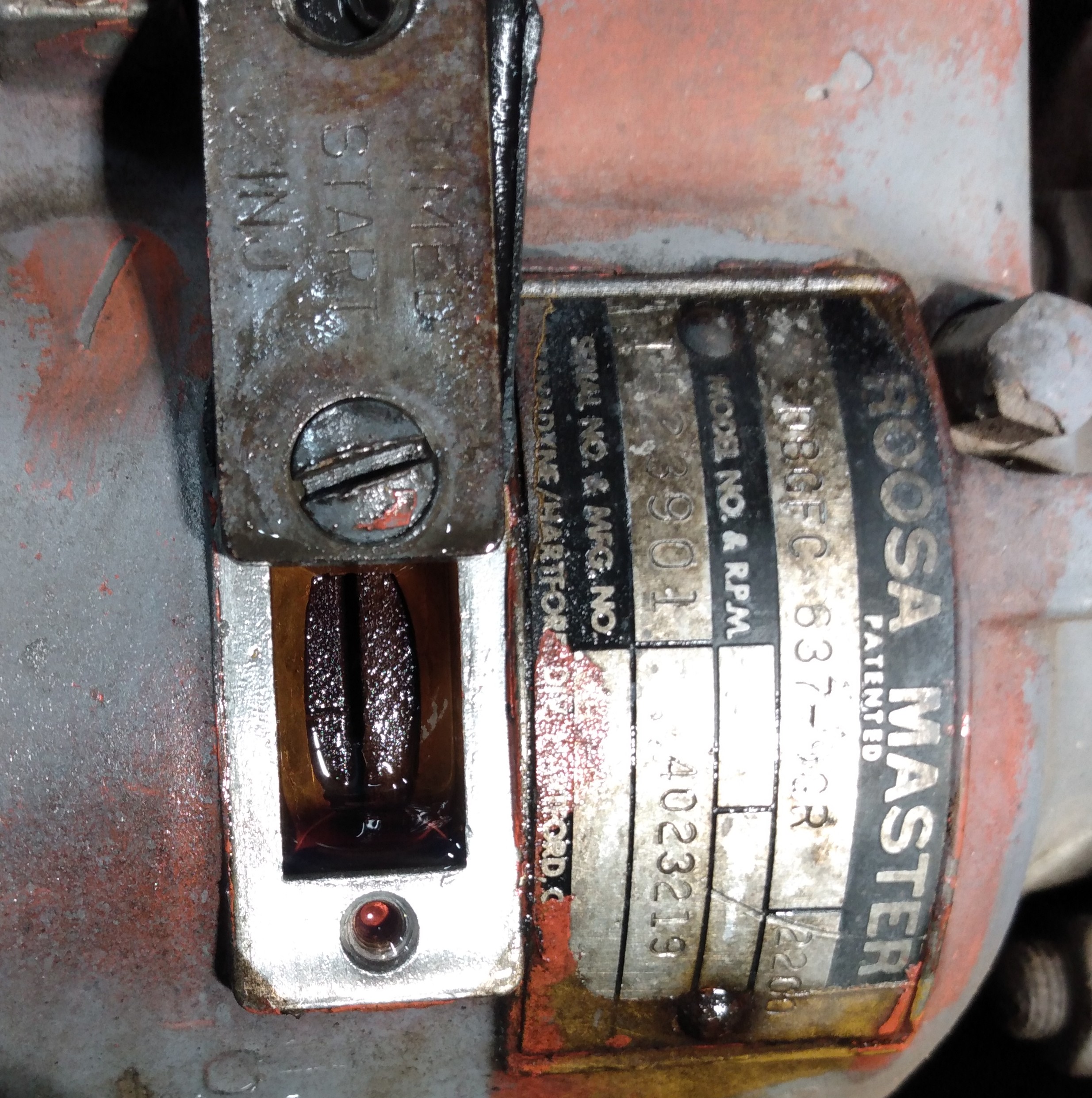

I have the number 1 cylinder at just before top dead. I looked at 16-26BTDC and still couldn't find my second mark through the window. I pulled the front inspection cover off and the gear and shaft out and rotated the pump drive key 360 with a screw driver about a dozen times trying to see the mark with the light at different angels still can't find it it's too gunk/rusted up. Is there any other way to remove the rust without a total pump tear down? Is it possible to tell if I'm at point of injection on number one if I remove the line bolt and use a flashlight and visually see it and time it to that?

Lynn Marshall View Drop Down
Location: Dana, Iowa
Points: 2434
Post Options Post Options   Thanks (0) Thanks(0)   Quote Lynn Marshall Quote  Post ReplyReply Direct Link To This Post Posted: 04 Mar 2023 at 7:08pm
Wow, that looks horrible inside. When was the last time it ran?

It will never run right looking like that inside. Keep forcing it to run with that nasty fuel it will end up seizing the head and rotor, and breaking the driveshaft. It get really expensive in a hurry! A lot of pumps I rebuild here look like that, so many sitting in collections don't run enough to use up the fuel and it ends up going sour so to speak. Tank, lines and filters will also need flushed with E85, as well as getting pump, primer, and injectors properly serviced.
