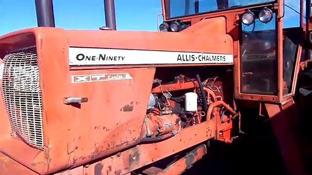

Had some time this morning so I cleaned up the fuel sediment bowl and fuel lines and got it fired up again. It lopes a little at low rpm, but pulls good...probably needs a fuel filter after seeing all the crap in the sediment bowl. Added 2 1/2 gallons of hydraulic fluid and the power director works fine now. Think I will wait awhile to decide whether or not to knock her in the head....

Eldon, that one is to good to knock her in the head... you need something like this one to knock it in the head... Oh yea, the head is in the cab...Must be a new style of design that don't make any emmissions... or noise.  LOL
