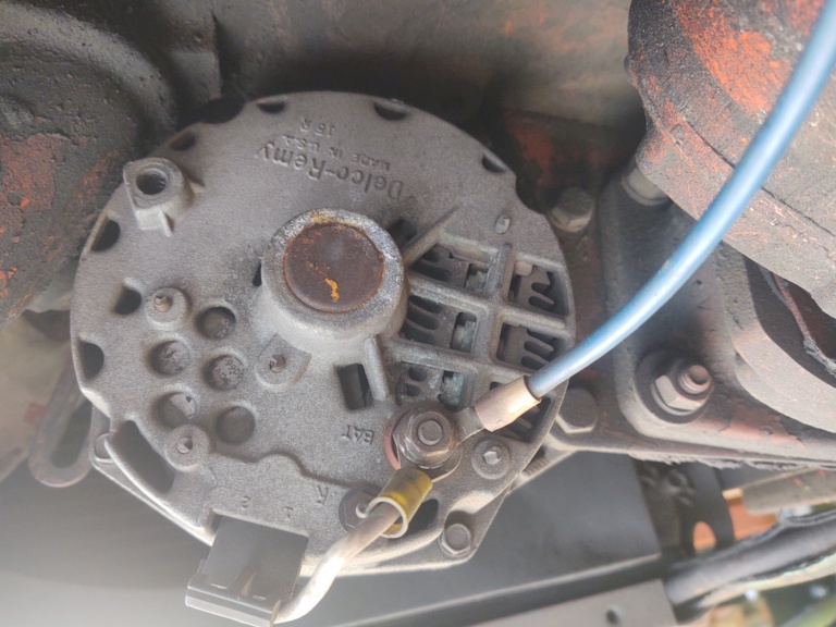

On the back side of the black plastic connector there appears to be a connector but no wire attached. I think it was there at one time. Is it possible that a second wire was attached? I can't see where a 3rd wire was ever attached. Can an alternator be useful as a 2 wire? I am going to look around and see if I can find a wire under the dash not attached to anything. By any chance would that missing wire go to the the dash voltmeter? It so happens I have a non Allis voltmeter gauge in the dash. It seems to be working too because once I turn on the key I see the voltmeter gauge go to 12 volts. I don't think I need 3 wire since it is merely lights only on the 190XT. I also tested the output with a voltmeter with the blue wire attached and it definitely is not putting out 13-14 volts. The blue wire goes to the voltage regulator and not directly to the battery. That blue wire is always live. I found Napa has these in stock locally for $76 with core exchange so am going to buy it from them. Hope get it this weekend and report back.
80 7010, 80 7020. 67 190XTD Series I w/500 Loader, AC 2000 Plow, AC 4 row Planter, AC 77G Rake, Member Indiana A-C Partners, Member TAC
steve(ill) ![]() Orange Level Access ![]() ![]() Joined: 11 Sep 2009 Location: illinois Points: 85821 |
Blue wire goes to the amp meter ( your Regulator is internal ) in your photo i thought the WHITE wire was attached to the PLUG.. But that does not make any sense.. If the PLUG is just covering the two spade terminals, then you have a standard ONE WIRE alternator.. A 3 wire alternator would be wired DIFFERENT inside and the two terminals would be #2 HOT and #1 SIGNAL from the dash light.. Someone could have removed the NOT USED wire... In the beginning ( 1970s) it was not a 1 wire system.
a three wire would look like this--- resistor or dash light in the #1 spade.. ![]() Edited by steve(ill) - 19 May 2023 at 8:53am |
If you do actually have an EXTERNAL voltage regulator, then that might be left over original equip.. Someone could have connected the BLUE wire to the BAT terminal of the regulator just as a terminal block attachment point... the OTHER wires on the regulator would be GONE or do nothing.

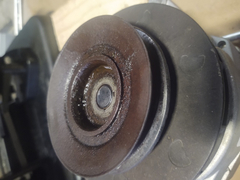

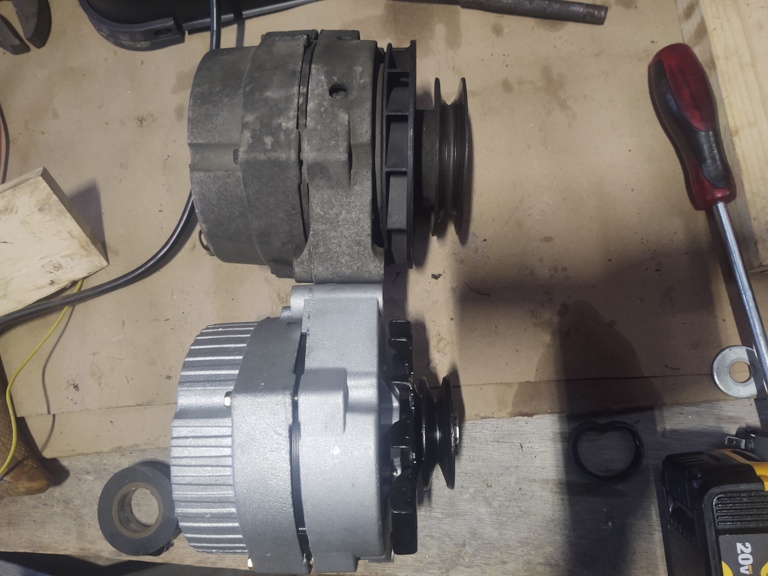

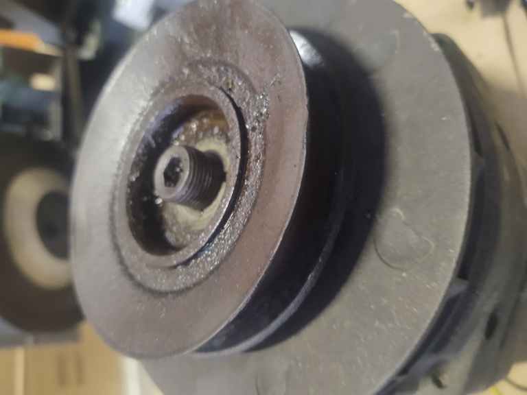

Like always, things aren't straight forward for me as they should be. I bought the 10Si and it is not exactly like my alternator. I pulled off the pulley so that the same belt could be used and there aren't enough threads on it to put the nut on. Here is the new alternator with old pulley. ![]() Here is what it looks like on old alternator with old pulley. ![]() If I tried to use the new alternator with the new pulley, the belt would be out of alignment since the shaft is shorter than the other one. This picture shows the difference. it is about 1/2 inch shorter. So, I guess I am going to have to get the old one rebuilt? I don't want to keep buying other alternators without knowing the shaft length, only to have the same problem. Anyone got any suggestions? ![]() |
calico190xt68 ![]() Orange Level ![]() ![]() Joined: 12 Jan 2017 Location: Frankton, IN Points: 850 |
I didn't see this post until just now. Since I have a 12SI and not a 10SI, that may explain the shaft mismatch. I will take this back. Before I have mine rebuilt, I need to look at your offering. What part number is the kit? I looked at your website and saw a bunch parts and not sure which one I need. |
I guess Steve is a lot better and telling a 12SI from a 10SI than i am !

CS130 is a great little alternator to take the place of an old generator, on a smaller tractor with limited space...... he has a 190 XT with plenty of room, and wants a Direct Replacement with no mods for the mount.
If he wanted to modify the mounting bolts with a few shims, the 10SI that he bought would work fine. Edited by steve(ill) - 20 May 2023 at 8:31am |

I have put all of these comments together and think I have figured it out. Here is a summary of what I think I have:
1) Original alternator was replaced. I have a 12si with higher output. 2)
They jumpered it and sent a wire to the key switch which I have found.
I think they were sending the output of the alternator to the voltage
gauge at one time. 3) This means they tried to make a
one wire into a 3 wire although 2 wires were missing. Some of the the
alternators can go either way. 4) The 10si is not a
replacement for what I have although you can shim it and get the v belt
straight. I didn't know how to do this but I do now. 5) I traced the wires and the ignition switch is setup to be a 3 wire alternator I think. 6)
I have an external voltage regulator under the dash on the angled plate
but I am not sure it is doing anything. 12si has an internal
regulator. I think the regulator was from the old alternator which I
think was as 10DN as it required an external regulator. 7) I may just go ahead and have my 12si rebuilt. I am sure it is not putting out any volts. 8) 12si outputs 100Amps versus 63 amps for the 10si. 9)
You can tell a 10si from a 12SI because it has a different fan blade.
The "solid" blade produces more cooling. The 12 SI needs more cooling
since it has higher output. 10) I may still replace wiring after rebuilding the 12si. 11)
Not sure what the jumper white wire is that I have because it is
attached to wire 2 and it should be attached to wire 1. It must be used
as an exciter to get the alternator to charge up but not sure. It
seems wrong or missing another wire. 12) If I want proper alignment of the Alternator/Fan belt I may need to apply shims to make the pulley get aligned. I think the current alternator is slightly out of alignment but not that bad. So, I am going to get Alternator rebuilt and go from there. Thanks to everyone for the help figuring out this setup. Tough when it gets changed into something that is not in the parts book. Let me know if I have anything wrong above or should go in a different direction. Here is the voltage gauge that I have and it works although the alternator wire is not properly attached. Is this gauge a 190Xt gauge or from something else? Seems I didn't see this in the parts book. It says Allis Chalmers on it. That non-standard switch and led lights in the middle is a turn signal switch and signal indicators that I installed in case you are wondering. The oil gauge is connected to nothing so I think it was going to be a future improvement that never got done. ![]() |

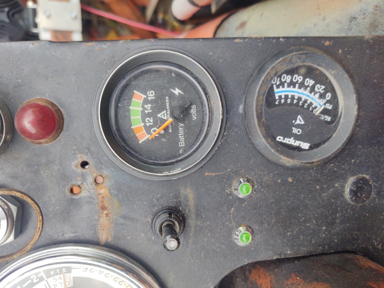

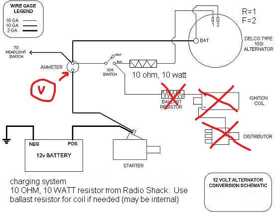

Since I have a diesel, I don't have the ignition coil, distributor or ballast resistor to worry about. It seems that I don't need the external voltage regulator installed below my dash. Can I remove it? I also don't have an ammeter but rather a voltmeter in my dash and I assume I can use it rather than an Ammeter? Here is a 10W/10Ohm resistor that I am going to use. ![]() I am not sure about sending the wire to the headlight switch from the Voltmeter? Is that what I want to do? I haven't tracked my ignition key wires yet but do I need to do anything different there? So, here is what I think I need to do to wire for a 3 wire alternator setup once I get my alternator fixed. Thanks for the help. ![]() |
YEP... and a VOLT METER jus measures voltage OUT of the switch to GROUND... not INLINE like an amp meter ............. maybe something like this....and you can put your head light switch wire on one of the ignition switch wires.. if you put it on the LEFT side, you can have the head lights on with the ignition switch off... if you put it on the RIGHT side, then the ignitions switch kills the power to the head lights switch.
![]() Edited by steve(ill) - 22 May 2023 at 4:16pm |
First, I really appreciate these diagrams you make. It makes it clear. I now know ammeter measures flow (amps) of electricity whereas voltmeter measures the storage (??) of electricity (volts). Be great to have both gauges but not sure I have dash space. My oil Guage doesn't work but maybe some day. I need to get the fuel Gauge working after this. I hope to start on rewiring all this over the weekend so I will report back.
Edited by calico190xt68 - 22 May 2023 at 8:31pm |
