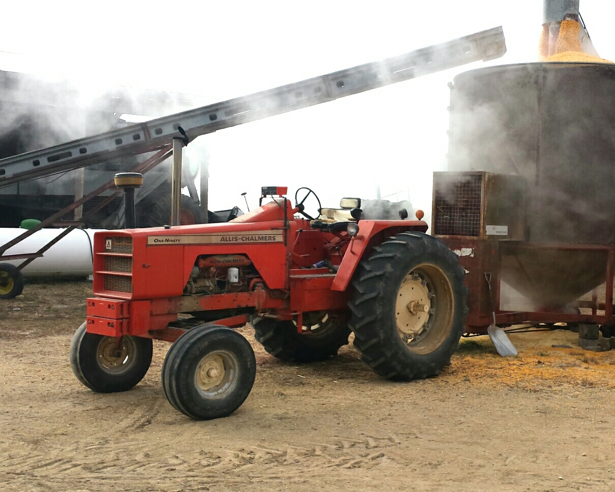

Hey Grinder220, do you still run that dryer or is this an old picture?  What size is it?

Post Options Post Options   Thanks (0) Thanks(0)   Quote grinder220 Quote  Post ReplyReply Direct Link To This Post Posted: 04 Jan 2018 at 7:15am
This is the first year for it on the dryer. Its plumbed just as it was on the 7020. Only work it does on a 90 degree day is hay work. Some spring tillage and planting is about all I use it for anymore .

Post Options Post Options   Thanks (0) Thanks(0)   Quote grinder220 Quote  Post ReplyReply Direct Link To This Post Posted: 04 Jan 2018 at 7:16am
500 bushel and thats from this past fall. Usually have a G705 moline running it.
Yeah, I thought it looked fatter than mine.  Mine is 350 Bu.  I'm just glad I'm not the only one still using something like that, lol!
yeah I'm one of the few left running one around here.
