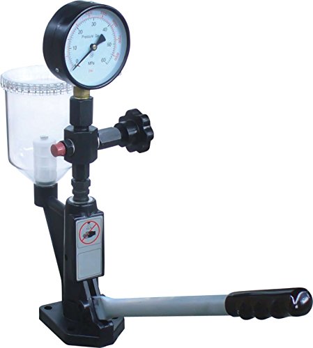

I'm needing to know what type of thread the injectors are on a 190xt Diesel.  Looking at buying a injector nozzle pop pressure tester to make sure my injectors are firing properly.  This tester only has adapters for thread Type A and B according to the specs and before I buy want to make sure the adapters will fit.  Any help is appreciated or if someone already is using a particular brand let me know.  Not wanting to spend a ton of money on a tester.  Thanks
Below is the link to what I'm looking at.

Threads are 9/16" X 18 or NF, but connection is Ermeto deep bowl design.

Thanks for the info, it looks like the one I'm looking at doesn't have the correct threads.

That one does not. It has 12mm and 14mm.

WIN.MAX Diesel Injector Nozzle Pop Pressure Tester Dual Read Bar/PSI Gauge S60H W/Filter
by WIN.MAX
Currently unavailable.
We don't know when or if this item will be back in stock.
  • The items you ordered will be shipped out in 1-2 business day from CA,USA. And you will receive it in one week.
  • initiatve injecting press of injector
  • sound of needle valve vibration
  • Brass Bourdon tube Pressure gauge - 100 mm Dial, 3/8 " BSP thread Dual Scale Gauge Range:0 - 60 Mpa & 0 - 8000 PSI (See image 2 Above)
  • High pressure pipes 'A' and 'B' type with m.m. size nuts (12 X 1.5) and (14 X 1.5) for connections
